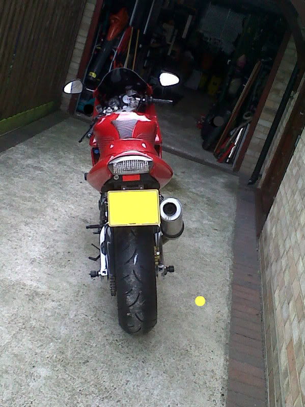

Update, took delivery of the 2 into 1 exhaust system yesterday, fitted it, sounds absolutly mental Gona have to get the jetting set up as no doubt it will run like an absolute pig.

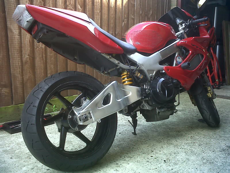

Well i have finished it ...well for now!
Just got to get the suspension sorted as the rear is rock hard, but from the little ride i had today, its running ok, no immediate signes of reduced power due to the 2 into 1 exhaust, roll on the summer

Could I ask a question here?? Apart form aesthetics, what advantage do you have fitting this swing arm as opposed to buying a Ohlins shock for the standard set up and tuning the suspension??
Old Dec 4, 2011 | 12:52 PM
  #42
bigspanishmarty's Avatar
Joined: Apr 2011
Posts: 24
bigspanishmarty is on a distinguished road
because it looks so much nicer.......
Old Dec 4, 2011 | 01:40 PM
  #43
Well, since I was the one doing it initially I'll but in... I personally wanted a tad longer swingarm and higher rear, which this easily produces... It moves the weight forward, less wheelie prone bike, more stable through corners... Combined with a sorted fork, the much stiffer rear, and altered geometry makes the bike corner like it's on rails...
You can get similar results from a braced stock swingarm and sorted damper... But that's about the same amount of work, all parts of it together...
