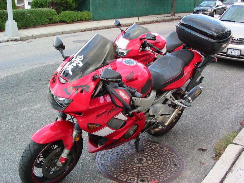

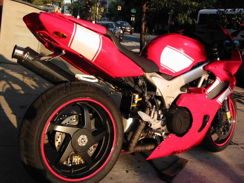

You can paint them red (krylon fusion plastic paint) or get f4i red ones. The bike with the givi case has the smaller f4i red ones and has been crashed twice on them & still wears original unfixed bodywork
Attached Thumbnails Pics - TRex frame sliders mounted - yuck-sss-8.27.10-003.jpg   Pics - TRex frame sliders mounted - yuck-dblvtr10.11-006.jpg
