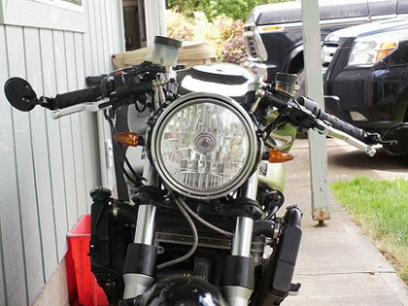

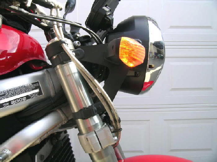

Try "headlight mounting bracket" under all motorcycle parts. If you're looking under vtr or superhawk obviously it won't yield too many results. I picked up an entire assembly from a sv650 (bikini fairing, brackets and functioning headlight) for a little more than $120. There are brackets from a number of bikes that will work (41 mm fork tubes) so doing some research and knowing the fork diameter of other bikes will help tremendously.
Honda CB175,CB350,CR450 AND CR750 Cafe Racer Website
this website has a comprehensive list of fork tube diameter under the tech tips section.
And as mentioned before there are a number of company's that offer kits but the prices are usually a little steeper than what you'll find if you piece it together yourself through a variety of different bikes.

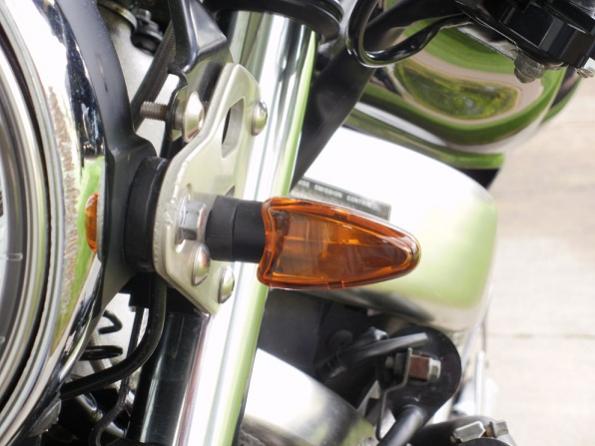

Edit: The bracket for the sv650 did require some modification. It was approx 1/4" too long to fit between upper and lower triple. I chopped out slightly more and welded back together. Blinkers are a $14 set from local bike shop bolted through existing hole in bracket, all extra wiring is stuffed into headlight bracket.

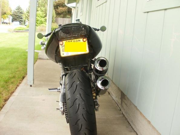

First pic is headlight assy without fairing (painting it), second shows weld..not pretty but not easily seen and perfectly functional. Third is the cheap blinkers and the fourth is because I can't resist showing pics of my exhaust.

Cool looking exhaust, Poppazuti. I can only imagine the effort that went into it. The last factory bike I saw with something like that was the T-Bird Sport, and I loved that bike almost exclusively for the exhaust.
Thing about a lot of the OEM ears you’ll find is they’re faux and bolt up to the triple tree and not the fork legs, so they’re not really universal. I thought that was the case with the SV, to be honest. They look pretty sharp.

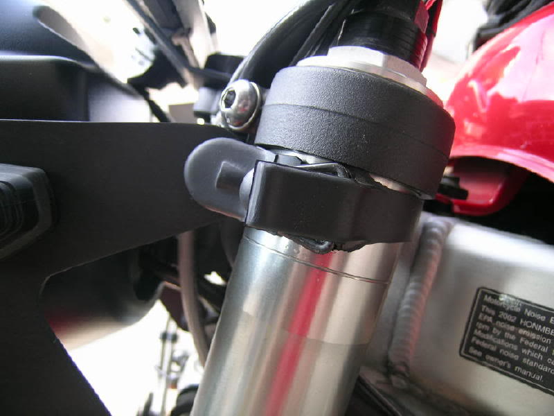

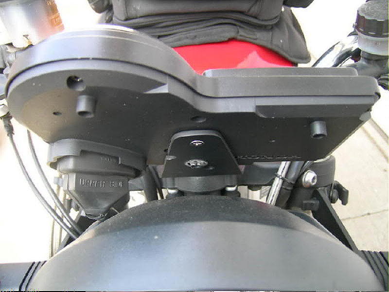

May I suggest headlight mounts made from ABS and XR number plate mounts ?
Take a look at my thread "Facelift"
Here is a pic of the headlight mount and the mount for the 929 gauges
