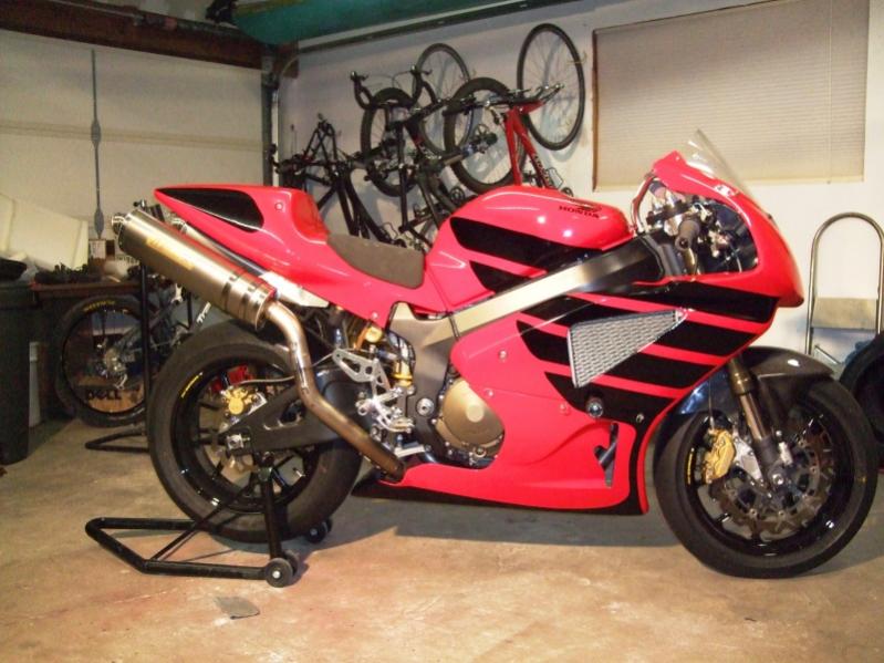

Originally Posted by mdbuehler
Lol, I'm way too slow at this to make any money at it
Tinged only by the fact I forgot about the chin spoiler completely and will have to paint it this weekend, I proudly present me "RCV Hawk" as it were, ta daaaaaa! :
Turned out really well, with only a few small runs in the clear and some random crap that blew in from the outside. You have to look to find the problems, so I'm very happy with the result!
Black frame really works on this bike, and the dark radiators made a big difference too. Once its all cured solid and I've been able to polish it up a bit I'll give her a proper photo shoot!
Nice work.
You have a twin !
