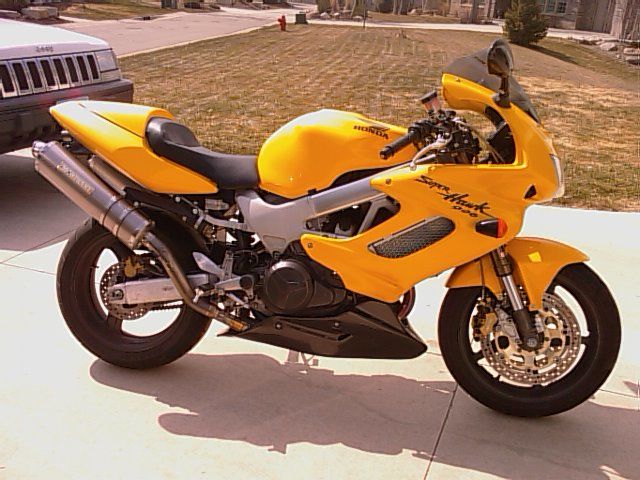

From: MN
moriwaki belly pan - and question trimming CF
ordered this a looooong time ago. finally came. install easy enough but need to trim some for the pipe - just have to enlarge the hole a bit. What is the best way to trim Carbon Fiber?
Attached Thumbnails moriwaki belly pan - and question trimming CF-moriwakipan.jpg

I need to enlarge a hole that about 2-3 inches long by about 1/2 and inch
