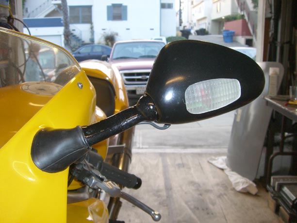

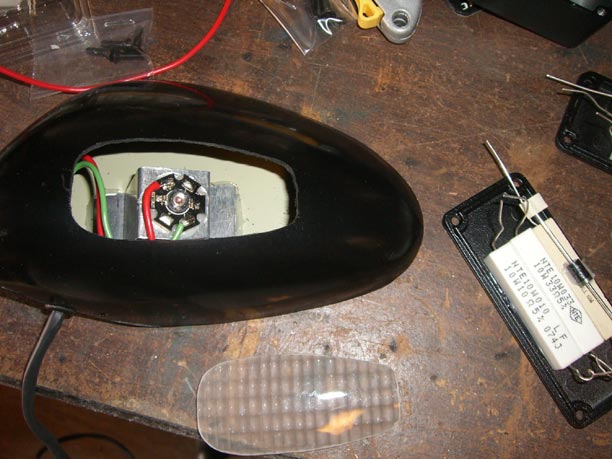

Guess it was last weekend I made the mistake of unscrewing the mirror from it's post. turns out there is a spring, three cups and a nut that start rattling around once you do that. No hope of lining things up to re-attach. So knowing that I'd have to cut open the mirror (or buy a new one) I thought I'd try installing a turn signal and remove the one from the fairing. Here's where I am at this point. I made a bracket to mount the LED and epoxied it into the mirror housing. Then wired the LED and installed that. There is an existing hole in the mirror that I drilled out for the 2 wires and added a grommet. The lens was a generic one from Pep Boys that I cut up then hit with a heatgun to get it to contour to the mirror front (before I cut the hole). I need to finish making the box for the resistors so it will be both running and turn signals. Oh, I also made the mirror post 1 inch longer.

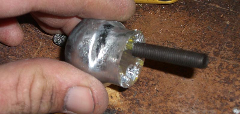

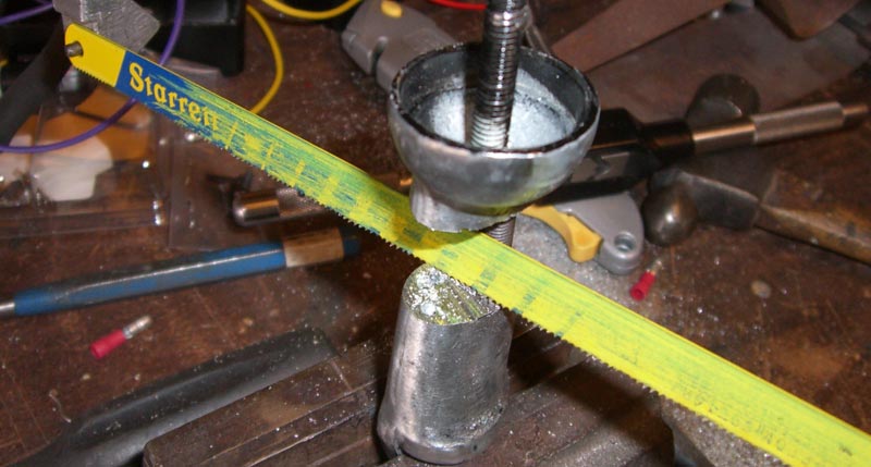

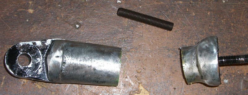

Here's how I did the extensions. Started by cutting the stalk. If I had to do it again, I'd cut closer to the middle. There is a bolt head imbedded in the pot metal for the mirror to screw onto. It makes drilling straight a bit of a challenge. My thought was to make the extension in the narrow part.
Here the stud is threaded into the small end, you can see the head of the bolt here. I offset my hole to try to avoid it.
I roughed up the ends of the stalk so the epoxy would get a good bite and hold better.

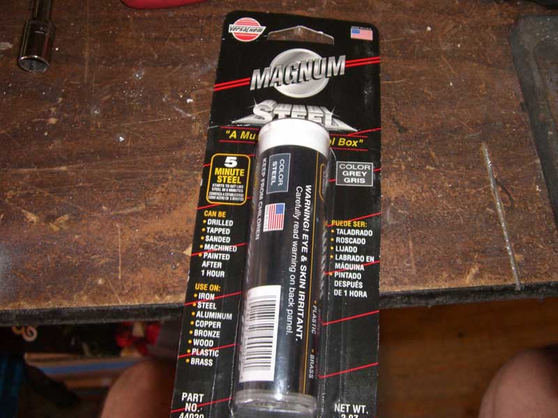

Here is the epoxy I used. Hardens fast, sands well.

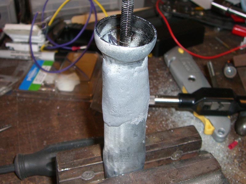

Here the epoxy is mashed in, then feathered a little. I tried to have extra material all around for sanding.

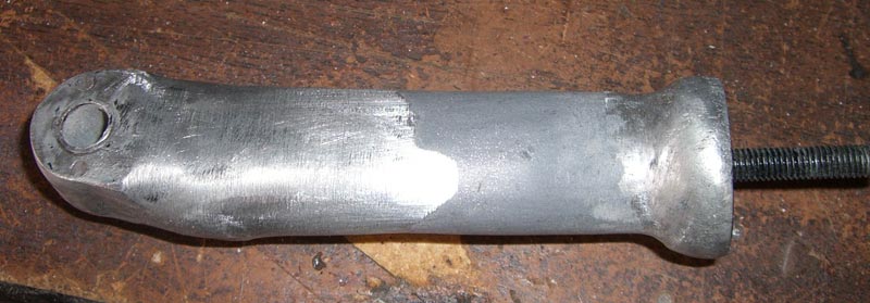

And here it is sanded.
