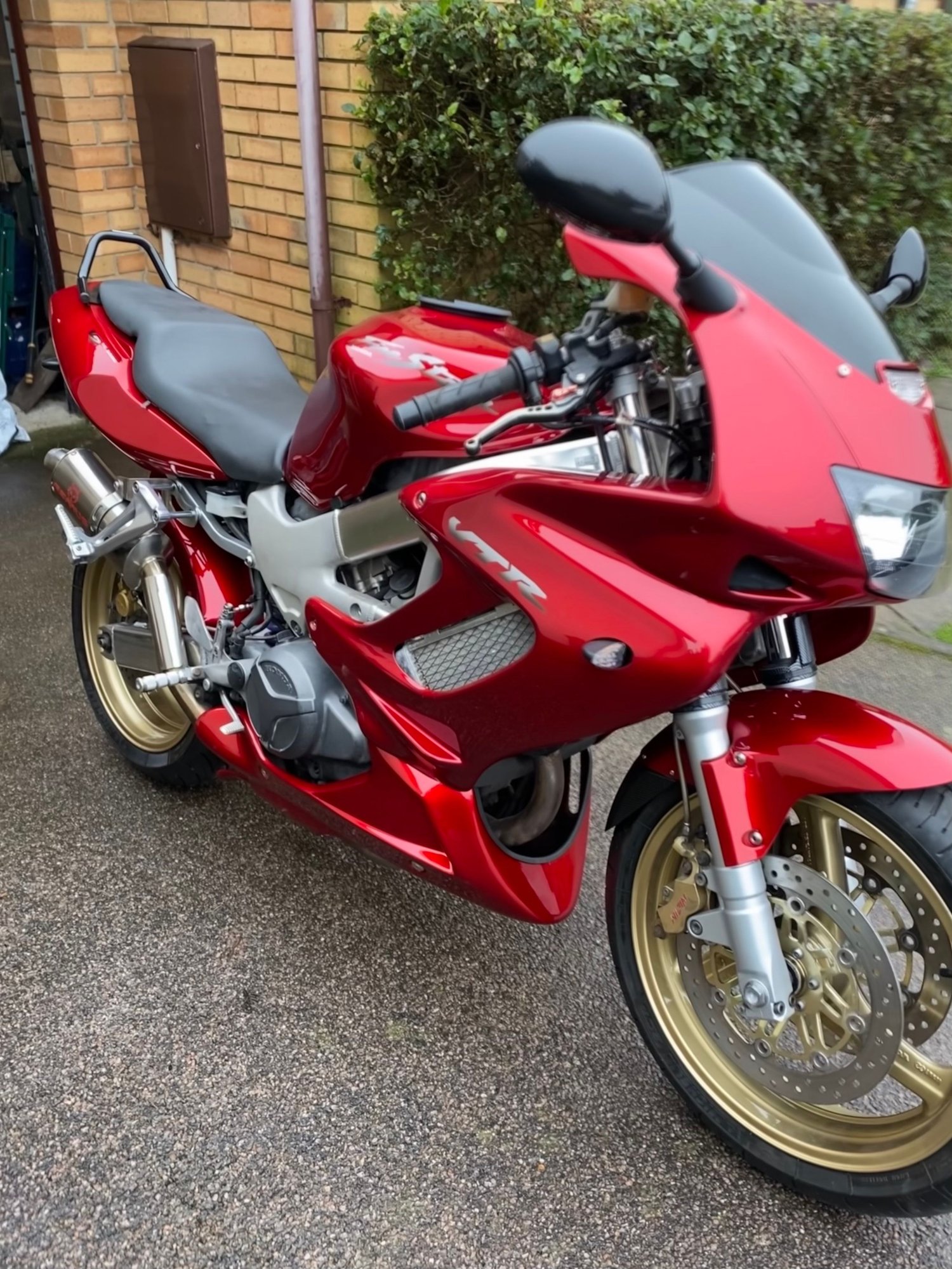

I have high mount exhausts on my bike, the foot pegs had to be fitted with spacers and a custom bracket for the pipes.

can some one please tell me how big the spacers are i bought high rise pipes but have no spacers

It depends on the size and shape of the cans, mine are oval and the footrest sits over the can which required 85mm spacers.

Depends on the brand as different brands will obviously fit a bit different. The surest way is to simply hold up your passenger pegs near the muffler and measure the distance to the subframe. The bolts are available online. The spacers may require a little more creativity. Jardines used a 1.5" spacer and the socket bolts were M8 x 1.25 -70mm. Another set (not sure the brand off the top of my head, maybe LeoVince or Devil) are a 2 3/8" spacer with a 100mm bolt. I've also used 90mm bolts for others.

thanks for the info ill just have to cut some spacers on the lathe
