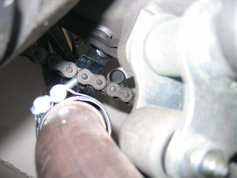

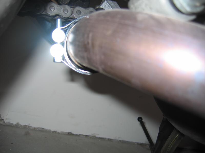

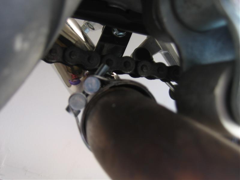

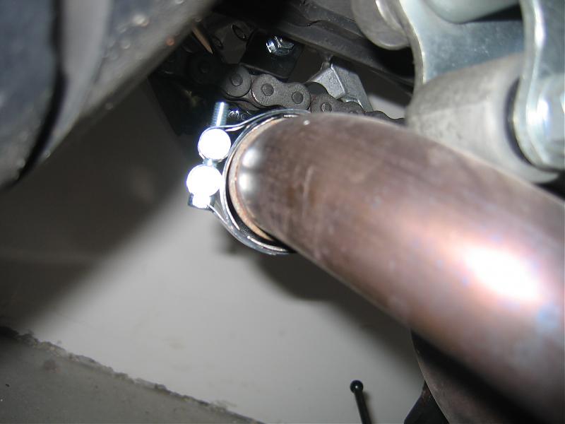

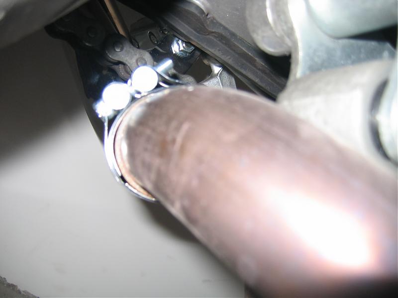

The low mount pipes I believe are too big, even with clamp tighten all the way down the pipe still can move. There is a gap in the clamp area if you look closely (enlarge the pic). Is this normal for slip ons? Or Two Bros low mount pipes defective? As you can see I changed the position of the clamps twice and it did not help. Open for comments or suggestions.:confuse d:

I believe you are missing the exhaust gaskets. It would be best to buy new parts from the dealer...Hawkrider can produce the correct part number for the BEST fitting gaskets. OR you can remove the gaskets from the old mufflers (carefully) and then reuse them on the new pipes. If you go with the recycle method, the fit will not be as good and you will most likely have small leaks.

I went to the Honda Motorcycle Dealer today and the mechanic said that the OE gasket would not work b/c it only comes up to the ring on the pipe. Look at the pictures and you will see the ring/bump on the pipe. The slip on pipes are bigger than the original standard. Is this normal to have a gap even with the clamp tighten all the way down. Open for more suggestions.

Somebody gave you the wrong clamps. Go to a hardware store and buy slightly smaller ones. Don't know why, but my V & H pipes came with the wrong ones too.

So you believe that the clamps are the problem. I will get different clamp but these are the clamps from Two Bros. What if the diameter of the pipes are too big or is this common with all slip ons. Look at the pictures the teeth on the pipe is not closing/getting closer when the clamp is tightening.

The Honda exhaust spacers are missing. This can be especially problematic because the lower one is within centimeters of your rear tire. These are cheap and gotta be there. There just like the old fashion exhaust donuts between the manifold and the header. These are a little different shape but they do the same thing.
