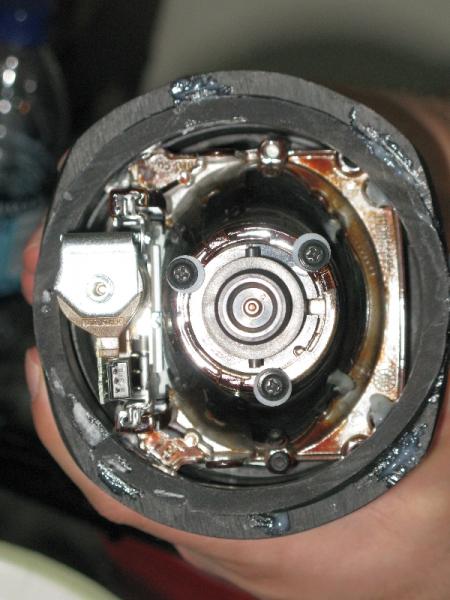

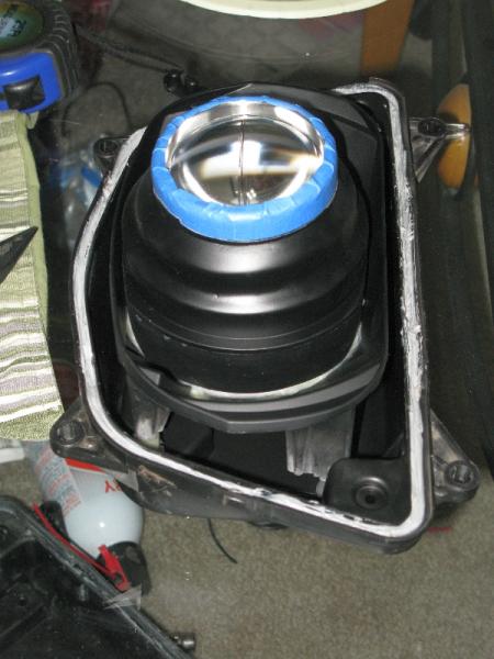

Well I have had things on the bike for over a week now, I figured I should share things before I forget the details.

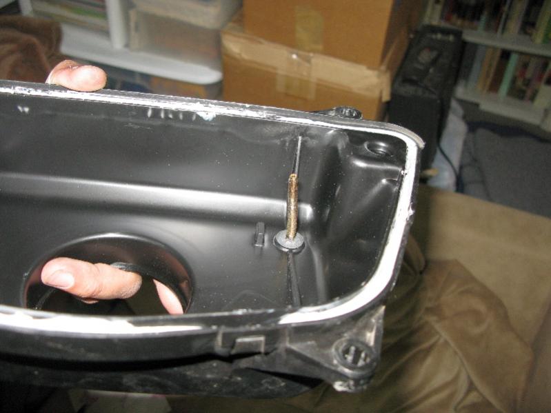

Back to the shroud.
The first picture shows the projector mounted inside the shroud. I placed a few drops of epoxy on key areas to ensure it would not rotate in the housing down the road. I also epoxied the threaded ring in place to make sure it would not back out and cause the projector to move around. I even put a dab of epoxy on the edge of the lens as it looked like it may want to rotate with vibration after a while
Next thing I needed to do was epoxy the shroud together. I used some that was designed for abs, pvc, fiberglass, etc. Now that the shroud was together I decided I needed to stop the light leakage. After ended up using spotting putty which is in the bondo section of most auto shops. Wow did I discover why I was not into autobody work.
After the first attempt of the spotting putty and painting I discovered that what if you’re going to be painting something it needs to be as smooth as a babies *** otherwise you are going to see every imperfection. I had to sand things down and apply more putty, then sand, about 8 times to get things where I wanted them. What a pain. Using a 400 grit sand paper worked really well on that stuff. I had a few other imperfections and used a “build up” primer which I filled in the rest. The thing that sucked is I had mounted the projector inside first so I needed to tape and prevent any dust from getting inside. I finally got a few coats of flat black on and then epoxied the shroud inside the stock housing.
Attached Thumbnails HID Retrofit in progress - E46 Bixenon  Projectors-bikes24.jpg   HID Retrofit in progress - E46 Bixenon  Projectors-bikes20.jpg

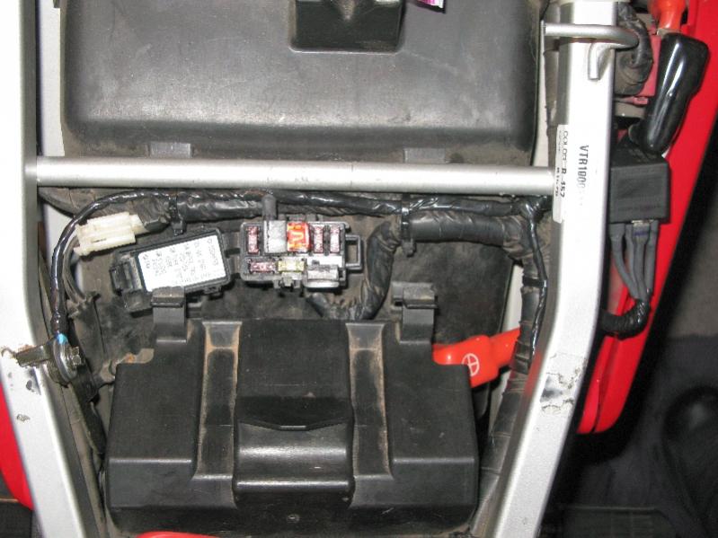

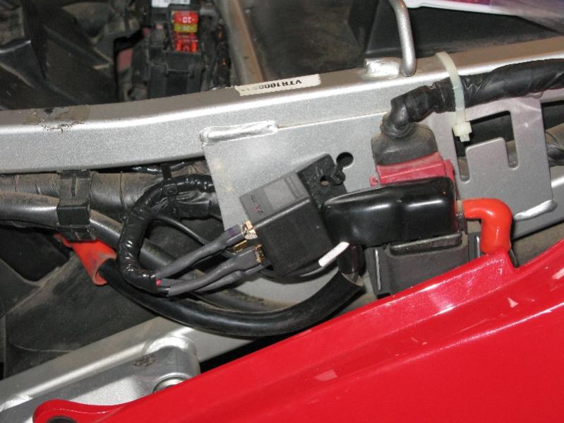

Now comes the fun part of electrical stuff.
I ended up not using the delay circuit as it was a piece of crap. I ran the electrical up the left side of the bike along side the stock harness. I placed the relay on the left in front of the started relay, that way it did not get in my way of the sides I use for storage. I ran a ground and a positive straight from the battery and have the relay triggered off the stock lighting wire off the stock harness. I used a 14 gauge wire and made sure to solder every connection, heat shrink, then wrapped with electrical tape to keep the stock look. We soldered a diode directly to the terminals of the relay as others recommend. I epoxied the ballast to the black removable air ram insert on the left side. I found it fit perfectly between two notches and cannot be seen from top of in front of the bike. The pic shows the original setup I did which in which I used an "add a circuit" fuse holder. Since then I have replaced that and did another setup.
Oh yeah while I had the fairings off I decided to paint the grill that goes over them black...looks really good.
Attached Thumbnails HID Retrofit in progress - E46 Bixenon  Projectors-bikes27.jpg   HID Retrofit in progress - E46 Bixenon  Projectors-bikes31.jpg   HID Retrofit in progress - E46 Bixenon  Projectors-bikes33.jpg   HID Retrofit in progress - E46 Bixenon  Projectors-bikes39.jpg

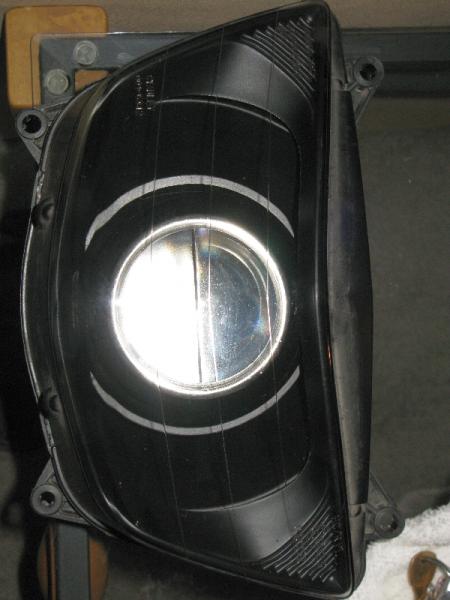

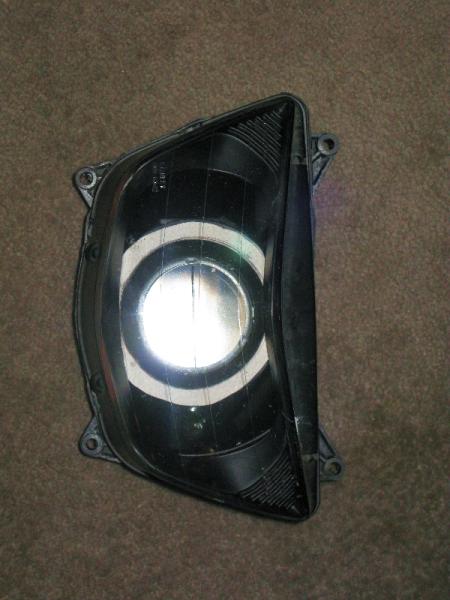

Putting things back together.

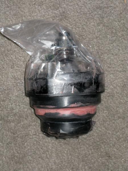

I was ready to pull my stock light off and pull it apart. We were much more confident this time as we already had one under our belt. 250 in the oven for 10 minutes without shutting the heat off is perfect. We pulled it apart within a minute. This time we used a flat head screw driver flatten the stock sealant back into place by sliding it along the groove. By the time we finished the stock stuff was nicely in the groove evenly all around. You’ll want to hurry with that part as it sets back up fast as it cools down.
As you can see I bent the stock adjusting screws as I found they will give a rotation adjustment as well as the normal horizontal and vertical. Its not much but it is enough. We thoroughly cleaned everything multiple times and used compressed air to try and get every possible piece of lint or dust from showing. We placed the new reflector/projector into my housing and placed the stock lens over it. This was the part we were worried about as we did not know if the solenoid and electronics could deal with the oven again to seal it up.
For security precautions we placed 2 pieces of ice underneath in hopes it would keep things cool. 250 at 10 minutes again. We were all ready to pull it out of the oven and have to start pushing and sealing things back up. To our surprise the weight of the lens and the heat was enough to settle the lens into place itself including locking the little clips.
Last pic is before we sealed it I had cut a piece of paper out to eye ball what an angel eye would look like in there. I may still do it down the road, not sure.
Attached Thumbnails HID Retrofit in progress - E46 Bixenon  Projectors-bikes23.jpg   HID Retrofit in progress - E46 Bixenon  Projectors-bikes36.jpg   HID Retrofit in progress - E46 Bixenon  Projectors-bikes40.jpg   HID Retrofit in progress - E46 Bixenon  Projectors-bikes01.jpg

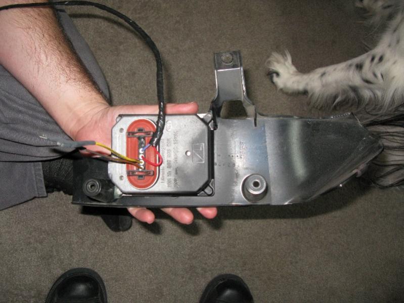

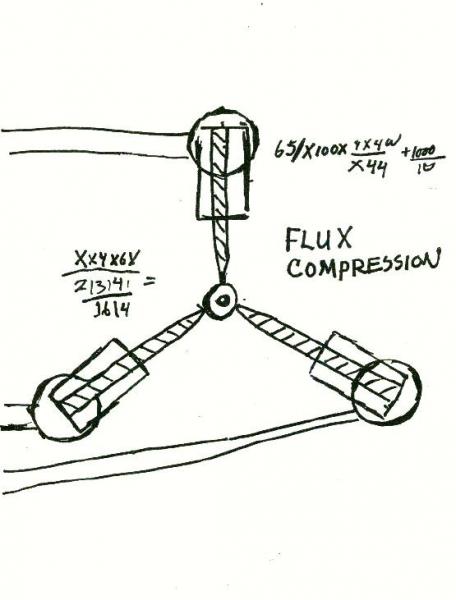

All that and the lights goes out on me after a few miles. After doing some research and tons of troubleshooting we determined the issue is 99% a bad bulb. I have ordered a new one and should be here within the week. The light does look amazing when its on. I will be posting some comparison shots of this setup with Lazn's Silverstar. If there is anyone in Arizona that has a complete stock setup let me know as I want to try to get a pic of all three in comparison. I will also be selling all my extra stuff that I have, which includes the headlight I used to do moch ups, another e46 projector with the high beam solenoid attached and an oem 85122+ phillips 4300k bulb, e46 stock ballast and igniter and a 12 volt spst automotive relay. Pretty much you would just need the plumbing parts and some time to do the same thing.
Old Mar 11, 2009 | 12:27 AM

And while hanging a clock in my bathroom I slipped and hit my head. When I woke up a had a vision of the next mod I wanted to do to my bike, I made a sketch. Not sure what I will call it yet.
Attached Thumbnails HID Retrofit in progress - E46 Bixenon  Projectors-fluxfull.jpg   HID Retrofit in progress - E46 Bixenon  Projectors-flux_capacitor.jpg
Old Mar 11, 2009 | 08:56 AM
  #39
Hmm that device looks to have a fluxating pulse pattern to it.. Perhaps calling it a Flux something or other.

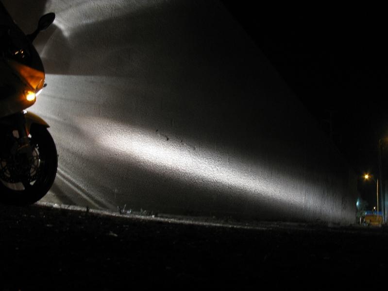

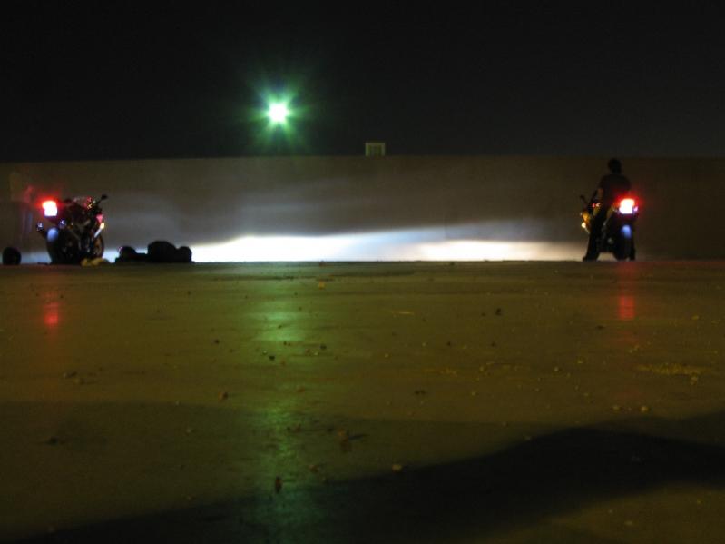

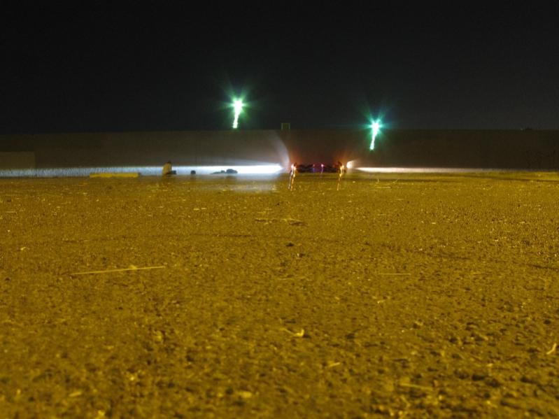

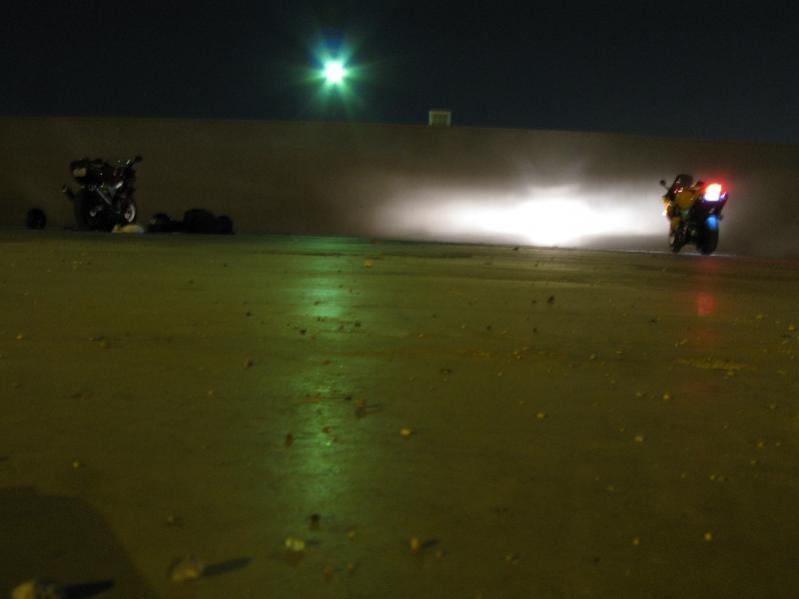

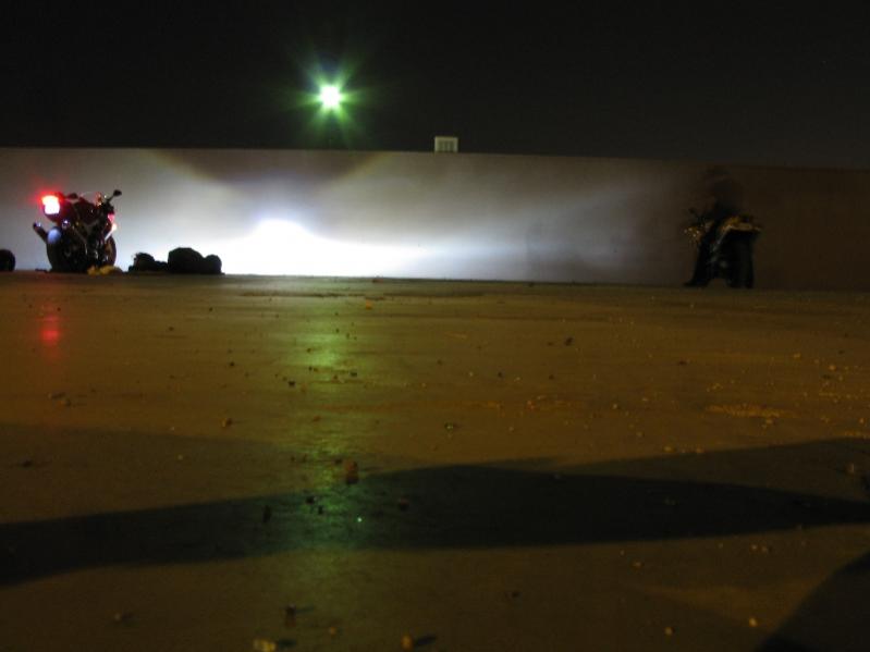

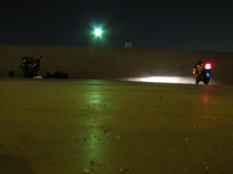

Pic 1 is both our low beams on sitting the bikes side by side, the beams overlap but you can still see the difference in them

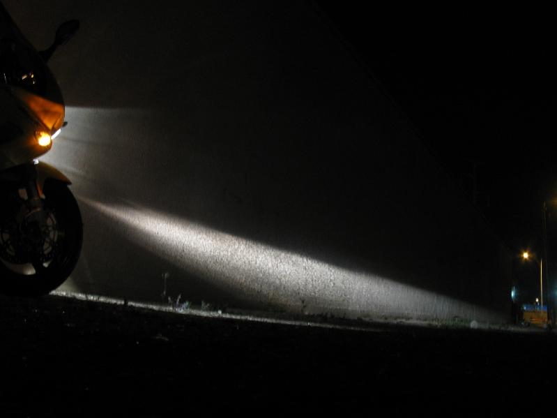

pic 2 is just my low beam

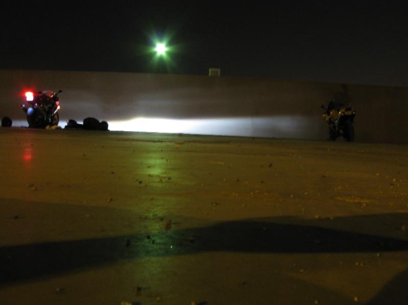

pic 3 is Lazn's Sylvania Silverstar ultra low beam

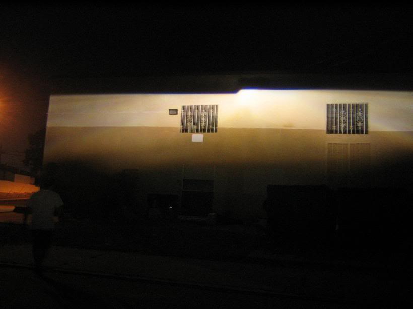

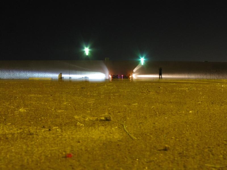

pic 1 is my hi beam
pic 2 is his hi beam
pic 2 is both our low beams parallel to a wall in opposite directions
pic 3 is both our hi beams parallel to a wall in opposite directions

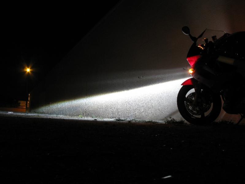

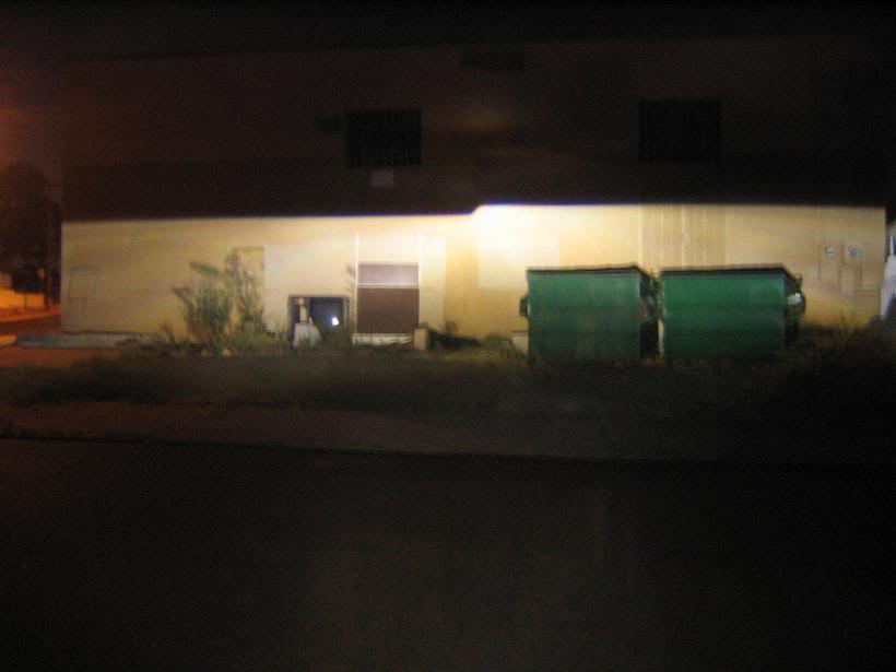

pic 1 my bike low beam
pic 2 my bike hi beam
pic 3 lazn's bike low beam
pic 4 lazn's bike hi beam
Attached Thumbnails HID Retrofit in progress - E46 Bixenon  Projectors-bikes10.jpg   HID Retrofit in progress - E46 Bixenon  Projectors-bikes11.jpg   HID Retrofit in progress - E46 Bixenon  Projectors-bikes16.jpg   HID Retrofit in progress - E46 Bixenon  Projectors-bikes15.jpg
