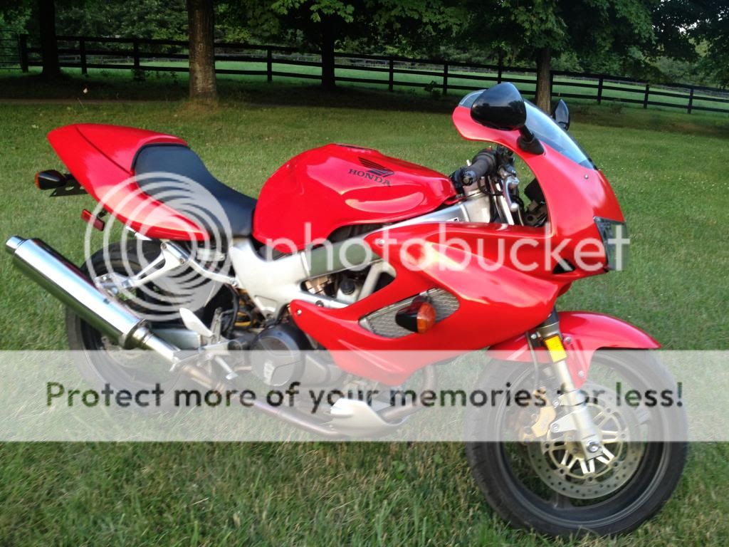

I went through the same thing last year when I was selling a red 1998 that had an unpainted upper fairing. I thought mine turned out very good considering all that I read about how hard it is to match.
I was lucky to find the receipt, I bought this paint at Salvo auto parts, it is their Perfect Match brand paint in FLASH RED. I think I used 3 cans on just my upper, and I would have been better to have 4 and get better coverage on the last coat, I remember I was running low. You should get 5-6 if you're doing a fender too.
I remember when I was reading about matching Italian Red, people had commented that Honda's combination of primer, base color, and most importantly the clear which has a pearl in it is very hard to match the end result even with professionally matched color.
I think maybe it turned out a little more orange than the rest. I had tested 3-4 colors I found and this was the best match.

Wow - that looks like a pretty good match. I will be pressed to do any better. Of course, we have no Salvo Auto down here in North Carolina… but it gives me hope. I will try to find out who supplies their paint.
