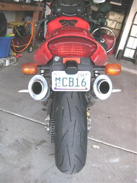

My opinion: Go into the Knowledge Base, and read Haknslashes right up on LED Retrofit. $25 for the light, hour of your time. Swap out the turn signals with some Lockhart Philips or Motrax LED turn signals, and waahlaah, you have a clean rear end.
Most of the comments that I have read on the Integrated tail lights were that the owner didn't care for them, or the turn signals weren't bright enough.
If you want, I'll take a pic of the rear of my bike.
I think the Motrax turn signals were around $50 on Indysuperbike.com, the LED brake light was $23.97 (before tax) at Advance Auto.
Erik

Old Sep 2, 2008 | 12:23 PM
Erik S.'s Avatar
Posts: 1,216
From: Westerly, RI
Sorry that I didn't put these up yesterday. Did almost 200 miles on the bike.
