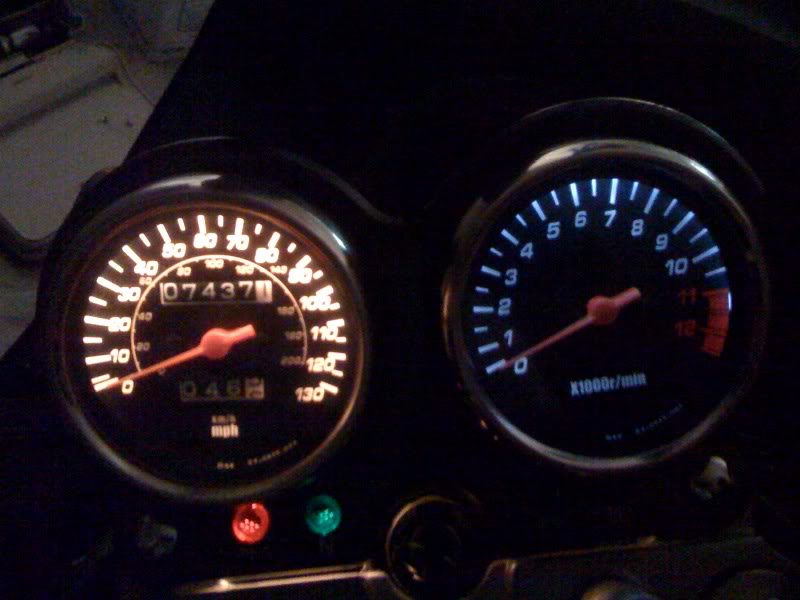

Well.. i just spent an hour confusing myself. I took apart my gauge cluster to realize that since i have a 2001 hawk im guessing my bulbs are different from the older models. The bulbs in mine are about HALF the size of a 194. They look more like the tiny instrument cluster bulbs that i had to replace in my eclipse.
BUT....
I wasnt happy so i took my wifes gauge cluster apart on her 2005 GS500, and guess what... hers takes 194's.
so....
I had some extra standard NON-LED 194 bulbs laying around so i tried them out. The picture im posting is of a standard 194 bulb. Where i circled with yellow in the center is the green and blue things im about to discuss.
On bulb 1, standard 194, it had a green center thingie that i marked in yellow. it was very low watt, and looked more yellow than white.
On bulb 2, standard 194, it had a blue center thingie that i marked in yellow. It was MUCH brighter.
Finally, i put the LED 194 in to compare to the bright standard 194
Standard bulb with blue thingie on the left, LED bulb on the right.
I know this is confusing, but ive had a few whiskey drinks tonight, and its the best i can do at the moment. I brought my wife into the garage and showed her the difference. She likes the standard 194 look better. Im more of a fan of the LED 194 myself. to each his or her own.

Old Nov 24, 2009 | 09:20 PM
Posts: 2,223
BUT....
so....
A standard 194 is 5 watts (versus Honda OE at 1.7 watts), which runs too hot for our (or the Suzi GS) gauges; don't use one. The dimmer 194 maybe is a low-watt 194 like the Honda OE. Personally I like the LED better too. I will verify the 1998 Honda OE is in fact a 194 low-watt but I'm almost certain it is. The manual says after 98 it was dropped to 1.4 watts but does not say they went to a smaller size bulb; i.e., smaller than a 194 (like earlier Hondas like the Hawk NT 650 had). So your 2001 needs a smaller bulb (what type?) but you tried the 194 LED eq in the Suzi GS and it did fit and illuminate adequately, so it should also fit the 98 VTR.
