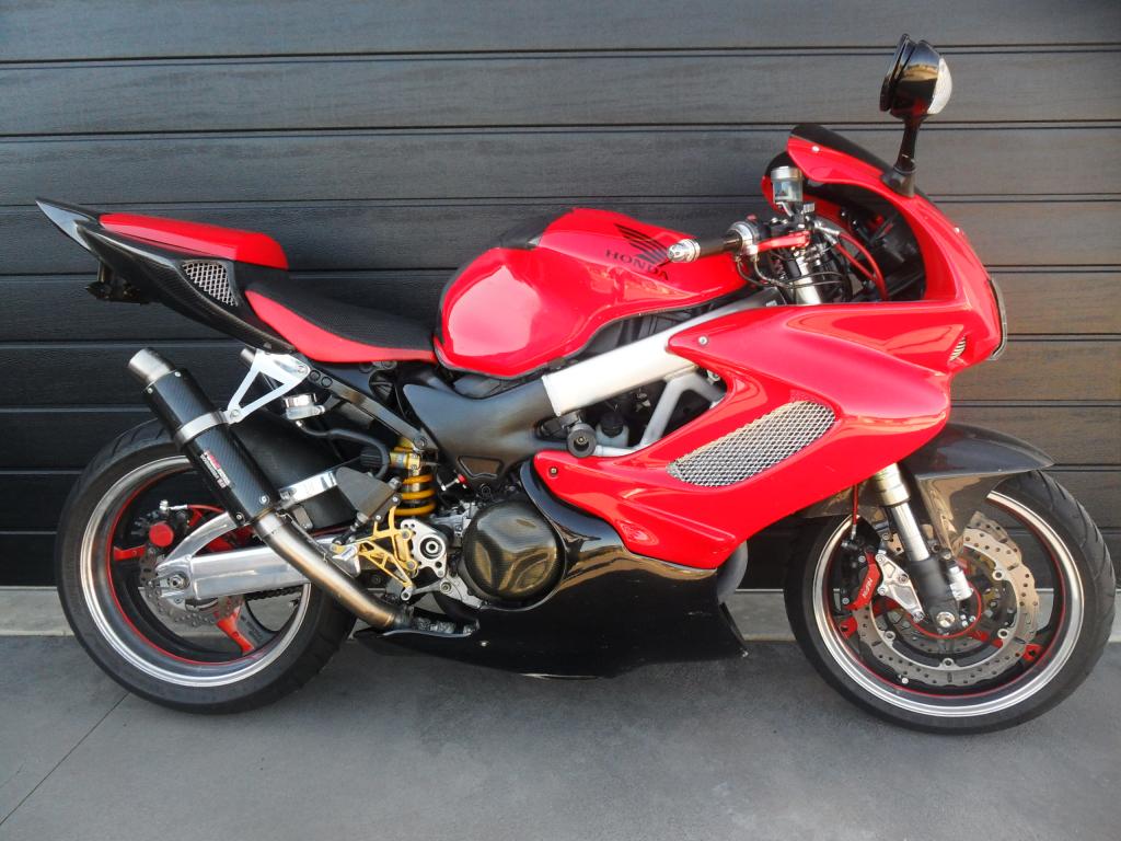

I knew I was going to run turn signals/running lights elsewhere, so I filled in the holes in the sides of the fairings with pieces of plastic from another set of crappy fairings, which was then formed to the curvature of fairings and then plastic welded in place. A little flexible filler, and primer and it is ready for paint.
I think as far as mirrors that fit our bikes go, the best looking mirrors with indicators so far is from the GSXR. I found the mirrors need to be from Suzuki, not eBay or Amazon knockoffs. The knockoffs don't work as well and they just look and feel cheap.

As CruxGNZ has said ,just use similar plastic comes up ok...
