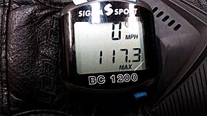

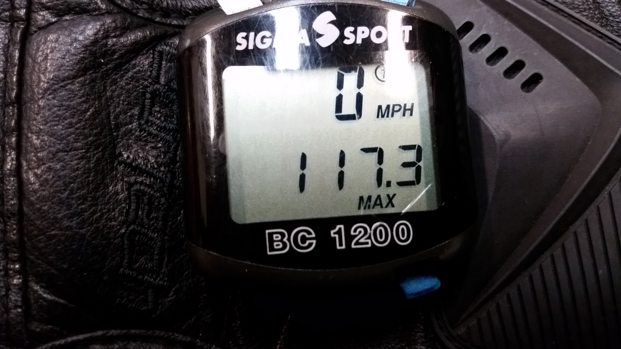

Attached Thumbnails Longtime rider, first time Superhawker-20170420_184158.jpg
