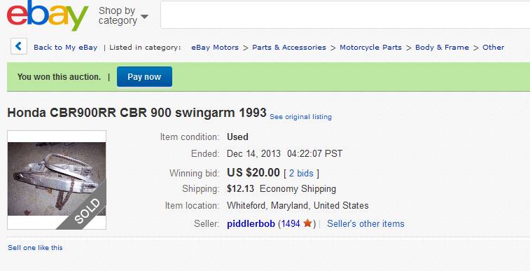

Well kenmoore, not only has James inspired you, you both inspired me! I just paid $32 and change for a swinger shipped to my door. I'm thinking after I cut the brace off, the local recycler will give me more than that for the remaining aluminum for scrap!!
Thanks for starting this thread!
