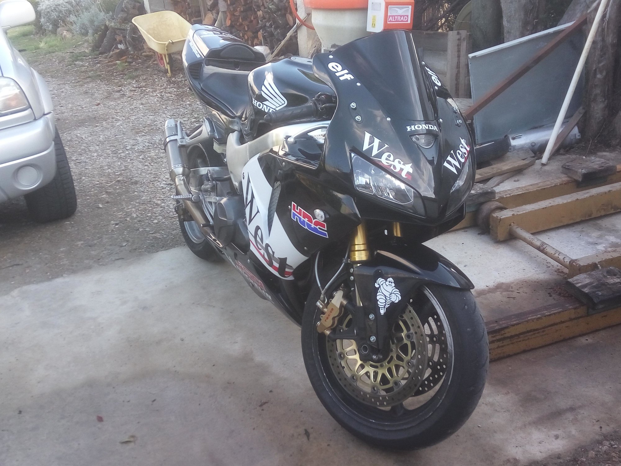

i'd like to introduce my superchicken.
It's a 2000 model, with "few" modifications...
I found a lot of informations to do the mods on this forum, so thanks you everybody !
-cbr1000rr front forks with ohlins NIX30 cartridges inside
-cbr954rr 330mm front brake discs
-gsxr 1000 k8 front brake calipers
-cbr1000rr front master cylinder
- cbr600fs front wheel
-rvt1000r SP1 swingarm
-cbr929rr rear shock absorber
-homemade subframe (designed for dual seat)
-cbr600rr 2006 fairings
And lots of other mods
Hope you'll like !

Bienvenue C’est un beau vélo, et le meilleur échange de carénage que j’ai jamais vu ... Bien fait
Welcome
That is a nice looking bike, and the best fairing swap I have every seen...Well Done
And please excuse my French, I cheated and used Google translator ...so its possible I said "Welcome, nice looking poodle, best enchanged baguette I have peed on "
Old Nov 25, 2018 | 06:30 AM
Tell us about the faring swap please.
Other then custom mounts for it..was the CBR fairing modified at all to fit? Material added or removed?
Old Nov 25, 2018 | 09:21 AM
melouse's Avatar
Joined: Nov 2018
Posts: 19
melouse is on a distinguished road
Well, actually, if you hang on the Idea of swapping the fairings without making custom brackets, you will make nothing good, with a "Much too high" front fairing, and a "much too low" rear fairing, like almost all the fairings swaps i've Seen on superhawk.
i made a custom rear subframe and a custom adjustable front fairing bracket in order to fit the whole fairing kit without modifying it that much.
The rear fairing is almost full stock, and the front one modifications only consist in cutting some plastic to make it match to the radiators and engine shape.
now i'm a the point where i'm going to disassemble the entire bike in order to make every custom part "pretty" (mostly finish and painting). So i will be able to take pictures of all the brackets if you want

Thanks a lot !
but the most difficult was not the fairing Swap.
Absolutly NOTHING came "plug n play" with the front and rear ends swaps ! Lol
there were easyer swaps to do for the forks and swingarm, but i found the RC arm for 30$, and i wanted later CBR forks.... So Big Big work for châssis adaptations, link parts machining, fully adjustable rear sets making, and all of that....

Yes absolutely would like to see pictures of the fairing brackets, and yes that was my point I understand they are required to be custom made to fit the fairing correctly.
Yours, the fairings really seem to fit he lines of the VTR frame and envelop the motor well.
The swap would give me the improved twin headlight bulb design I need to use two HID projectors.. As well as cbr600rr 2006 fairings are much easier to find than good used VTR fairings.
Question, which 2006 CBR600 fairings were used.?
CBR600rr or CBR600f4 both are listed for 2006 and use different "upper cowling"
From the pictures you posted I think you used the CBR600F4i but would like to confirm that.
Thanks
Old Nov 26, 2018 | 06:46 AM
melouse's Avatar
Joined: Nov 2018
Posts: 19
I used a 2005/2007 cbr600rr fairings kit for the entire bike (rear and front), as the last year of production for the F4i was 2003 (in France).
the only part of the fairing kit i didn't use is the fuel tank cover (that doesn't fit)

Ahh ok you used an after market fairing kit. How was the fit? Tabs? holes? over all looks?
Seeing as one of the biggest complaints on the after market plastic is the fastener hole locations being slightly off, or ill fitting...and this swap uses custom hangers... That issue goes away.
I used a chinese kit. For 350€ on eBay, i've had ABSOLUTLY all !!!! The smoked screen, the heat Shield for the exhaust, the ram air intake, all the plastics that go inside the fairing....... ALL !
It looked very nice for the Price, and the holes........ I made the brackets for the holes where they were (as you said)....

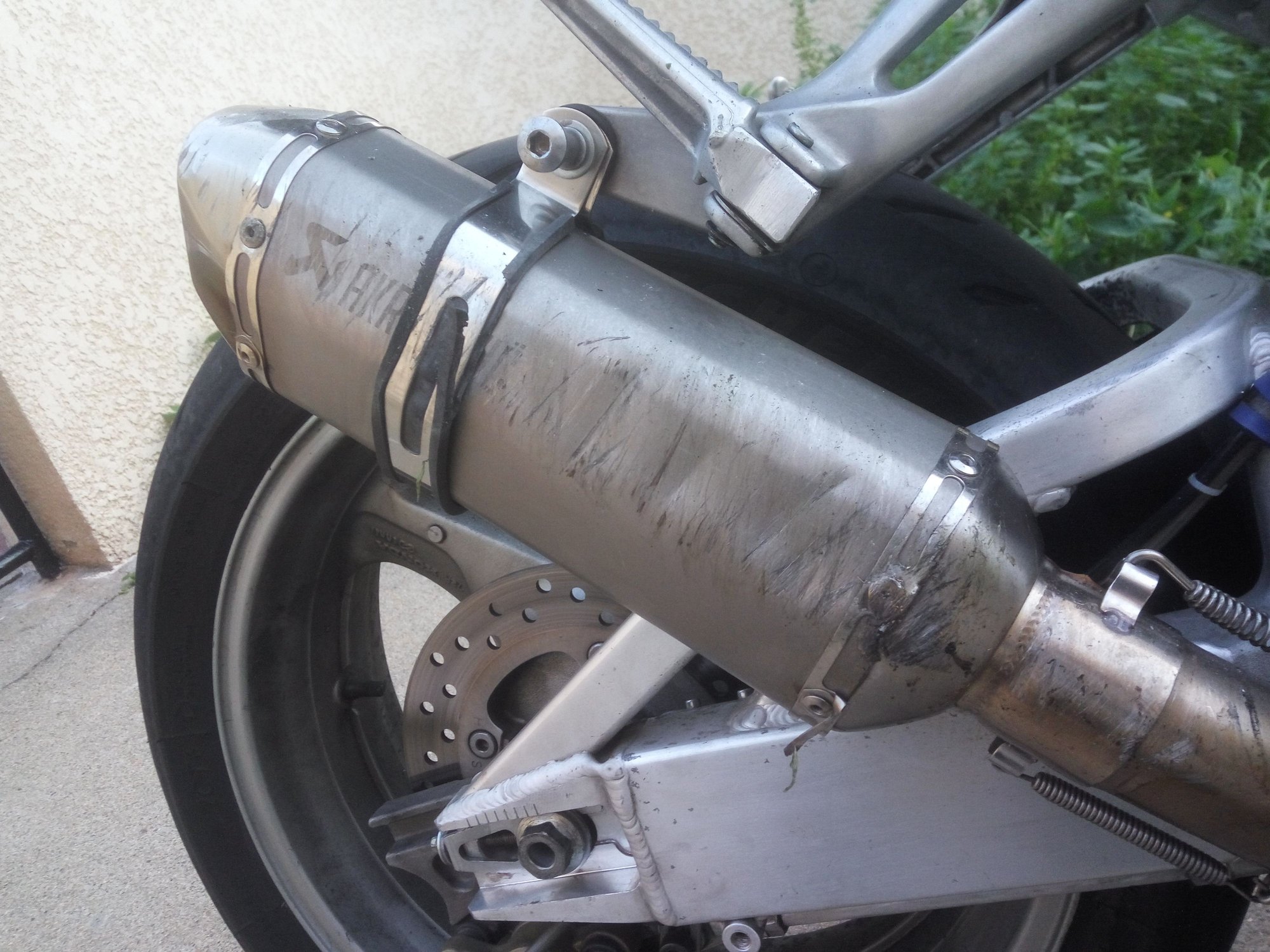

Well...... Here i am.....
Old Nov 28, 2018 | 09:30 AM
Aquasnake's Avatar
Joined: Nov 2012
Posts: 211
From: Henderson, NV
OUCH!!! Are you okay?
Old Nov 28, 2018 | 09:43 AM
melouse's Avatar
Joined: Nov 2018
Posts: 19
Doesn't matter....... But yes.... Thanks
when i got the bike up, i didn't notice that my clutch cover was broken ......
My engine was empty of oil, and i came back home without a good lubrification (about 10km/6,5miles).
I hope i didn't damage everything inside......
So sad.......
