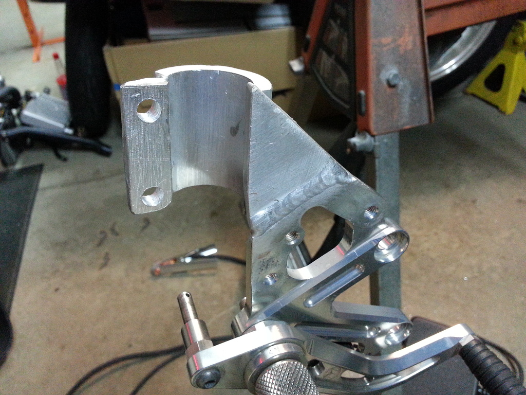

I decided to flip the rear master cylinder. Yes, final decision! I figured if I'm going to do it, I may as well do it right. Also, doing it this way, I know that I won't have to get a resevoir extension.
I'm going to use a 1.5" dia. 1/4" thick wall aluminum tube (the one pictured is just to see if it would work) and slice it in half lengthwise. Weld it to the rearset, and make tabs with holes on the other side for the master cylinder. I'm picking up the aluminum tube from Speedy Metals tomorrow, so there will be a final update with that tomorrow I hope.

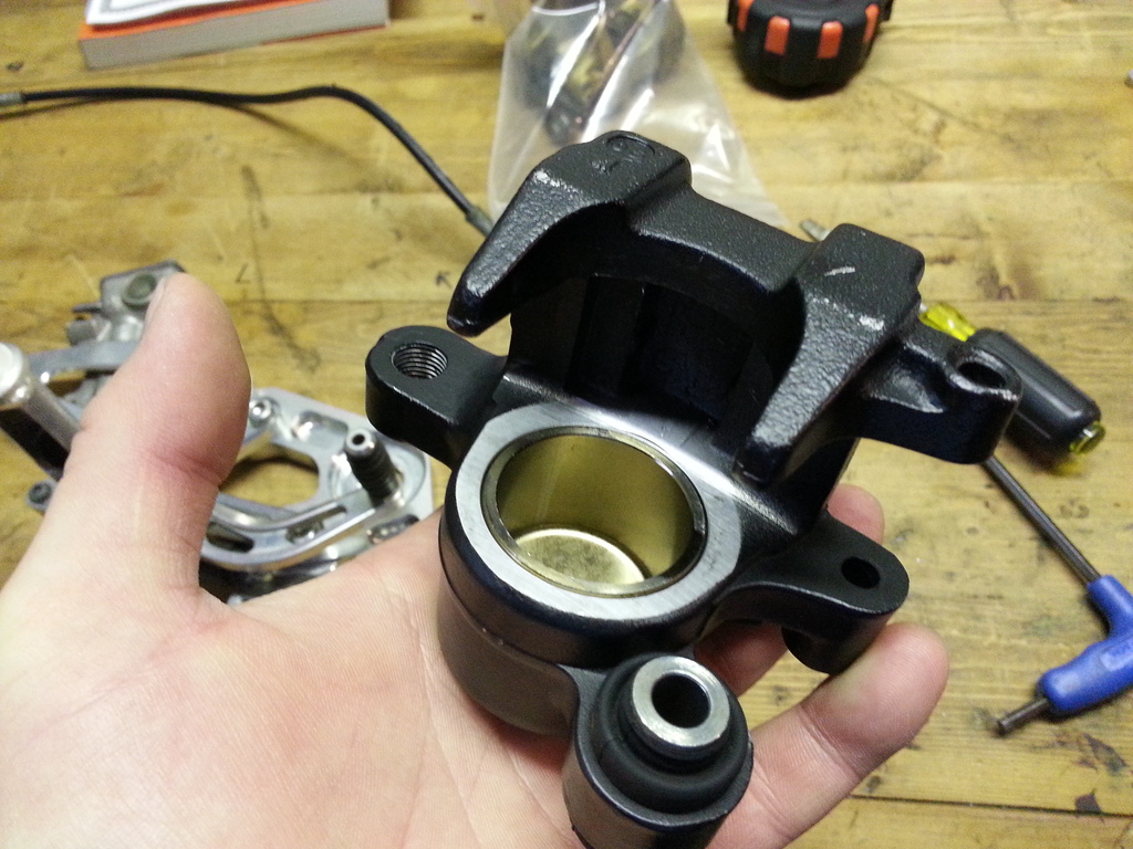

Also, I had a rear brake caliper from a Triumph Daytona and what do you know, it is exactly the same as the stock Nissin caliper, but black. Saves me from having to paint the stock gold caliper. The Triumph Daytona caliper cleaned up very nicely.

Got the rear master cylinder flipped around. Worked out just as I hoped. I still need to sand down a couple edges and then polish the new parts, but there she is finally haha. Now I can order my rear brake line.

Are you sure that material is heavy enough to support the master cylinder?
Old May 5, 2016 | 08:30 PM
  #309
Oh yeah! The rearsets are 1/4" aluminum, so I followed suit with the new material. It won't flex at all.
Old May 5, 2016 | 08:51 PM
  #310
Posts: 2,093
I don't know. I'd add some gussets and, maybe, some carbon fiber straps or something.

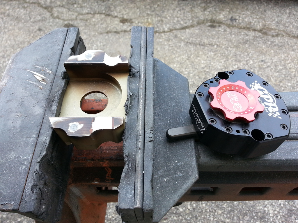

I also had to modify the CBR600 mount for the steering stabilizer. I then drilled and tapped the holes. I'll paint that mount tomorrow.

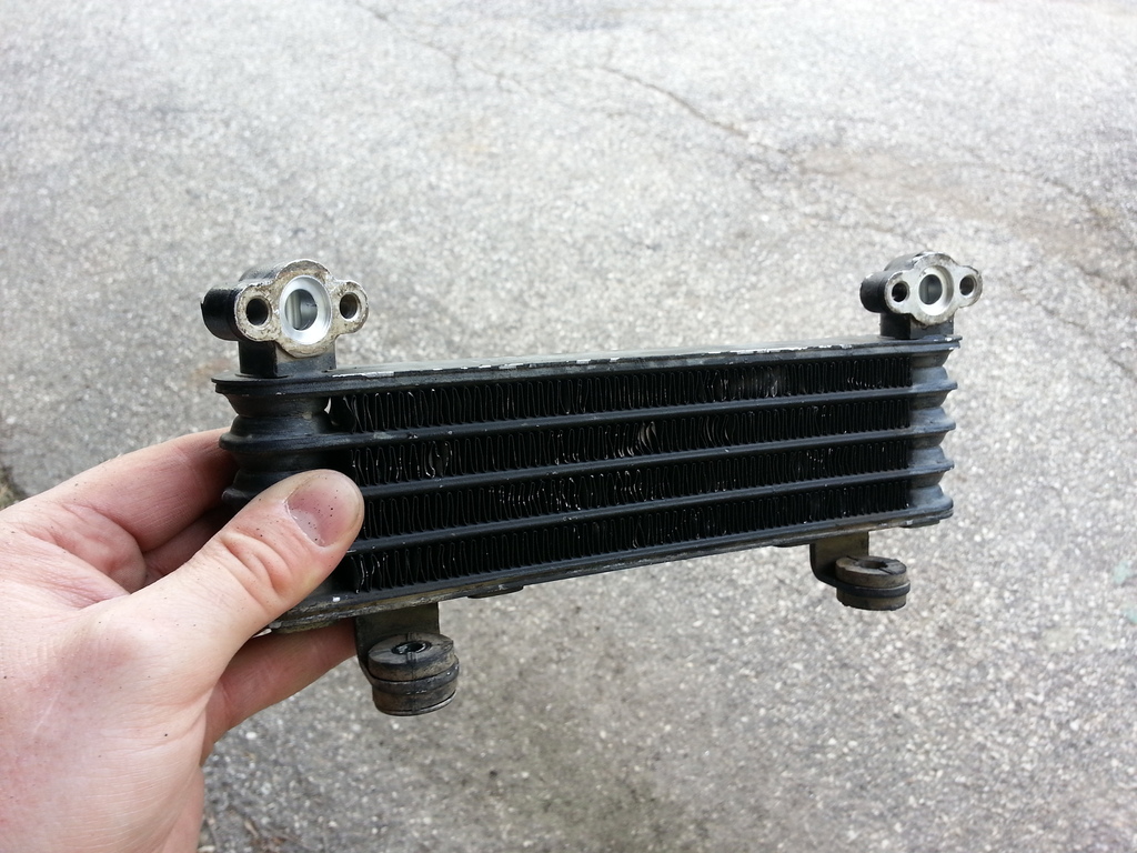

I also got a four row oil cooler. I'll cut and weld the fitting this coming week.

I actually purchased two oil coolers. I'm going to cut, rotate and TIG weld the fitting, then pressure test and paint. Of course I'm going to straighten the fins! I got a neat little plastic fin straightener that really makes it easy. To make a little money to offset the cost of the build, I'm selling the other oil cooler.

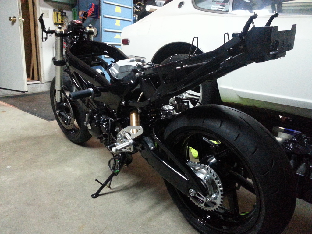

Three hours later, BAM! I got myself a roller

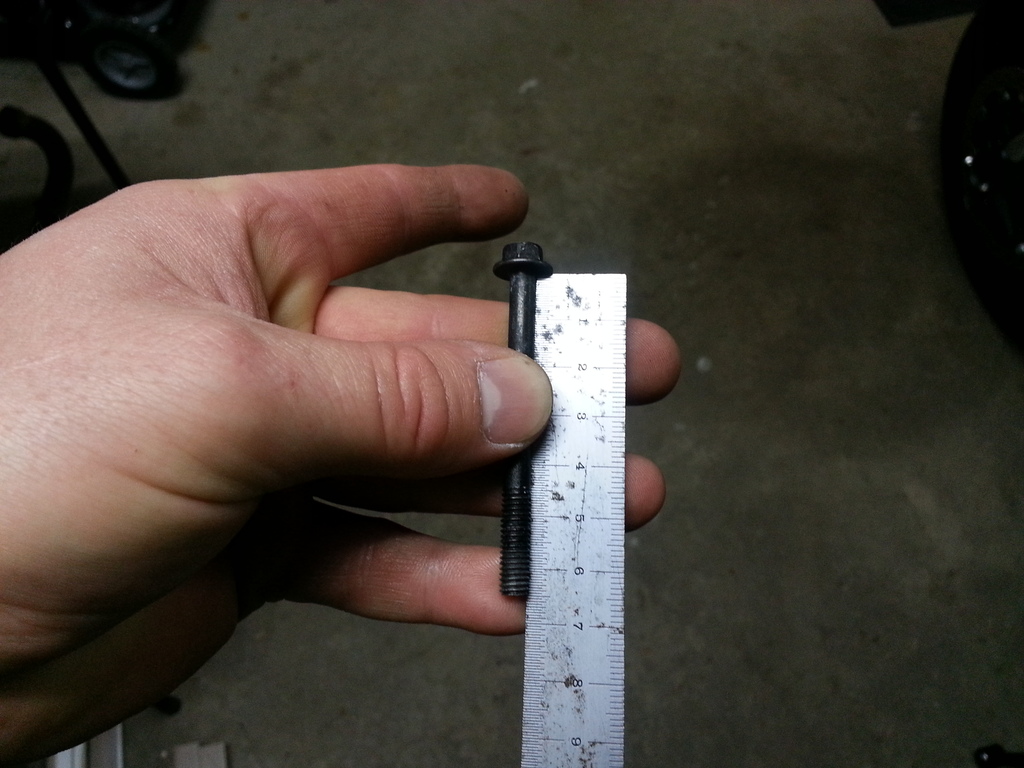

One thing that is bothering me. I found a M6x65 bolt. It has some black paint that is flaking off the head, so that leads me to believe it might be from one of the engine covers from my spare engine. I sure hope it is. As long as it is not from the inside of my new engine, I don't care.
