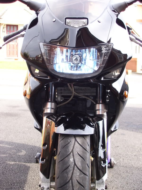

All finished

OK, out with it: details, man, we need details.
ok
Revalved fireblade forks with ohlins springs
BSB spec spondon adjustable offset yokes (currently running 27.5mm, Knockhill track settings)
Triumph daytona clip-ons
R1 mudguard
spondon billet caliper mounts
braded brake lines all round
SBK pads
indicator holes in fairing plastic welded up and new smaller holes drilled for new flush mounts
sharkskin lower fairing
Alumminium mesh in intake holes
dark tint screen
ohlins steering damper
polished footpeg assembly's & top yoke
alumminium pegs for better feel
penske rear shock
black frame and swing arm
total respray in black with honda wing tank decals ( british bikes had firestorm decals ) and red VTR on fairing
clear rear light & mini indicators
pyramid undertray
carbon hugger
K & N filter
dynojetted
high level fuel titanium cans with removable baffles
dunlop qualifers (180 rear)
errr...i think that's it........
.....for now

What's the story on those caliper brackets up front? They look like brackets for oversized rotors, but the rotors appear stock. It caught my eye because the calipers do not look like they line up correctly with the rotor. Is this just the angle of the photos or is something else going on?
Looks to me like they convert the 900RR caliper mount to the VTR calipers to allow them to work with the stock VTR wheel. At least that's what it looks like....
yep

Except the calipers and rotors are both the same as the 900RR. ??? I'm still not sure why the brackets are necessary and it still looks like the calipers are not in the correct placement for the rotors.
Because it running spondon yokes that are wider than stock, the mounts are used to space the calipers back towards the disks, if you get my drift.

Ah, cool. So I guess this required different wheel spacers too. What about axle length?
not too sure, this set up was done when a bought the bike, looks like a genuine (honda?) part rather than a bespoke item.
