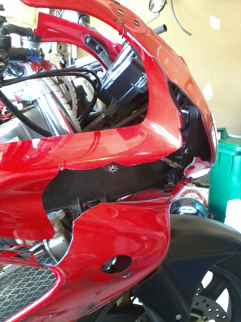

I was heading back from work on June 14th. I was on a 4 lane road seperated by a double line median, 50mph zone. There was alot of traffic eading westbound, and very little heading east in my direction. I saw a bike in the distance passing multiple cars by jumping over the double solid line into my oncoming lane, so rather than filtering through his lane, he decides to come at me head on. This guys flying... I start thinking "this tard is heading straight for me!" I steer right to avoid a head-on with him and wind up bouncing off the left side of an SUV thats at a dead stop behind another car that is turning right into a driveway. I have no time to react, hit the back end of the SUV, take out the taillight, my steel toe boot takes the right peg off so I have no rear brakes. I bounce across the side of the SUV and my right hand and right side plastics take out the mirror on the SUV... Now I have no front brakes and the bars are going back and forth doing the funky chicken...
I manage to hold on, I'm all over the bike... I have no brakes, so I kill switch it, keep downshifting to bleed off speed, and it takes me a 1/8 mile to coast to a stop...
Bikes F-ed... pissing oil out of the clutch cover, I know I'm hurting.
The 4 teenage girls in the SUV are fine, they didn't see the oncoming bike (they are 4 teenage girls... I don't think they notice much, lol...)
Right side of the bike is screwed. Rad is bent, tank is dented, fairing exploded, etc...
My knee feels like someone hit it with a hammer, my hand is bleeding from hitting the mirror.
No charge since the other vehicle involved dissapeared. No collision, so I'm stuck putting the bike back together myself, or parting it out. I can fix it.

How it sits right now.
I've got a new rad (well, new to me.)
rearsets on the way.
clutch cover coming.
picked up a cracked right side fairing, already started plastic welding it. Soldering iron works wonders.
I might glass the CF bellypan and paint it... A shame to cover the carbon fiber, but it took a good hit.
Midpipe on my right Hindle slip-on took a hit as well. It's purely cosmetic, but it looks like ****.

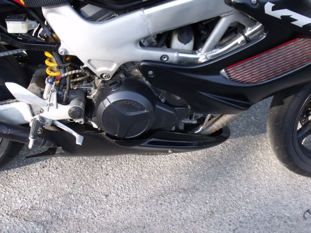

Got it back together. Painted it in the early spring. HVLP gun and GM gloss black paint.
Wasn't trying to break the bank on this rebuild. I put the stock forks back on, VFR bars, and used the second set of bodywork from the parts bike. Might have to tear into the carbs as I seem to have a bit of a stumble and more vibration than before under hard acceleration. It was sitting for about 8 months or so; I suppose it's to be expected.
I'll run some seafoam through it and see if that cures it before I tear it apart.

Thanks guys! I ride the hell out of my bikes, so I didn't want to break the bank on the rebuild. I'd like to get rid of the "flexi-flyer" front end, but it works fine for street duty. The suspensions been sorted, but 41mm stanchions tend to feel like wet spaghetti at high speeds, lol...
Old May 22, 2012 | 06:53 PM
Nice job with the rebuild; bike looks very good
Old May 22, 2012 | 07:33 PM
GTS's Avatar
GTS
Seasoned tech
Joined: Apr 2012
Posts: 576
From: Issaquah, WA
Looks pretty good for the most part. Some 1500 grit wet sand paper and a good buff would really make it pop! Looks a little orange peeled.
Old May 23, 2012 | 08:08 PM
matt365's Avatar
Posts: 506
The pressure in my gun was turned up too high when I started spraying. Its got a textured look to it. I don't mind really, its my second set of bodywork off my parts/project VTR. If it bothers me down the line, I'll just spray the other set in the off season.
I kinda like having it seem a little ugly, less desireable to thieves I suppose.
