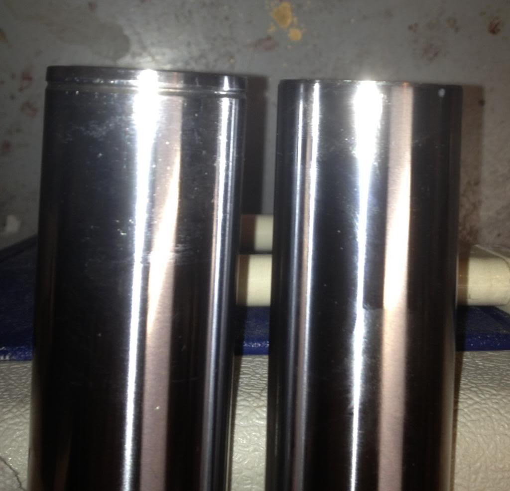

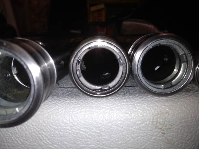

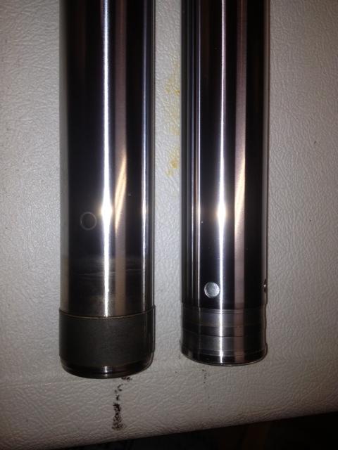

Old Nov 14, 2012 | 12:48 PM
Caffeine's Avatar
Joined: Oct 2012
Posts: 142
From: Ottawa Ontario
Caffeine is on a distinguished road
Update.. as I have been waiting for 4.5 weeks now for my forks to arrive at my door from china, I received an email saying "shipped" so now I'll be waiting another 4-6 weeks.. ahh.. well it's nearing 0°C outside so nothing but time.. but I have to find a way to move the bike to get the car in garage for winter with no front end.. as both forks are tore down and sitting in my basement right now..

forks came early! but there NOT 100% the same.. so are they 100% the same as the 97-00 as stated in the ad.. or are they simple different then everything? well I'll never have anything to compare except for my 01 fork tubes and in the end I think there going to work just fine.. even if there not oem!
so what's different.. well the top grove that holds the "C"clamps and keeps the handle bars from flying off even if they come lose, well it's not there.. ( but I'll toss them in the lathe and put that grove into the new forks pretty easily I think) 2nd.. there are 4 holes in the base not 2 and there lower then the 2 in mine.. this I don't understand.. should perform the same basic operation but I'm not 100% why they didn't put the holes in the same place..
Old Nov 19, 2012 | 04:17 PM
HRCA#1's Avatar
Joined: Oct 2007
Posts: 1,082
From: Menifee, CA
Dude those tubes don't seem to even be the same diameter ie 41mm and even if they are I would not use them. Return them if you can and contact Scottieman for his or Jamie to straighten your. Believe it or not we did it all the time back in the day.
