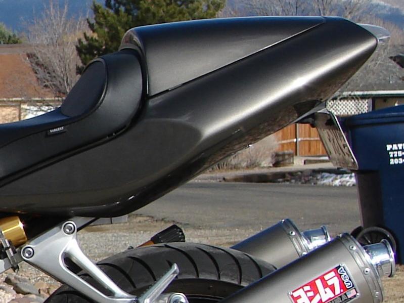

-I personally think that a trimmed rear fender looks better than the aftermarket under-tail, along with the integrated tail/turn light (see photo's), plus you get to keep your trunk space. You have to hack off most of the rear fender when putting on an under-tail anyhow... I've never understood why nobody could make a direct replacement.

That turn signal/tail combo looks great, who makes it? I like LEDs but don't want to have to do much more than plug&play, electrical is not my forte. I can splice wires, though.

That chop job on your rear fender looks really good, Inderocker. Thanks for posting the pics. I didn't know that using after market undertails forced you to cut the existing fender. I agree with you, if you've got to cut it anyway... do your own first.
