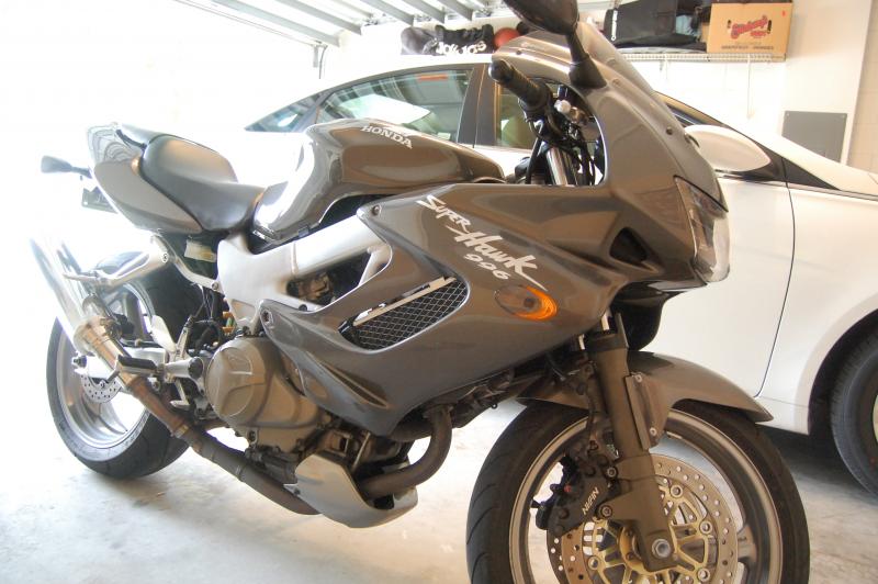

Hello everyone. New to the forum today, and my recently purchased 2005 Superhawk with only 12,600 miles stopped on me cold. Interesting thing is I've been riding her for two weeks with no major problems. Left Interstate 4 here in Orlando, and as soon as I made the turn, engine shut down. This has happened a few other times, but normally she would turn right over and I would be on my way. I have battery power, tach is working, and starter is engaging. Engine refused to turn over. I didn't want to run battery down, so I attempted to turn her over only a few more times, before having her towed to shop. Only issues I had prior was it stopping on me a few times, and putting her in neutral, and into first gear was a challenge. I like to have some idea of my problem before letting the mechanic offer suggestions. Appreciate all of your help along with this thread and forum.

Could be the R/R, it may not be putting out enough power to turn the engine over. Like stated earlier, R/R's can do some strange things when they fail.
I live in the orlando area and wouldn't mind lending a helping hand if you need it in diagnosing the problem, before taking it to a mechanic. Just shoot me a PM.
Sometimes these bikes (and many other bikes) are hard to flip through the gearbox when the bike's not on, just the way it is when everything in there is static.
Sounds like fuel or maybe spark to me. If the battery is good and the starter is turning... it may simply be bad gas, but is more likely a petcock isn't working properly or the carbs need to be cleaned well. Maybe even the tank vent is plugged. Did you recently fill up?
Try turning it on with the gas cap open (or having the shop do this now I guess). If the vent line is plugged, it creates a suction in the tank so fuel doesn't want to flow out. This happens often if you fill the bike up too full. Next, make sure your petcock is working. Disconnect the fuel lines and introduce a suction to the small line attached to the back of it. Fuel should come pouring out (so be ready!) If it doesn't, the petcock is bad.
