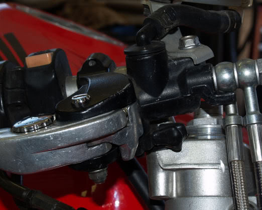

Ordered mixed set of RIDE levers... Emailed the owner and requested a VTR clutch lever, snd CBR 600 F4i brake lever.
The clutch lever fits prefect. The brake lever is wrong.
The pictures http://s258.photobucket.com/albums/h...ion=postupload
Shows the OEM lever that is on the MC now,, and the one sent me.
The silver MC was sold as a CBR600 f4i.. the RIDE lever was requested for the same bike.. they are obviously different. problem is I do not know if either are....
So, hoping one of you can idea the levers in the pics.

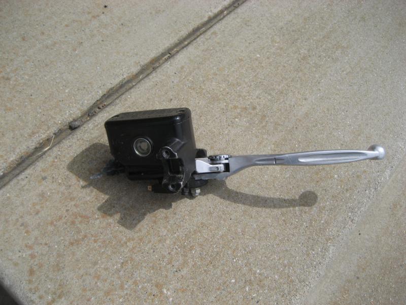

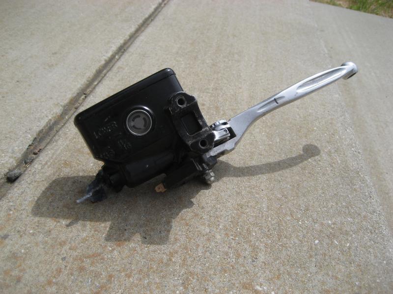

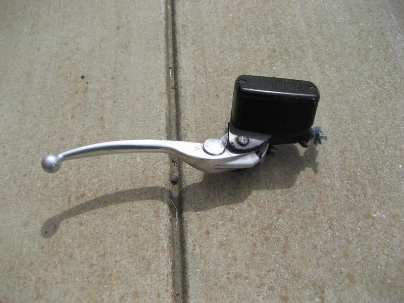

Looks like a lever from a 600rr master. I don't have any pics of just the lever but here are some from the complete master set up.
Does this look like your set up?
Old Oct 16, 2010 | 11:29 AM

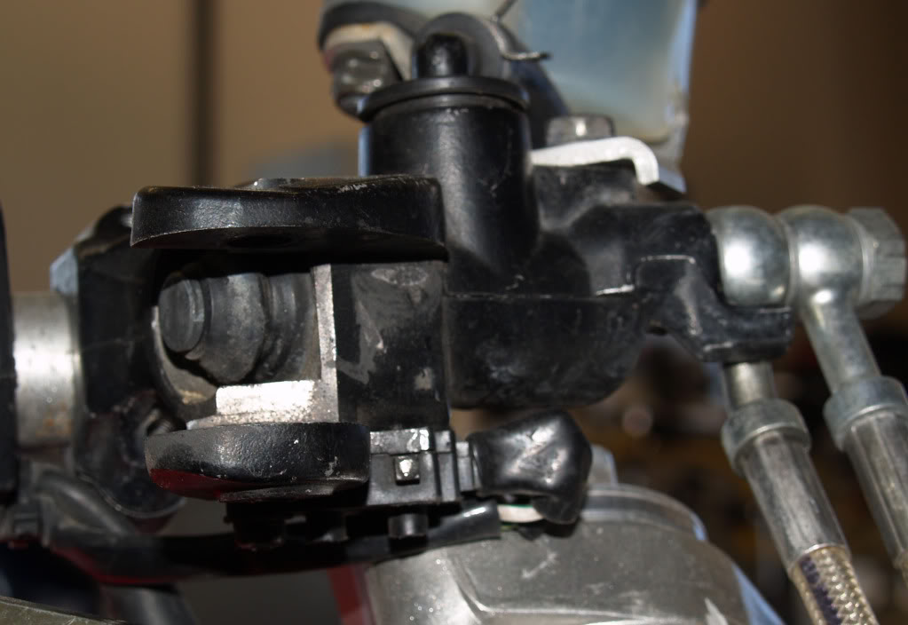

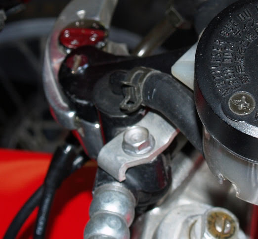

No built in res on my MC... but the lever looks close form what I can see
Old Oct 16, 2010 | 11:37 AM
That is strange because F4i's should have a integrated res. You might have an RC51 set up.

This is mine... I also have a 2002 RC51.let me go look........ MC.. and yup.. Good call.. that appears to be what it is.... CRAP.. my fault.. I ordered the wrong lever.
I did not KNOW ALL THE f41 mc's had built in RES..
