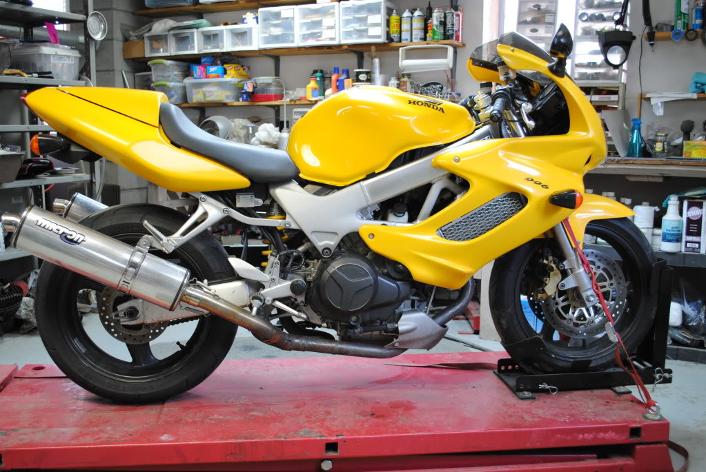

well got going on it,
step 1 reg/ insurance... so happy went from 200/month to 63/month from 919 to hawk. that was worth it right there
step 2 clean shop and mount the bike
oh and washed it too, looks better now

does any one know if that is a full exhaust or just slip ons? im not sure and have not researched it alot to know.
Old Mar 24, 2011 | 03:03 PM
matt365's Avatar
Posts: 506
That looks to be the stock header.
Old Mar 24, 2011 | 03:04 PM
mhaisten's Avatar
Wrench Bender
Joined: Nov 2009
Posts: 96
From: Auburn, CA
Looks like just slip ons.
Old Mar 24, 2011 | 03:08 PM
Furrybiker's Avatar
Posts: 108
From: NW London UK
Furrybiker is on a distinguished road
I have the same pipes read to go on mine they start at the joint below the brake pedal, if thats any help.
Nice clean looking bike, hope you enjoy it as much as I enjoy mine!
Old Mar 24, 2011 | 03:40 PM
3Dcycle's Avatar
Joined: Nov 2010
Posts: 56
From: St Johnsbury VT
3Dcycle is on a distinguished road
ok thats what i was thinking, thanks for the quick responce, they will be comming off at some point to be PCed high temp flat black.
