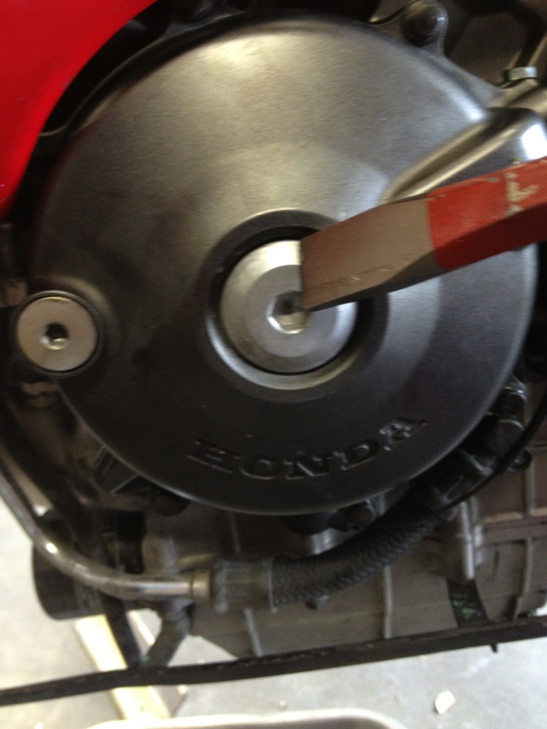

Got that fixed. Put it all back together. Out for a test ride. Rear manual CCT comes loose a block from home. Coast in. Start pulling it apart to check for damage. Stuck alternator cover bolt. Ya know, the big one that folks seem to complain about getting stuck. Well, I got it out all right. But it took this (see picture) to do it.
Used my dremmel tool to cut the slot (at least I was smart enough to remove the cover to do it) so I could get a strong enough tool in to break it free. And that was after using another posting's suggestion of chisel and hammer.

and that was after using another posting's suggestion of chisel and hammer.
Looking at the picture above,, you did not do the hammer and chisel as intended... or described... which is why it did not work.
Ya have to hit it at about a 45deg angle, on the farthest outer edge possible to get the most rotation torque to the plug.
I've been doing it this way for years now, since the day i was shown this method, on every brand of bike, aluminum and plastic plugs... and it takes no more then 1-3 smacks to loosen the plug... ..

I also had a "fun" time removing my center bolt for timing when I changed out my CCts. Took me about an hour trying different methods and ended with the chisel and hammer. Finally got it off after chiseling four 1/8 inch ramps into the outer ridge of the cap at 90 deg. I had a spare cover and a spare center cap (cap-that the dealership gave to me after "they" also could not get it off-). Actually used the photos from 8541Hawk of the cap.
