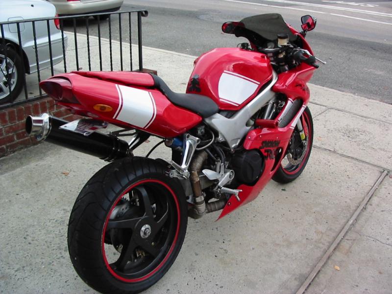

Or you could do an undertail and change the whole look,
You can also cut out the plastic in the subframe and use sheetmetal to make a big "trunk". Mine can hold a 4ft chain & lock and tools under the seat.

Nice looking bike SmokinJoe!
I want to tidy the back of the bike and fix a 7 x 5.5 number plate [I can get away with it here in Spain] but I'm a little worried about butchering the rear of the bike and being unable to return it to it's original state
