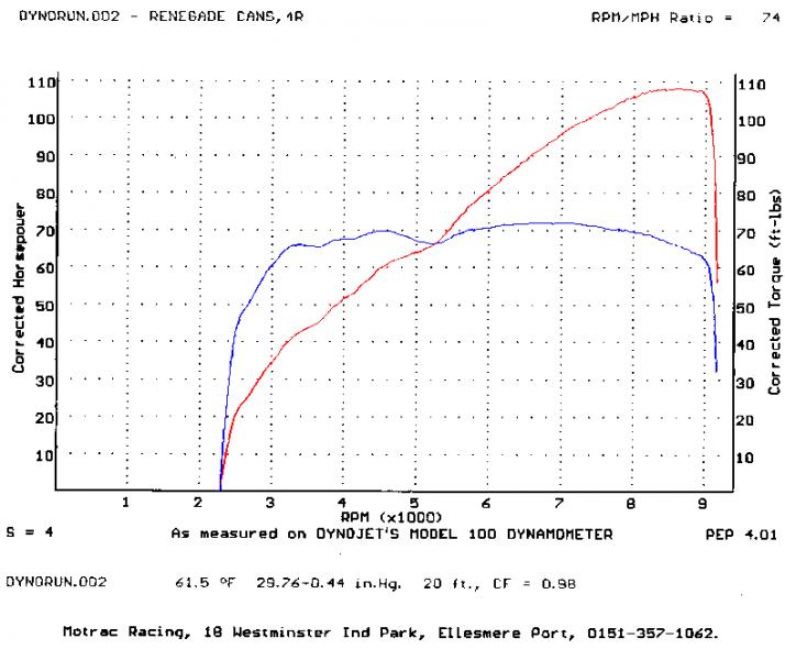

What the hell are you talking about? Saddle bag in the power curve....really???
Here is a pretty much standard VTR dyno chart..... if there was some kind of "saddle bag " or whatever how come there is no dip in the power curve??

And your gearing recommendations have been covered on this forum quite thoroughly. While some my like it all you really do is make 1st gear unusable and turn you 6th into the same ratios as a stock geared bike in 5th....
Also Vortex make the worst Al rear sprockets on the market..... well unless you like sprockets that wear out in 4k miles.....

Attachment 12337
You don't see the drop in torque and the corrisponding lag in HP increase around 4.5 to 5.5 RPM? I do. However, it's so small, I doubt it would even be felt/noticed.

I've been looking at HP/Torque curves for only 20 years or so, so maybe I'm a little green, but I've never heard of a "saddlebag" mentioned. A dip or flat spot? Actually, in my opinion, the SH has one of the very best torque curves I've ever ridden. Properly tuned, there is no dip to speak of. And I hate seeing gearing advice to solve possible tuning issues. It's pretty easy to have a plugged jet, wrong float height, gummy carb, gasket leak, vacuum hose problem, etc., on a 12 year old bike, regearing or slapping a new ECU on it would be a waste. Problem will just move to some other rpm. And I have had bikes with this issue, '95 carbed Ducati 900ss is one.
Ummm did you read the post I was replying to? It was stated that the dip was in the 3200 -4800 rpm range and was referred to as a built in cut in power in the ECU for some type of emissions control.
As for the very small dip or leveling in the chart posted, well it's not my bike or chart so I really can't comment on it except to say that I agree that you would not be able to feel it.

The slight dip in the power curve that I see (with D&D slip-ons and a Factory Pro jet kit on a 1998 VTR) is actually not located between 3200-4500 rpm, as I state in my first response to this thread, but the slight dip actually resides in a narrower range of ~3500 to 3750 rpm at stock gearing (520 conversion, 15-/44-tooth sprockets), in fifth gear. It seems to be most pronounced at around 3700-3750, and there is no issue at all at 4000 rpm and above. As msethhunter notes, it's not that big of a deal, because it is a very slight dip in power, but it is there. (It might be something specific to using the D&D slip-ons, as D&D's are not very restrictive, i.e., are very loud cans. If so, it might be a moot point, since D&D no longer lists the VTR1000F in its drop-down menu of Hondas for which they offer slip-on exhaust.)

Well the change in 2001 is that they put a bit more advance into the ECU. They did this to compensate for the smaller cams they started using that year.
Now for the dip you are seeing. It happens right when the carbs are transitioning from the pilot circuit and onto the mains.
From my research this is caused by the front slide opening too soon. Now Moriwaki & HRC came up with a way to deal with this issue and I explained it all in the carb set up thread.
The issue could also be caused by the needle profile. As I have never used a Factory Pro kit, I can't really comment on that.
Changing the gearing does nothing but mask the issue and is a band aid fix at the best and has many draw back associated with running it.
So IMHO what you are seeing is a carb issue not an ECU issue.
Now for these ECU's that you have been talking about, could you post a link? The only replacement ECU that I have ever seen is the HRC unit and it is only for the '97- '00 bikes.
As for the carbs, I have not seen any difference between the model years. I've done a fair share of carb work on these bikes and if someone can show me what is changed, I would be happy to hear it.
So in closing, IMHO what you are seeing is a carb issue not an ECU problem.
I did, thats why I stated the RPM range where it shows man. Chill. Don't be so defensive.......
If you read my post, I was agreeing with you in a round about sort of way. Remember reading this line?
"However, it's so small, I doubt it would even be felt/noticed."
