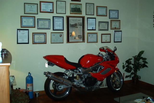

Here's my superhawk
I have owned it for 3 years, I bought it in NC, near Fort Bragg, and brought it back to Shady Spring, WV. Everytime that you de-accellerate from 3500+ rpm's it backfires out of the exhaust (flames included). I though it needed rejeted because of elevation, so I took it to the Honda dealership last January for a re-jet and they had it for 4 months (not kidding) The said the took the carbs apart a crap load of times, The said its as close as we can get it, but its NO better. They also said something was broke (choke related) and now the choke slides back in while driving. Is it susposed to do that?
The guy I bought it from SAID it has a jet-kit, hot cams, K&N filter, two brothers exhaust, dry clutch, CF brakes, the cabin canister was removed and SS brake lines (you can see the rest).
I am not even sure what "Hot Cams" are but I am guessing varable timing
Any ideas how to stop my backfires so I can keep the guts of my mufflers?

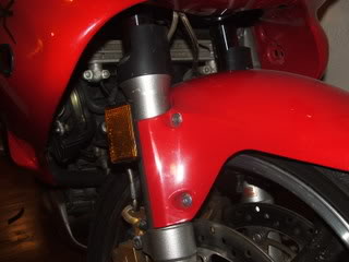

Oh yeah its susposed to have some sort of CBR front forks, what all type of CBR's front forks could they be from?

forks look stock from here.

I know there not off a 954 because there upside down

Take a pic of your forks.

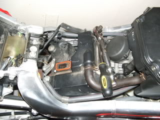

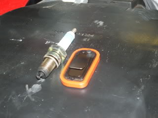

However I got the tank off, my reed valve was facing down, it has carbon all over it, and my plugs looks like super rich. I bought new NGK's, to remove the whole system do I need to take the air box off? Do I remove the front valve though the wheel gap? What do I do to the reed valve now?

ANd here's that front fork shot someone requested, are they OEM

I read greg's thing and tring to figure out .. when I take the copper thing off and flip it over, do I put it in upside down too?
Old Mar 11, 2007 | 06:57 PM
Okay, on the back side of the valve you need to file/grind off the peened over part of the screw. Now carefully remove that screw. It's a tight bugger so be careful and use a good screwdriver. Once it's off you want to flip the reed stop. This should serve to hold the thin reed in place and not allow it to open. Now put the screw back in with some locktite and put it all back together.
If you're going to remove everything please see the article on my website as it's too much to post here. Short answer: yes, you have to remove the airbox.
Old Mar 11, 2007 | 06:58 PM
Copper thing? The valve will only go in one way. All you're doing is flipping the reed stopper.

I got that done (including the loctite) Got the air box off and the Pair valve on the floor. To do the front, I do though the wheel well?
Old Mar 11, 2007 | 07:59 PM
Yup. No need to remove anything in front.

NO popping no Back firering, it would have only taken me an hour but I removed the whole system and had to get caps for the lines, you could do the front one in like 5 mins, just cut the wheel and remove the 2 8mm screws then pop the vavle out and flip over the reed stop (its the part you can see sticking up in my shot(2nd page) with the plug) and on the rear one you can see easly where is at in my first shot (2nd page) becasue the bright orange seal
