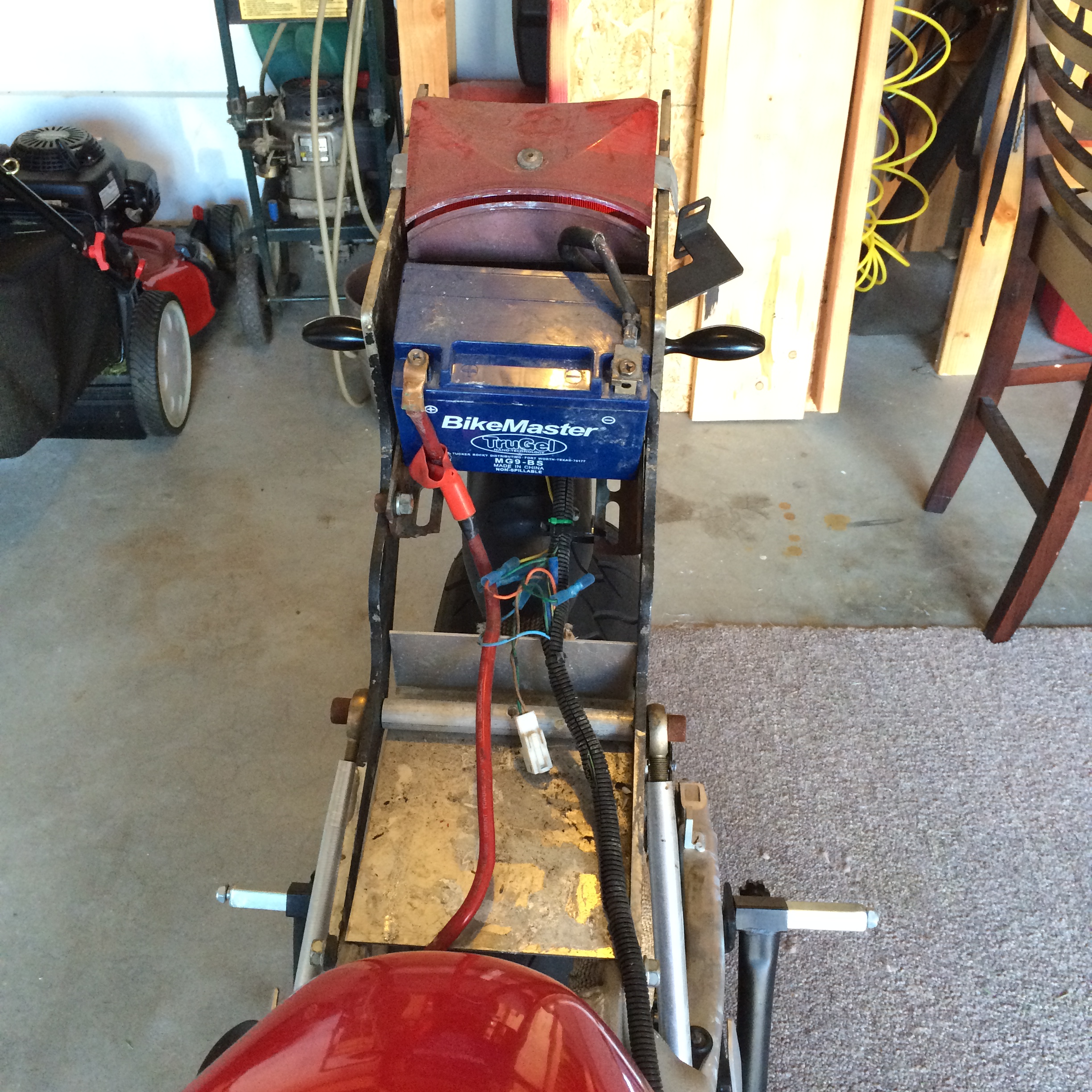

A while back I picked up this project. I don't remember the details but somewhere in the bike's life it lost its rear subframe and someone cobbled one together for it. Two pieces of 1/4" steel, a couple heim joints, some threaded rod, and there you have it. The seat was pieced together out of the rear seat cowl and what, I'm assuming, was the hacked up stock seat. I actually rode it like this for a summer until it was stolen (and eventually recovered) and believe it or not, it's pretty comfortable. So that's the backstory.
My first question, in two parts, is on the subframe. First, I've toyed with the idea of picking up replacement parts off Ebay and returning it to stock. Except I'm not really sure exactly what was there before, parts wise.
On the other hand, I really like the more aggressive look of what's in place now. Part of me wants to clean up the existing "subframe" so that it doesn't look like such a duct tape and bailing wire job. I've also toyed with the idea of swapping out another tail. I've seen gixxer tails, 1000RR, F4i's, etc.. Any ideas or thoughts from personal experience? I'd love to hear suggestions if you have them and/or reasons the existing subframe might be a poor idea in the long term.
My second question is the exhaust. I have no idea what's on there now, but I like it. The mufflers have a great sound and I like the aesthetics of them too. This might be a dumb question, but I have no idea if Superhawks are sensitive to the wrong exhaust or if you can just run anything as long as you jet it right and it isn't too loud.
For my other exhaust question, is there any reason the front cylinder can't be run under the bike and then up in front of the swing arm, and then up under the tail? Also, is there any up or downsides to going 2 to 1 on these bikes?

first of all, run whatever subframe and tail youd like as long as it can support you and a passenger if you ride 2 up...
secondly, the exhaust.... it can be cleaned up as it is, it looks like 2 equal length pipes (true dual). However, these bikes like a crossover dual and dont like 2-1. If you have access to a dyno you can jet to make these work(if they havent been dyno tuned yet)
I've toyed with the idea of a true dual but havent attempted it yet...
can you weld? in which case this bike is your playground

I think a Gixxer 1K tail would look ok but mixing a curvy front fairing with one with straight edges at the back could look odd.

From: Central CA
D 98 05 Honda VTR1000 Superhawk Rear Subframe Sub Frame 100 Straight | eBay
Original parts are pretty cheap.

Thanks, I considered that route. If I return it to stock I'd need the subframe, rear fairing, seat and what else? Like I said, since it was not stock when I got it, I don't know what's supposed to be there.
