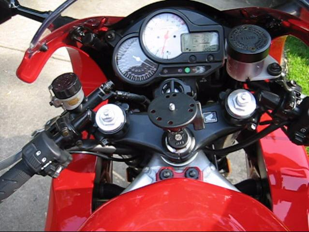

To answer--Yes and Yes.Here is mine with a camera mount.You will have to modify the plug in the kit for the stem.I made up a new one out of softer rubber.The one they give you is more like hard plastic.Could not get it to swell up and tighten properly in stem.
I heated the rubber/plastic up with a hair drier just before inserting into the stem (black cover just pops out) & used contact adhesive; stays put.

Here ya go.Ram Mounts are a good product.The ***** are rubber coated.once you snug up the arm-things stay put.http://www.gpscity.com/ram-mount-mot...be=91fRWdWb5mY
