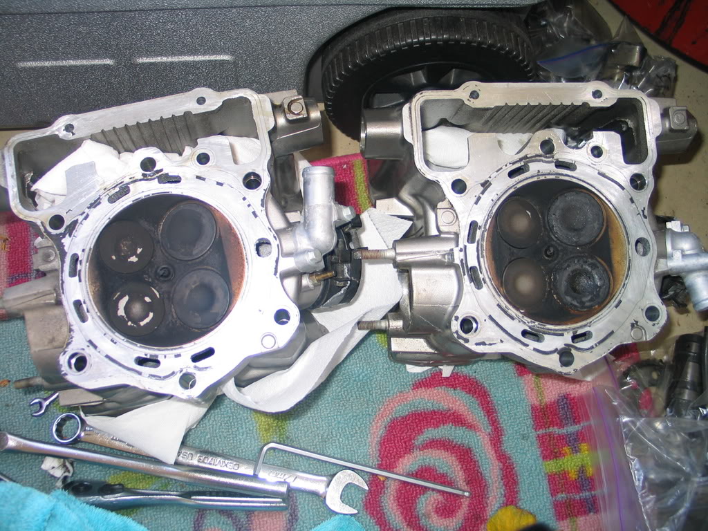

Here is the start of my project.

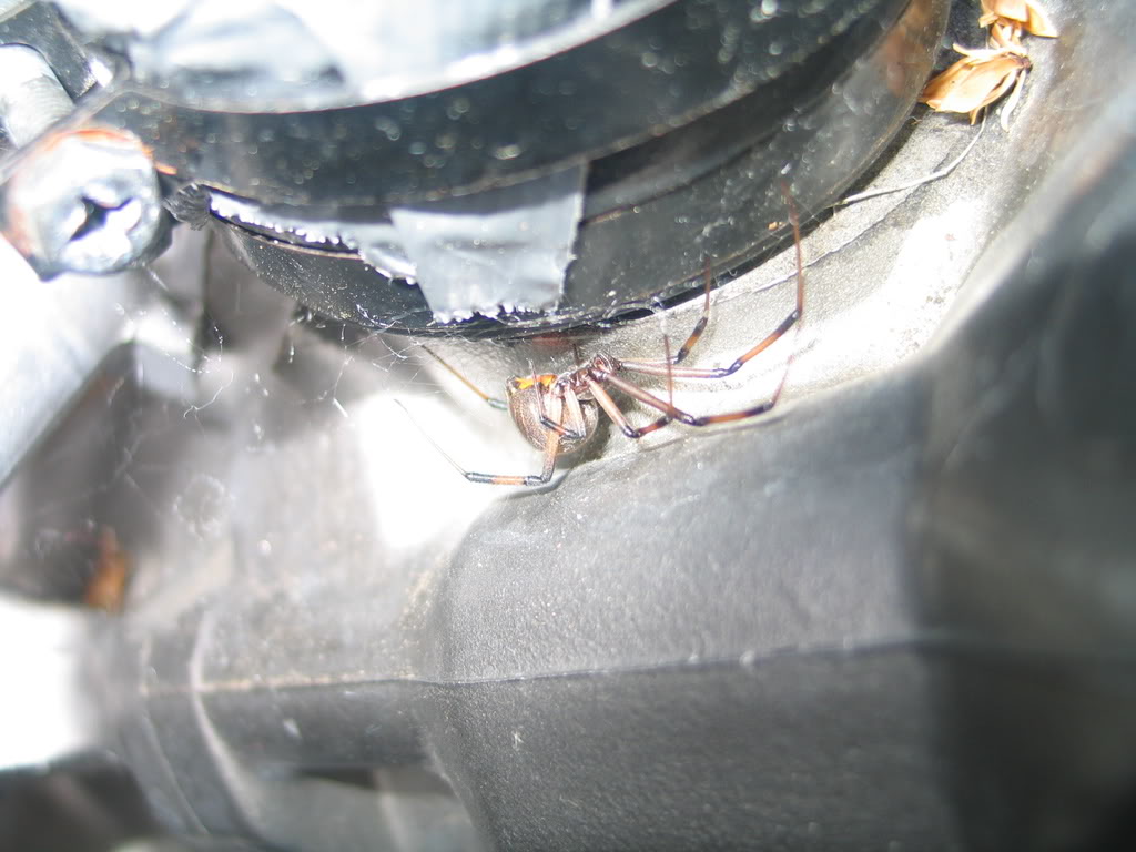

Glad Tapatio didn't charge me extra for the giant Black Widow living in the exhaust port.

So far the cylinders look good no ridge on the top, funny thing is the rear CCT (stock Honda) the tip was all smashed over. don't know what that was about.
I will be ordering Mori cams as soon as Bill gets back to me, I need to get the case split to see what bearing is spun, then take it to my engine guy to check for out of round before I purchase HC pistons.

Yeah, those black widows love inactive vehicles. And they find the deepest, darkest recesses to crawl into.

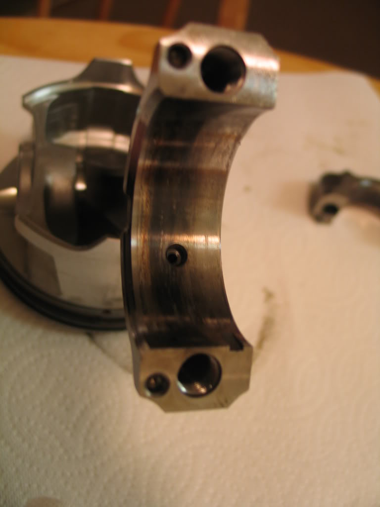

Finally got the cases all split this weekend. Crank connecting rod journal was the culprit.
The journal doesn't feel gouged with a fingernail just scorched.
I need to have it reground and polished.

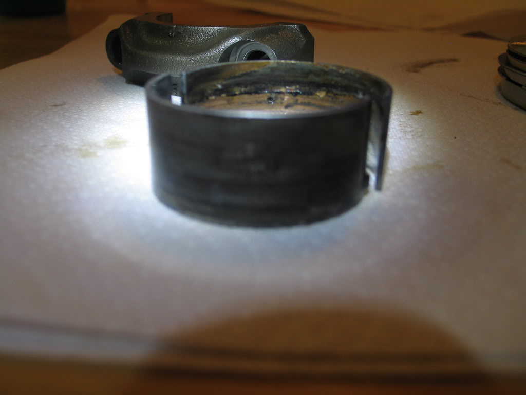

Did the bearing spin in the rod, or did it just get close?
Old Mar 5, 2009 | 07:05 PM
zmaniv's Avatar
Posts: 916
From: San Diego

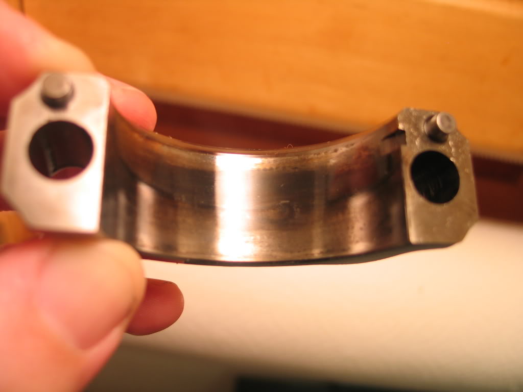

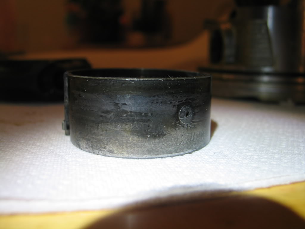

From all the discoloration in the rod and on the outside of the bearing I think it spun inside.

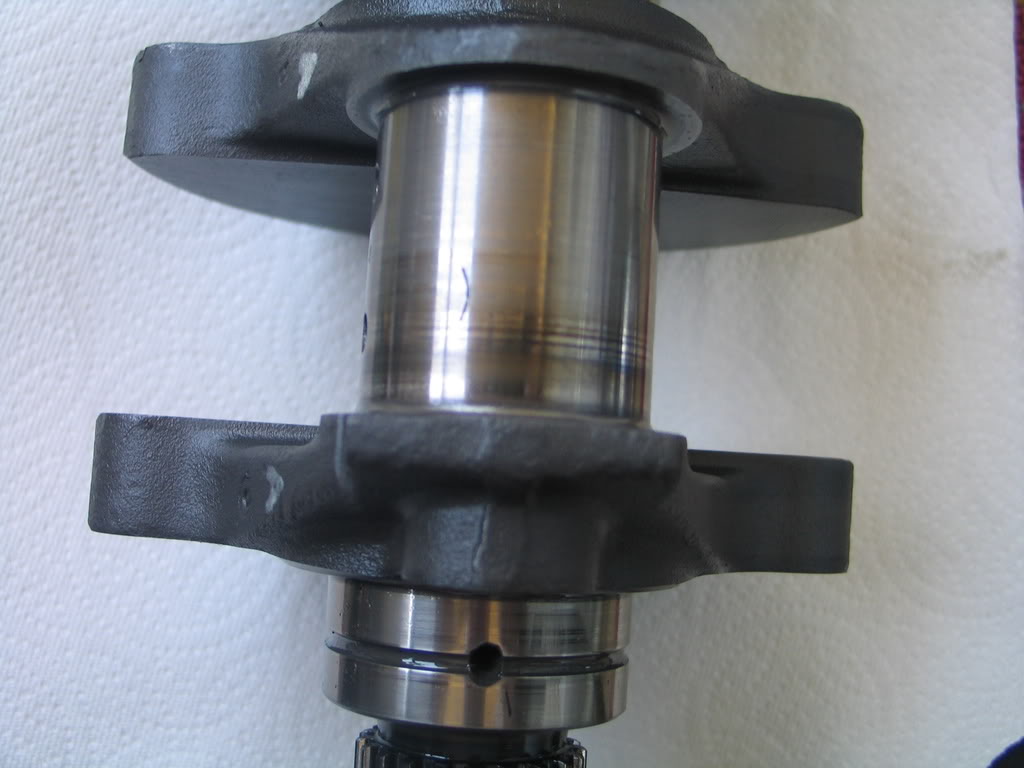

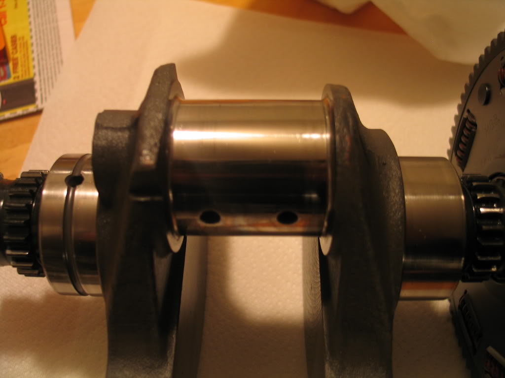

Crank all polished up Name:  011.jpg
