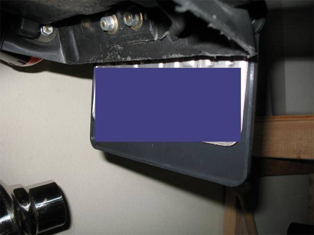

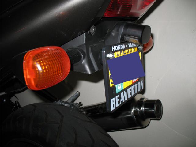

The guy who owned my bike ahead of me did exactly that, cut it down. Not sure of the exact procedure, but here are a couple of pics to help you out.

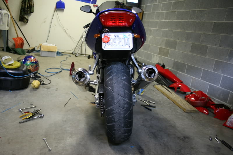

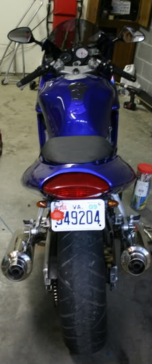

I took my dremell, and cut it off about an inch or so below the lock and drilled new holes for the tag. Then I took my dremell and cut a section out of the bottom side of the tail light and epoxied a clear piece of plastic in place to make a tag light.
I purchased turn signals off ebay that bolted to the tag

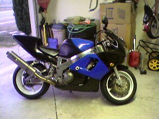

go to airtech or shark skinz and buy either the rc51 or the cbr race tail for it. then put LED brake and turn signals on it, mount your plate flat up under it and it cuts out that ugly tail light section. here is a pic of my cbr, you can see the tail i am running on it.
