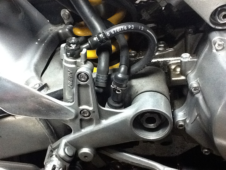

can anyone post some pics of thier switch while its mounted on the bike. I have recently lost my brake light from the front and rear switch. I even think the brake light is staying on. ive unplugged the front swich and made sure the plunger wasnt stuck in. but im unsure of the way the rear switch is supposed to be mounted (something about mine doesnt look right). thanks in advance

Sure man, I'll go take a picture quick. Give me five minutes.
Edit:
your the man!

You check the fuses? What rear light do you have, stock or aftermarket (LED)?
Edit: Did that picture show what you needed?

I have an LED tail. And yes! That pic says it all. I'm going to work on the issue tomorrow when I get released from work. Will update on everything then! Thanks again!

thanks to your pic, i did indeed figure out that my brake switch was sitting in the hole wrong. it was causing my brake light to stay on continuously. a simple adjustment and, BAM! problem solved! thanks man!
Old Sep 13, 2013 | 08:27 PM
Glad you got 'er fixed and to help another Superhawk get back on the road!
