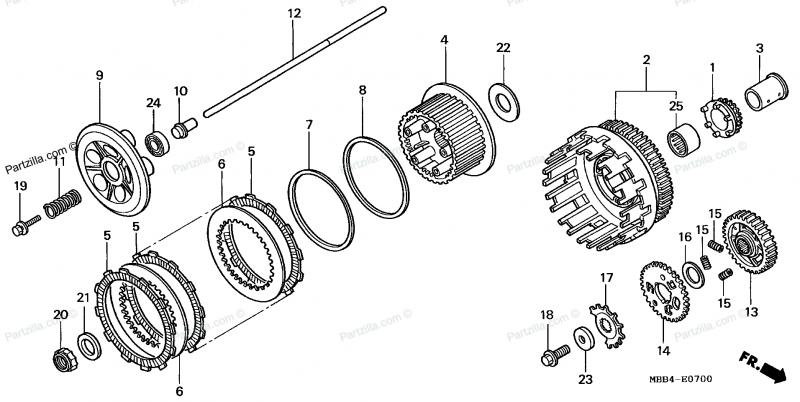

I installed new clutch kit (springs and disk). Everything seemed to go fine...At about a quarter mile into first ride with new set a loud clanking noise started! what did I do wrong. I soaked the plates before install, I place the new plates in the same way the old plates came out... Could the new plates be the wrong ones? I ordered EBC kevlar plates from EBAY. The springs came with the plates. Maybe I should put the old plates back and see if the " clicking continues? SUPERHAWK DOWN! SUPERHAWK DOWN!

.. ok so lets make some terms clear so all can talk about the same parts.
Clutch disks.. drive and driven plates not "brakes and pads"
the steel plate (#6) is the drive plate
the fiber plate (#5) is the driven plate
See the inner most driver (fiber) plate in the clutch stack? nearest the motor..That one has a larger inner diameter,, so it fits over the anti judder springs (#7&8)
and the judder spring must be installed correctly.
The flat spring seat goes on first, then the cupped judder spring on next (see below pic, lower right corner)
Lastly, some aftermarket clutch disk kits (fiber / driven) do not use the OEM judder spring.. what you'll find is all of the driven disks have the same size inner diameter ..

I think I have that judder spring wrong! But thats the way it was when I opened it...Well I going to open it again.

Here's what happen... Bike was lagging on acceleration. I thought it might be the clutch's because it was slipping out of second gear also. Whamo! I change facings (not plates) and springs. close everthing up and ride approx. 5 city blocks. Clanking starts I immediately turn off bike and coast home. I opened bike again this morning and saw nothing. (sorry for leaving out these details your patience is appreciated) Now I see your diagram and I think I put that judder spring in the wrong place. (there was only one though when I open it up)
