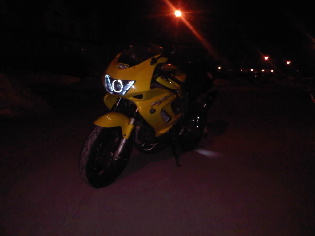

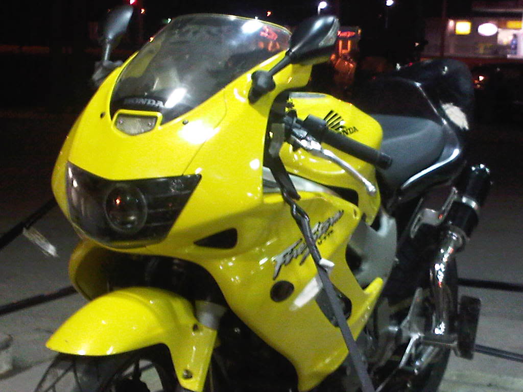

just to add a little, johns work

OOOOOH, I like this. Looks cool. Thanks for the pics.

no problem, thats changed since then. i removed the leds and changed projectors. that single we used wasnt the best quality, used unit that came from a car and the bulb we had in it was crap aswell. bulb from my old plug and play setup. my new setup is fantastic. and bi xenon. and yes you need bi xenon especially if youre doing any kind of agressive night riding, once you lean that bike over you cant see through the corner, you need a high beam with no cut off line for that.

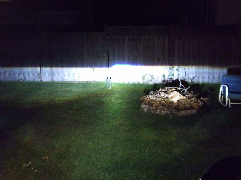

my complete setup in parts cost me $180 from the retrofit source. thats a bi xenon projector, morimoto ballast 5000k d2s bulb and harness. i put it in myself in a couple hours. not that hard to do. works great and its all plug and play. although im gonna run a relay to it for the new year as i was having some issues with my high beam coming on at times. heres what my low beam, looks like
Old Dec 19, 2010 | 08:35 AM

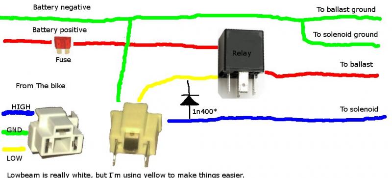

Uchi, the highbeam not coming on has nothing to do with a relay or not... I'm guessing you are running it at lowbeam and then going to highbeam and it goes dark?
If that's what's happening it's because the ballast gets a "hot-start" ie you cut power and flick it on again when going from high to low... That's easily cured with a diode between the supply lines keeping the ballast powered during the switch... But relays are a good idea anyways...
Here's a wiring diagram for wiring it up on the VTR the correct way...
