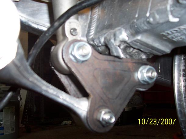

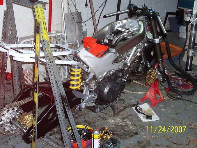

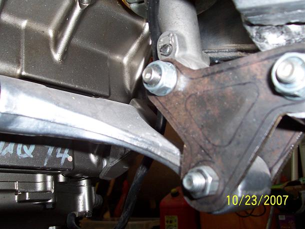

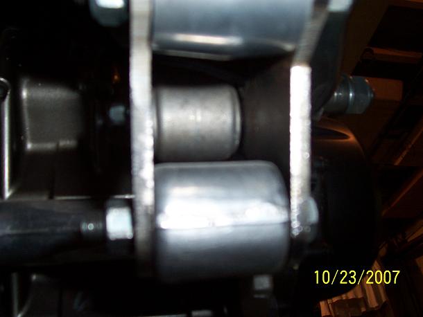

heres mine so far.
Attached Thumbnails Post pics of your swingarm conversion..-shock2.jpg   Post pics of your swingarm conversion..-shock3.jpg   Post pics of your swingarm conversion..-shock1.jpg   Post pics of your swingarm conversion..-assembly.jpg

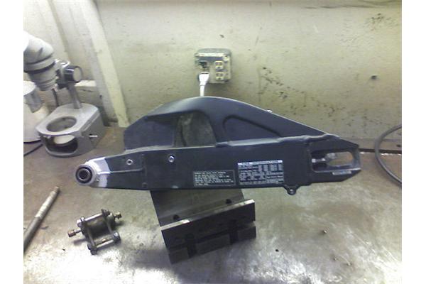

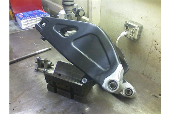

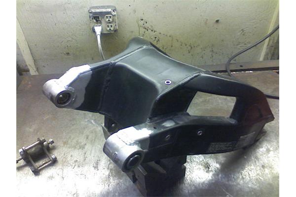

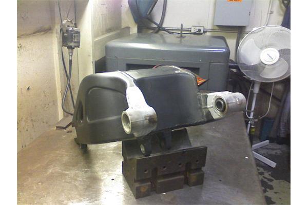

Here's a cuople cks of the RC51 SP2 swingarm shortened.
Attached Thumbnails Post pics of your swingarm conversion..-0928071820a-600x400.jpg   Post pics of your swingarm conversion..-0928071821a-600x400.jpg

Couple more pics
Attached Thumbnails Post pics of your swingarm conversion..-0928071820-600x400.jpg   Post pics of your swingarm conversion..-0928071821-600x400.jpg

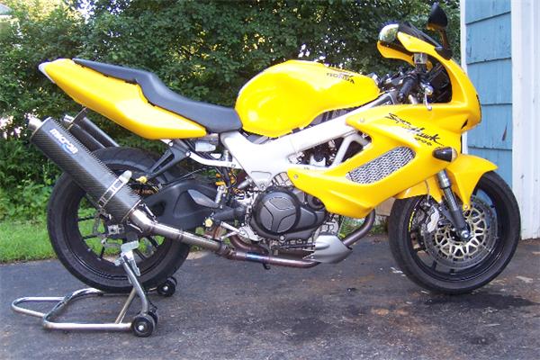

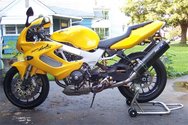

Here's a couple of pics of it on my bike.
Attached Thumbnails Post pics of your swingarm conversion..-100_0541-600x400.jpg

one more pick
Attached Thumbnails Post pics of your swingarm conversion..-100_0540-600x400.jpg
