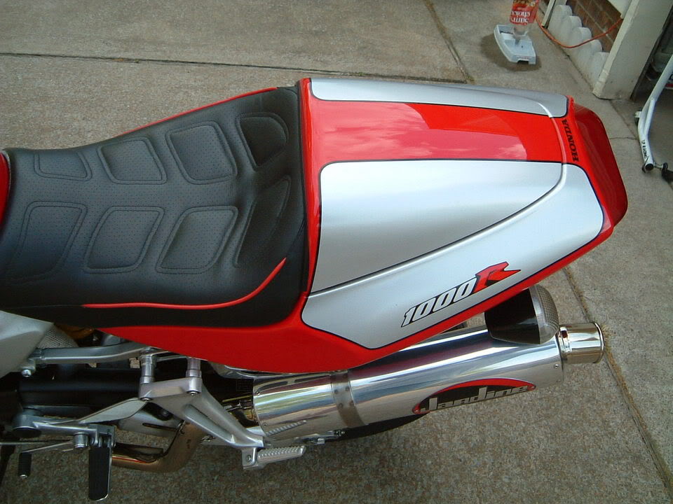

It looks gorgeous and comfy, more saddle shapped than the flatter Sargent.
BTW - I can't believe that you did those decals from scratch (I believe it, I'm just amazed). The black pinstripping around the edge just smacks of a professional "machined produced" touch. If I was wearing a hat, I'd tip it to you.
BTW x 2 - you should post your bike pics in the "Members Rides" section.
