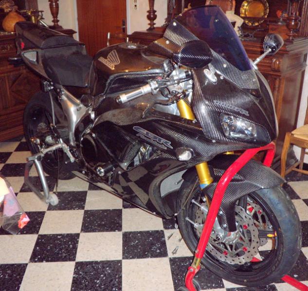

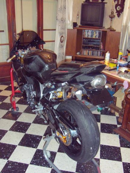

Here is my second bike, some parts i've changed on this bike are going to be on the VTR front and wheels.

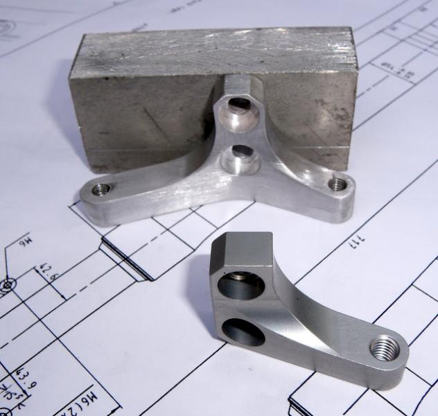

A parts of my job on this bike, i need to make front fender bracket to converted Ohlin's fork 08' to cbr front fender 07' I do it by hand. Ohlins parts 07' dont run and it's too expansive.

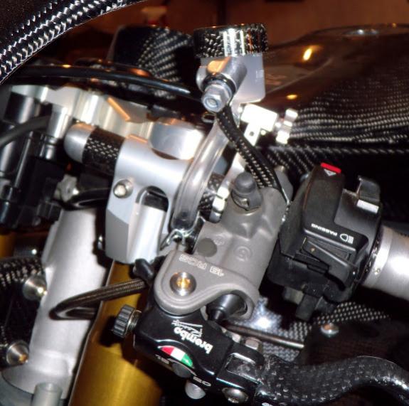

Reservoir bracket, handle bar end, micro switch bracket in carbon fiber hand machined.

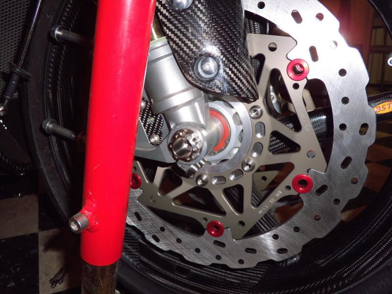

CBR 1000 08' Ohlins fork with bst wheels, mettec titanium axle, Axis Stainless rotor, Axle bolt titanium custom maded to put axle in order (17 m/m longer) spacer under rotors ( 2.5 m/m)are not finished and i'm waiting for brembo's cnc caliper.

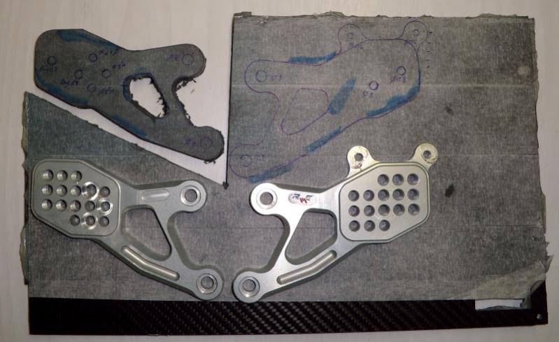

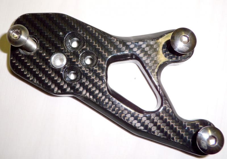

Robby aluminium rear set are modified, i make parts in carbon fiber 14 m/m thick.
here you can see insert titanium for footpeg bolt, and aluminium insert for the axle, bolts are titanium MCET, i've put on gloss varnish.
That's all for this time

Here it is, my project is ok now, so i can work on the vtr !
