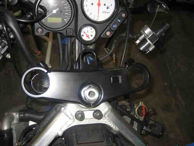

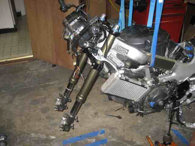

Hey all....

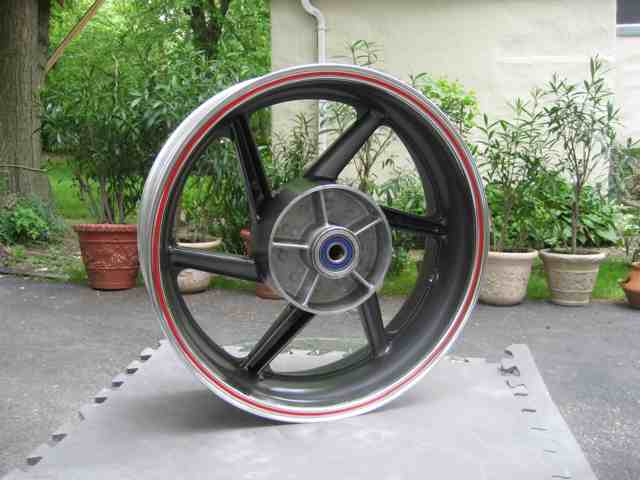

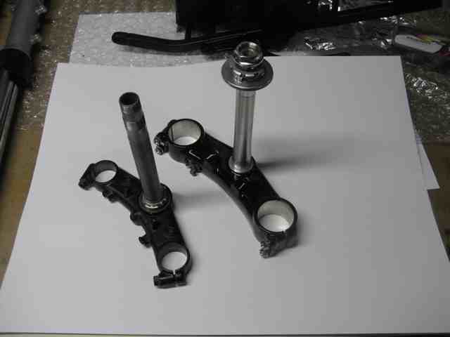

Wated to post up the modifications I made this winter.... ahh.. spring.... ahh... summer.... yeah, trying to do alot of work with a newborn will cause your winter mods to last untill August!!!! Here's the list of things I changed.... I did all the work with exception of mounting the tires on the rims...
RC51 Front forks (Racetech Springs), upper triple, brakes
929 Lower triple
Ducati 900SS Heli Clipons
RC51 SP-1 6-spoke front wheel
CBR 900 6-spoke rear wheel

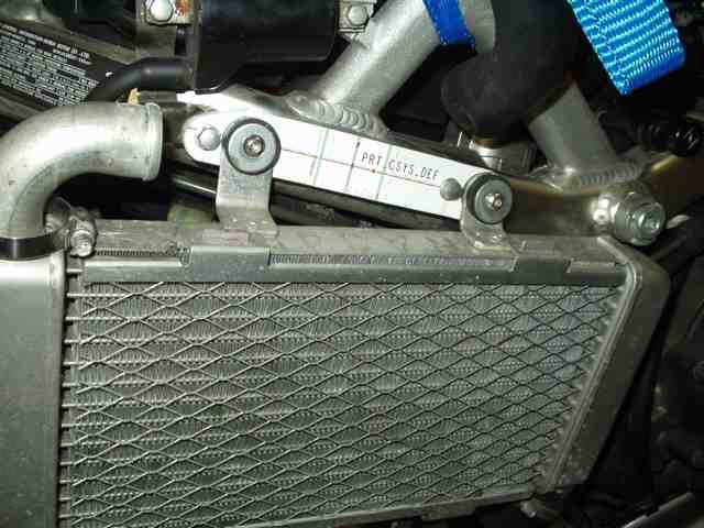

Relocated radiators for steering clearence
Jardine Hi Mount Exhaust

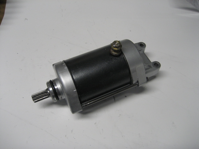

Jet-Coat ceramic exhaust coating on headers and mid-pipes
Powdercaoting of the subframe, starter, and exhaust hangers
Powercoating of a milion little parts
Custom undertail and license plate brackets
Sargent Seat
Probably a bunch of other things.. but I can't rememeber at this point... pics below show some in progress.... some before/after.... enjoy....
**** I just finished it this weekend... and haven't driven it out of the driveway yet... that will change this weekend once it's finally inspected....

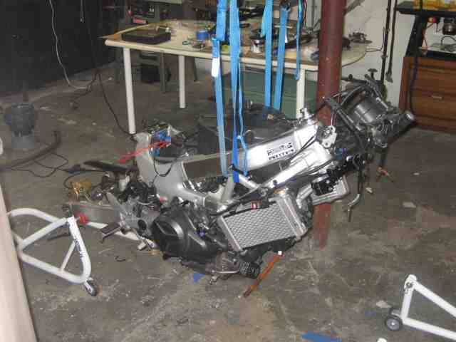

Attached Thumbnails Modifications FINALLY finished....-stripped.jpg   Modifications FINALLY finished....-lower_triple_modified.jpg   Modifications FINALLY finished....-lower_triple_comparision.jpg   Modifications FINALLY finished....-pc_upper_triple.jpg   Modifications FINALLY finished....-forks_on.jpg

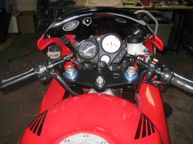

More pics

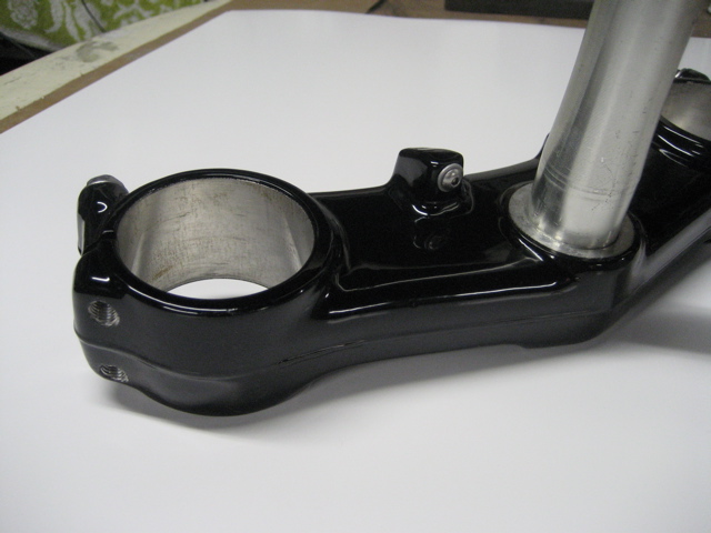

Attached Thumbnails Modifications FINALLY finished....-lower_triple_modified.jpg   Modifications FINALLY finished....-pc_upper_triple.jpg   Modifications FINALLY finished....-clipons_mounted.jpg   Modifications FINALLY finished....-front_end_mounted_up.jpg   Modifications FINALLY finished....-exhaust_starter_dirty.jpg

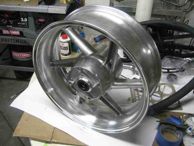

From: Thornwood, NY

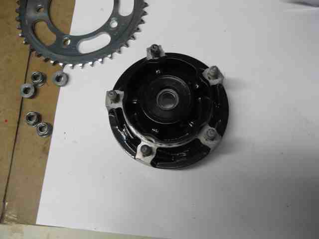

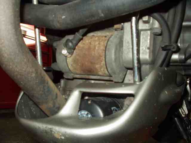

More...
Attached Thumbnails Modifications FINALLY finished....-starter_pcd.jpg   Modifications FINALLY finished....-rear_rim_before.jpg   Modifications FINALLY finished....-rear_rim_after.jpg   Modifications FINALLY finished....-pc_cush_drive.jpg   Modifications FINALLY finished....-exhaust_before.jpg

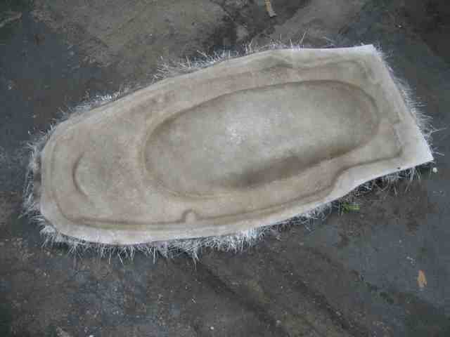

Do you have any pics of that custom undertail with the Jardine highmounts. That is my next upgrade.

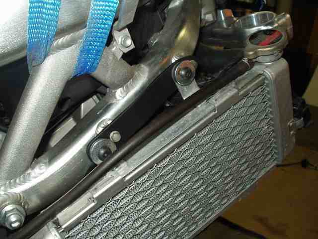

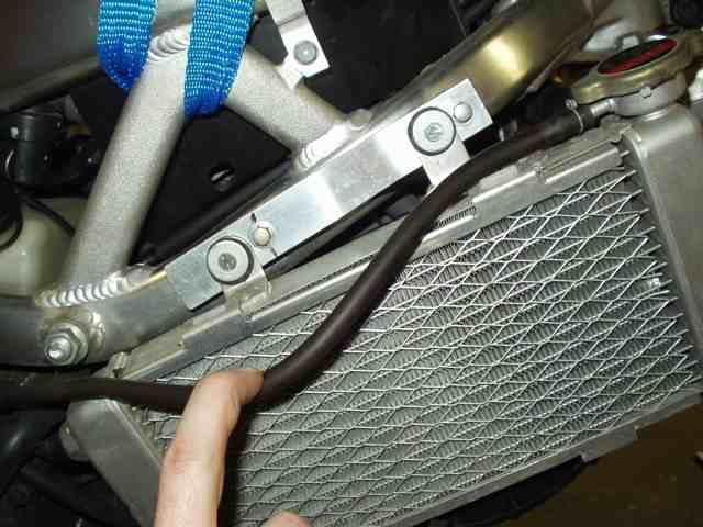

More pics... rads and undertail...
Attached Thumbnails Modifications FINALLY finished....-exhaust_after.jpg   Modifications FINALLY finished....-rad_bracket_start.jpg   Modifications FINALLY finished....-rad_bracket_progress.jpg   Modifications FINALLY finished....-rad_bracket_finished.jpg   Modifications FINALLY finished....-undertail_under_construction.jpg

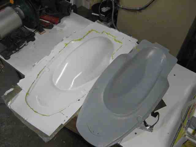

Old Aug 27, 2007 | 09:25 AM
SlowHAWK's Avatar
Joined: Jun 2004
Posts: 818
From: Thornwood, NY

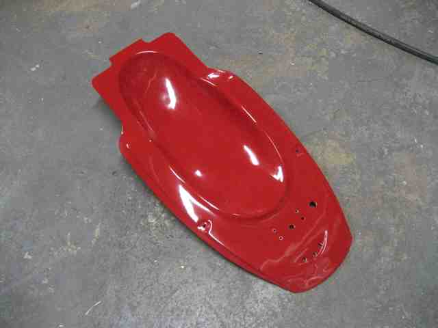

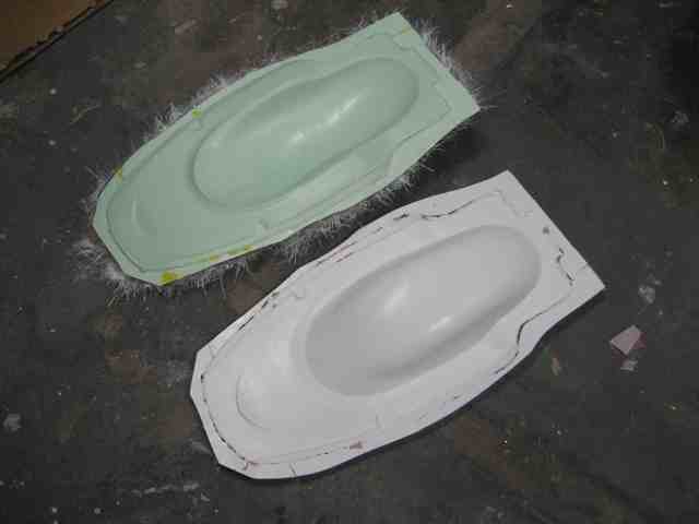

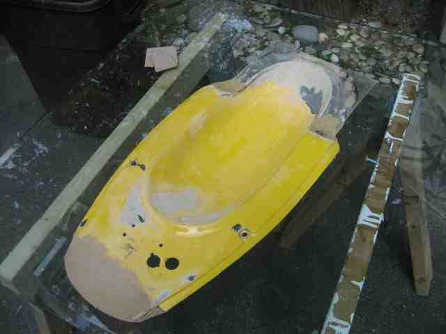

Undertail work...
Attached Thumbnails Modifications FINALLY finished....-undertail_mold_plug.jpg   Modifications FINALLY finished....-undertail_glassed.jpg   Modifications FINALLY finished....-undertail_first_part.jpg   Modifications FINALLY finished....-undretail_painted.jpg   Modifications FINALLY finished....-undertail_mounted.jpg

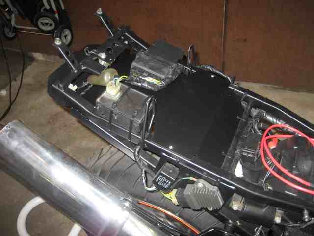

Old Aug 27, 2007 | 09:29 AM
SlowHAWK's Avatar
Joined: Jun 2004
Posts: 818
From: Thornwood, NY

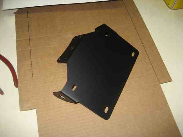

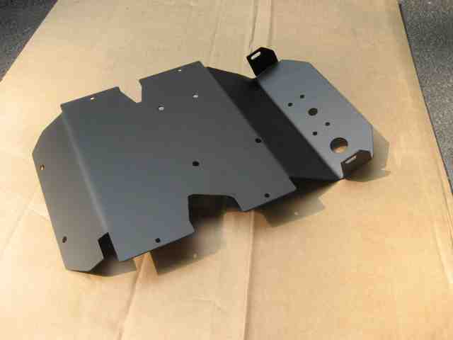

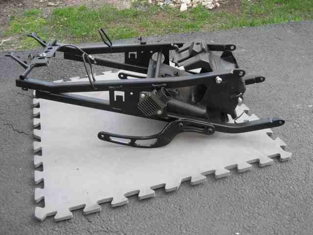

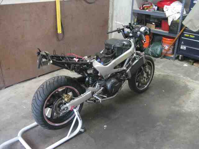

Other pics
Attached Thumbnails Modifications FINALLY finished....-license_bracket.jpg   Modifications FINALLY finished....-undertail_tray.jpg   Modifications FINALLY finished....-undertail_tray_mounted.jpg   Modifications FINALLY finished....-subframe.jpg

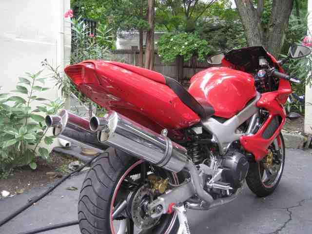

Old Aug 27, 2007 | 09:30 AM
SlowHAWK's Avatar
Joined: Jun 2004
Posts: 818
From: Thornwood, NY

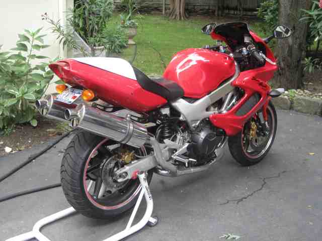

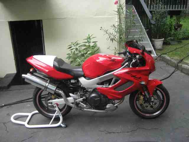

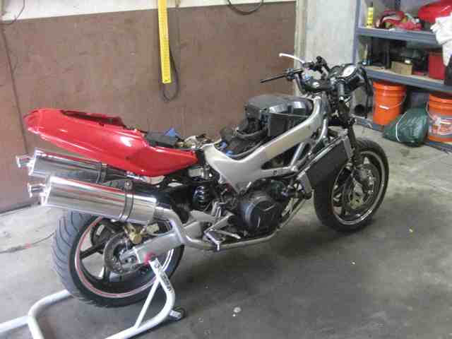

Finally assmenbled...
Attached Thumbnails Modifications FINALLY finished....-rear_finished.jpg   Modifications FINALLY finished....-side_finished.jpg

The fork swap isn't that bad.... mounting the forks/triples up is pretty easy, it's getting all the little things right, like placement of controls so they don't hit anything, making the stops touch before you hit the rads, and all the little stuff like mounting the horn and other bits that drives you crazy.... etc...
J.

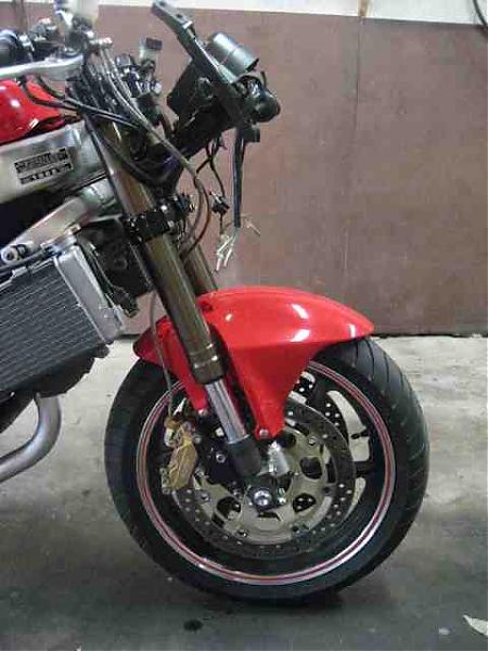

Originally Posted by SlowHAWK
More pics
Slowhawk, nice work bro can you come over and do mine? LOL! I'm gathering parts now for the RC51 swap and it looks like that may be a stocker front fender. Is it a stocker and if so will it bolt to the RC51 SP1 forks?
Thanks,
Rick C.
