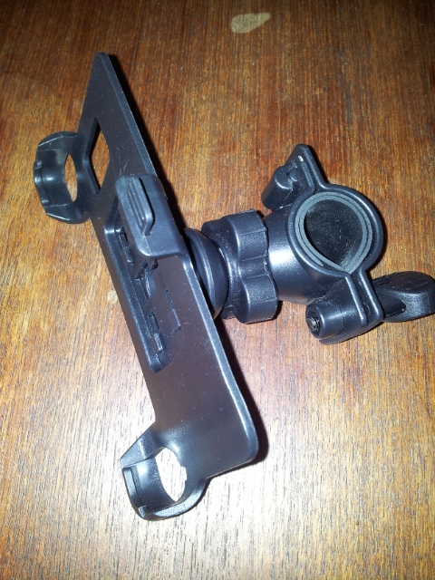

Built my own unit, for pretty cheap, its stood up to 6 months of use, and i've upgraded to the galaxy S3 now, so i bought a suitable holder and the top just clips onto this setup
Bought galaxy s2 bicycle mount for $3.62 posted

the ebay unit - You just buy whatever version will fit your phone!
Rotable Bicycle Motorbike Bike Holder Mount For Samsung i9100 Galaxy S 2 II S2 | eBay
Or iphone 4 etc.. http://www.ebay.com.au/itm/360-Degre...item3cc8f5b5ac
strip it to find it goes together on a m5 thread

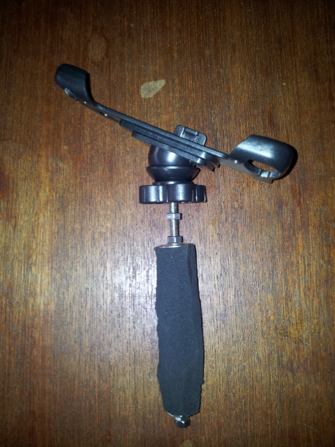

Shaved the rubber down to a rough cylinder and screwed on the bracket bits.

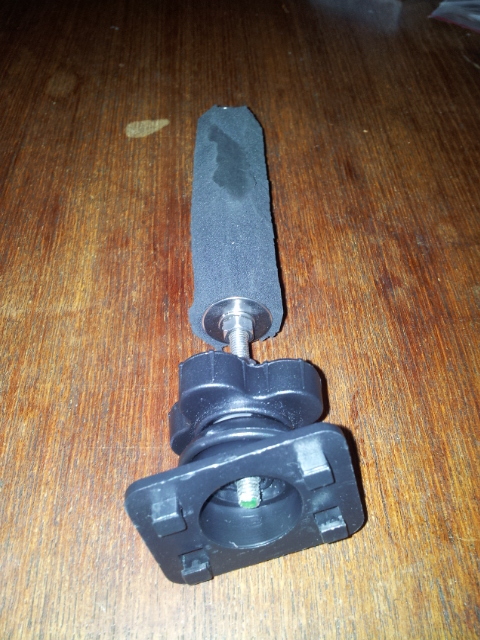

done (i neatened up the rubber a bit after this photo)

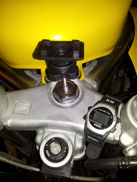

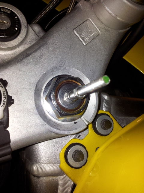

Stick it in the head stem and tighten the nut - This pulls the washer at the other end up, squishing the rubber foam against the inside of the headstem, securing it solidly.

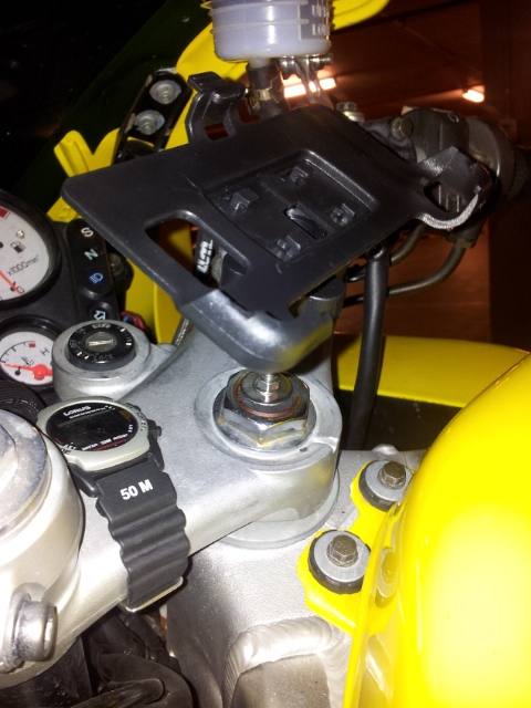

Chuck on the bits again
Done - So an adjustable, sturdy phone/gps holder for $6.60.
Once the top nut is tightened, i couldnt budge it with a set of pliers
