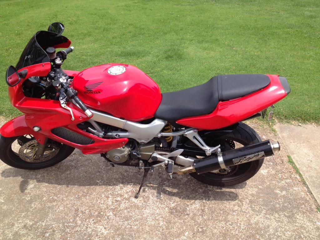

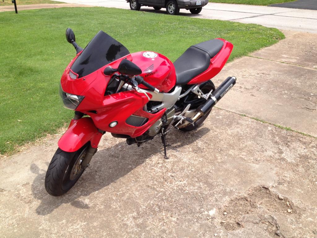

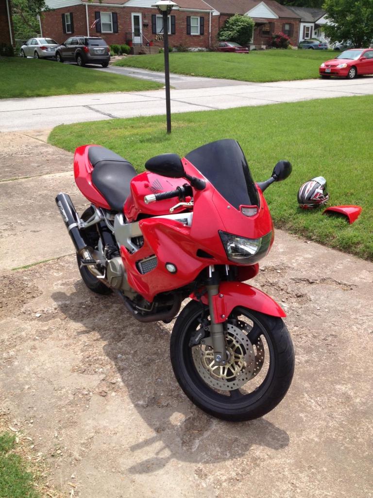

My apologies, re-read the initial conversation, the bike in question is a 2002. Pictures from the seller are attached.

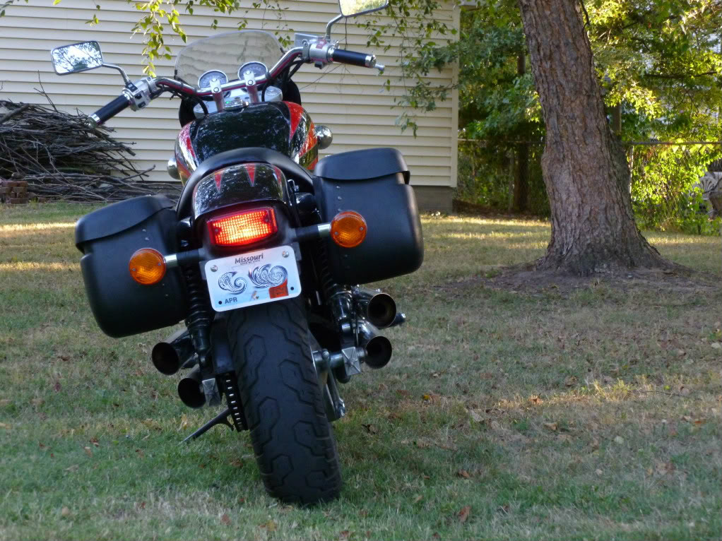

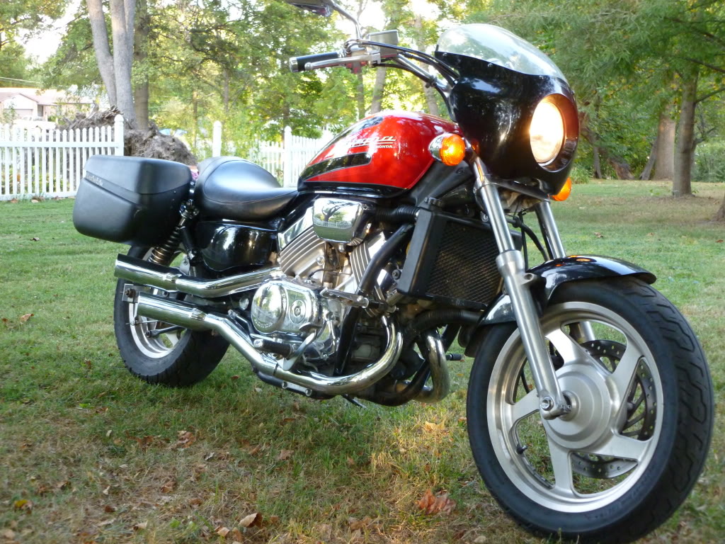

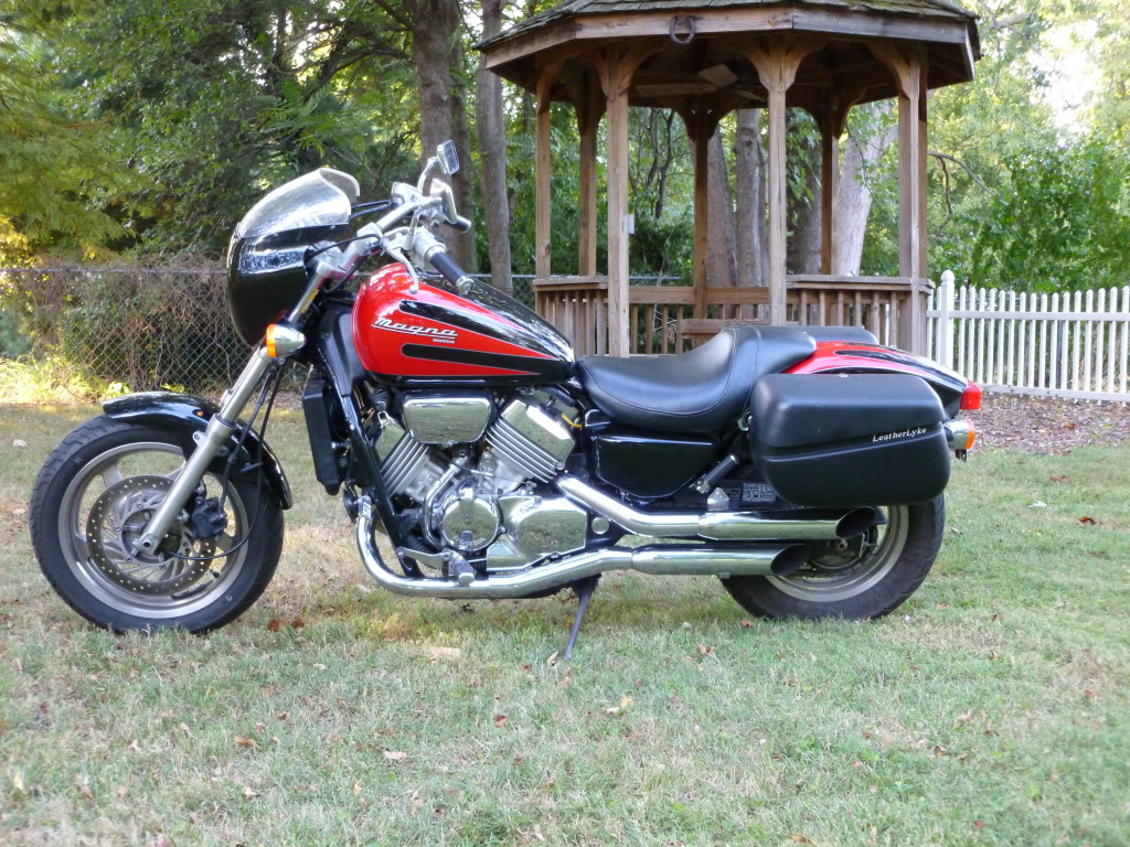

And here is the bike I'll be trading. 96' VF750CD Magna.

I'll have to look in person, but that right hand engine lower looks like it might have some damage to the cover...anyone else see the same? Or more in the photos?

From: Essex, UK
With the decal-less fairing, aftermarket indicators, levers, and bar ends it could hint at taking a tumble. Did the US VTR have decals on the tail? as there are none in the pics.
Try and get a peak inside the plastics for signs of repairs/repraying - look closely around indicator holes as they often crack when they take the brunt in an off.
Has the seller got all the original bits inc exhaust?

Thanks. That was very much along the same lines I was thinking. I've zoomed in on the pictures, but look forward to seeing the bike in person tomorrow. From the photos, you can't see any damage to the mounting tabs/bolt holes but we'll know by tomorrow.
I looked at some photos online, but I don't see any decals on the rear tail section of 02' model bikes, just the front decals which are clearly missing. My thoughts are it probably went down at one point, but the panel alignment makes me think either the damage wasn't bad, or all the panels were replaced. I'll plan to do a thorough look around on the bike, and test ride it to see if everything goes straight and smooth.
There look to be a couple dents at the bottom of the left hand exhaust as well, plus what might be a scrape on the right hand engine case (we'll see...can't tell/confirm).
BTW, I do not believe the current owner has the original pieces. He's never mentioned them, I'll ask him about whatever "crash" it's been in. Not a deal breaker for me, long as the title is clean and the fixes look good...not just pretty, but well done.
