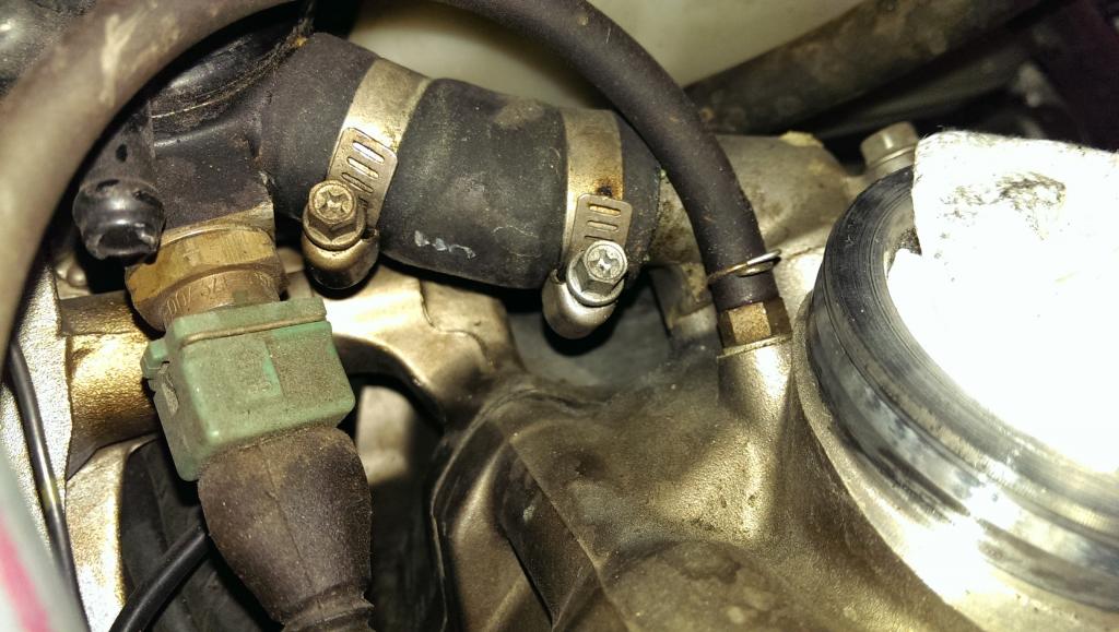

So I need some Superhawk expert opinions, I've been experiencing a intermittent coolant leak on my bike on the riders left side. I haven't ridden the bike in about a month and finally have had some time to tear her apart. I'm hoping that it is just a hose and not a head gasket. Oil and coolant both look normal, so I hope to rule out the head gasket.
The picture below is of hose #12 off the rear cylinder to the thermostat.

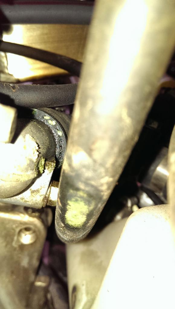

This is looking from riders right side at the same hose, it appears to be a bit wet on the outside of it:

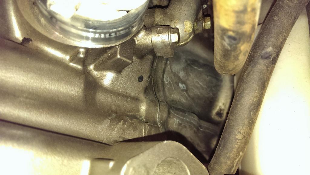

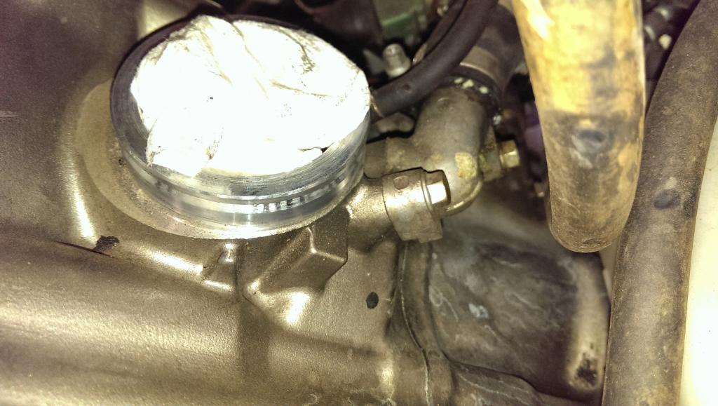

Here is looking down the top of the rear cylinder, showing where the coolant has left stains on the engine:

So do yinz think it is just that hose #12?

Old Oct 25, 2014 | 05:47 PM
YMMV means, Your Motorcycle May Vary.
You want us to look at a wet hose and tell you it's that hose? I think you figured it out already.
Replace the hose and clean the surface where the hose slides onto. There is possibly corrosion under the hose which possibly made it leak.

Just looking for another set of eyes and pulling on the experience of all the others on the forum before I order parts. Good note on the possibility of corrosion. I'll pull the hose tomorrow to investigate it. Thank you.

I checked the hose piece off the engine, no signs of corrosion. Ordering parts now.
Thanks everyone.

I had a similar problem with mine. I figured out that the seal where the hose fitting mated with the engine had dry rotted.
IMAG1234_zps6ce515e8.jpg Photo by toaliosis | Photobucket
the fitting shown here has a small o ring underneath that might need to be replaced.
