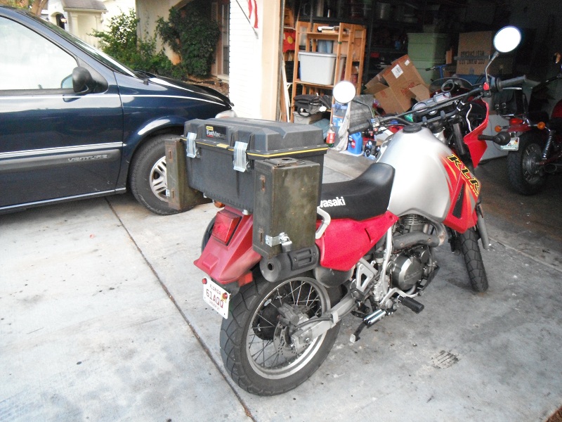

Here's what the KLR looked like before I screwed it up.

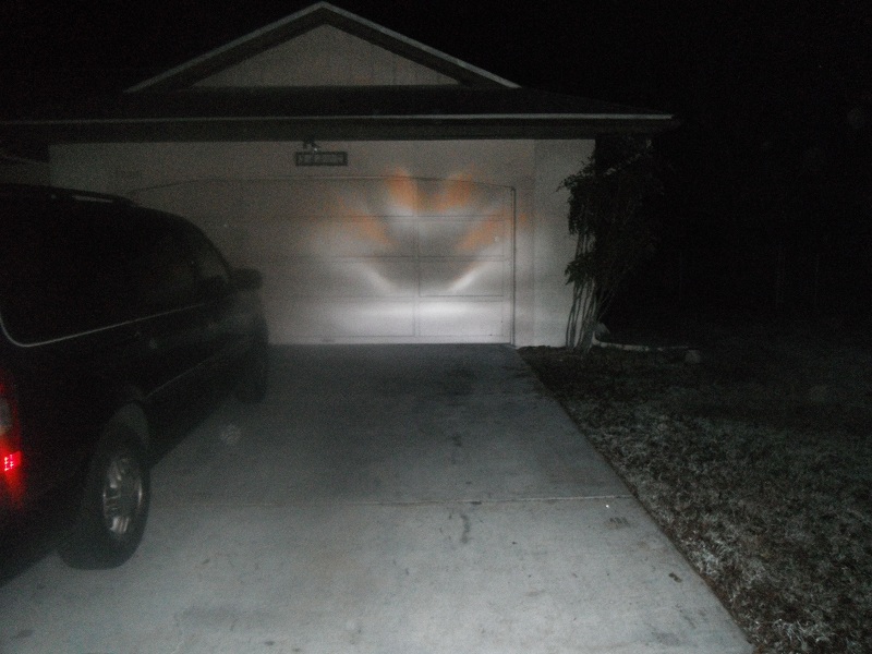

It's just the bulb not a projector, bad wording on my part but here is a picture of how it looks shining on my garage door. I'm sitting on the bike roughly 20ft away.

And that's proof right there... You see those pretty wingshaped light patterns... Those are classic for a HID bulb dropped in a reflector meant for a H4 bulb... That's 2/3 of your light output rigth there, blinding drivers and lighting up tree tops... Very useful indeed...
If you compare the actual light, to the stock bulb... Then you will find that you have more light on the ground far infront of you with the stock... The HID lights up the ground close to you, which is useless unless you are riding around in first or second gear and idle, and it lights up the tree tops, which might be usefull if you are going hunting for birds perhaps... Other than that, it's crap...
Spend a few dollars, and buy yourself a relay harness for the H4 bulb, and then drop in a high quality bulb... It will improve the visibility, not the cool factor... OR, get yourself a HID projector... That does both...

I just want to say that I do see what you mean about the light and even saw how it could daze oncoming traffic so I've put a HID projector retrofit on my list of todo's, just after some MCCT's and a new chain and sprockets. I'm thinking I might put the stock bulb back in for now.
