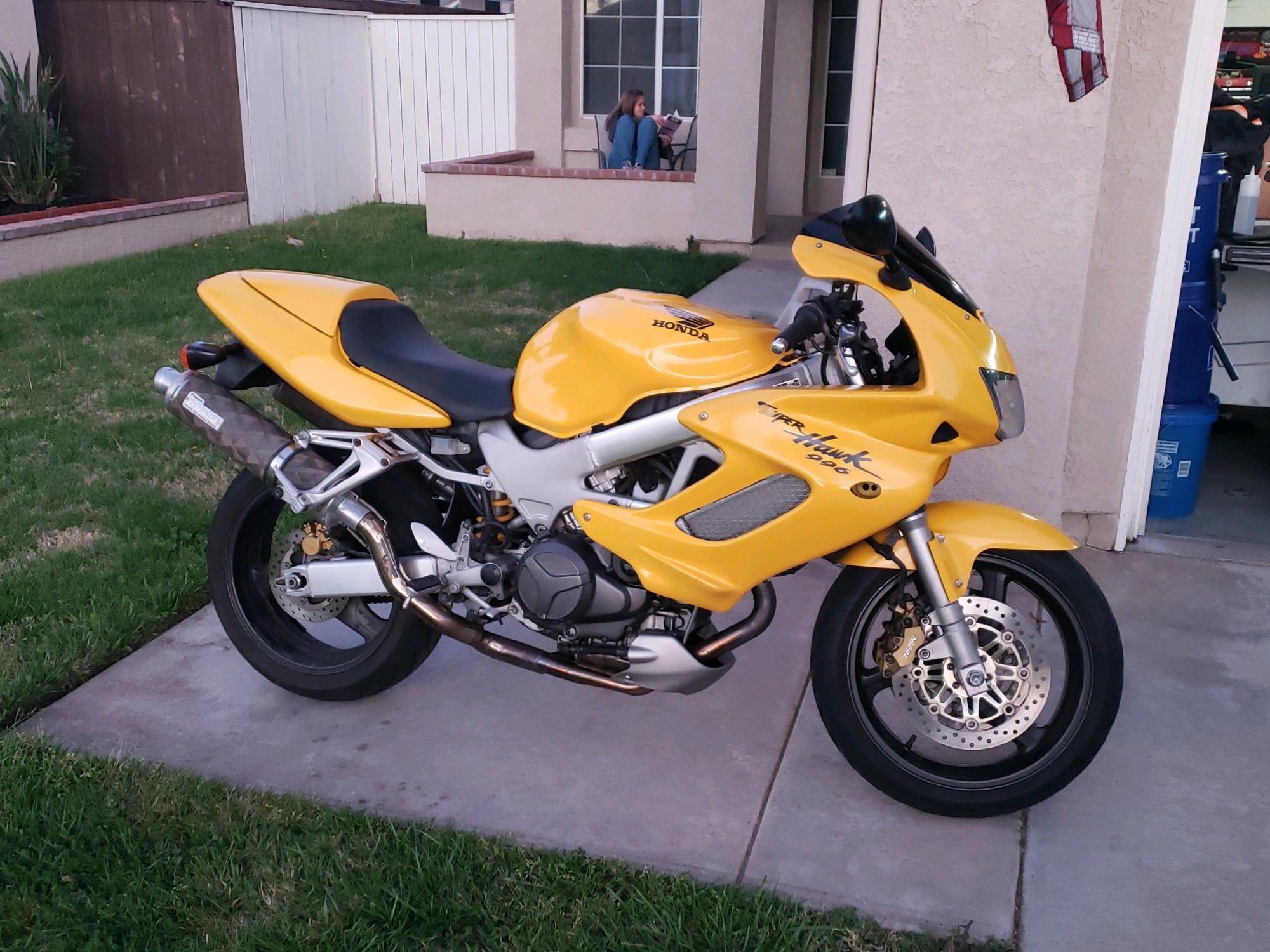

Hi everybody,
just picked up a 2000 Superhawk.42,000 mi. I had to replace the R/R with 07 R1 unit, installed Krieger Mcct's, rebuilt petcock, did TPS mod, was 800 ohms, reset to 510 ohms. Did oil/filter change. It looks like its had the pair removed, it has block off plates on valve covers, but nothing capped in airbox. Has full 2 brothers exhaust, k&n filter, factory pro jet kit. Id like to delete the rest of the emissions, not sure what to cap, what to remove. Not sure how to set up vacuum tees for balancing. Im waiting on float bowl gaskets to do carb clean/sync.
Anyone in So Cal that wouldnt mind giving some pointers?
The forums have been great! So much info to search through.
Marc
also broke plastic choke fittings. Have some brass ones coming from Jack Flash.

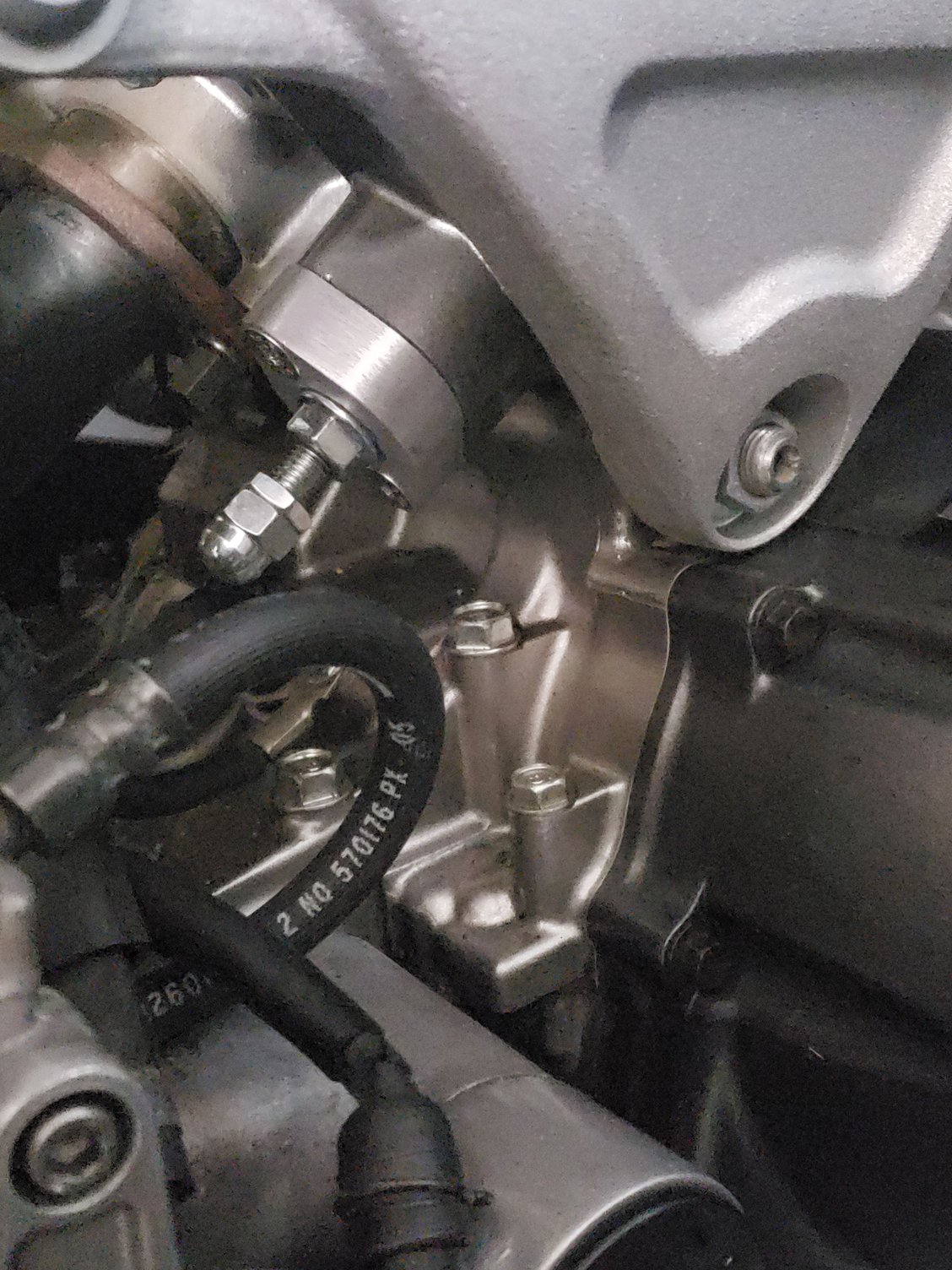

I found a pretty decent write up on emission removal. Im just not sure about the long nipple on the bottom of the front carb. Does anyone know if this gets capped, or is open. I dont recall if it was connected before.

Off the top of my head it's a spigot for carb hot water heating. Check the shop manual fuel and cooling sections. What year and is yours a CA model? Is there a nose connected to each carb and one between them otherwise still?
I just had in my hands 2 sets of carbs lat night but may can look today...that's the front carb.

Its a Ca model. I removed the emissions equipment, capped 3 carb ports, changed the front mixture screw from 3.5 to 2.5 turns, put it back together, and i'll be dipped! She runs nearly perfect!!
