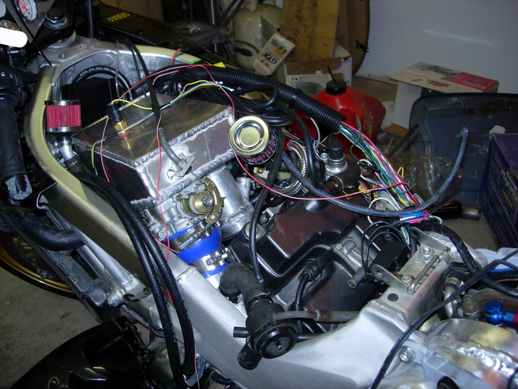

It's going to the airbox to recover oil vapors, otherwise trough a breather it let the blowby gases out and let the underside of the piston breathe, both pistons go down almost at once, it displace a heck of a lot of air, remove the oil cap while idling you can feel a lot of air going in and out. An I4 for example displace almost nothing because 1-4 are opposed to 2-3 so the air just move under the next cylinder and is not forced out like a twin.
It's one of the V-twin fuel inefficiency factor.
Vacuum PCV is the best, but on the SH it's plain atmospheric pressure.
As for gains, very little, very very little, unless you forgot those rings on the counter, then it may helps
Oh and yes I have seen breathers somewhere, it stinks oil vapors
