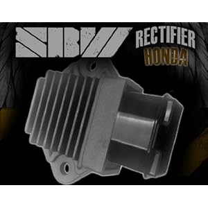

Originally Posted by festertruck
R/r is the regulator/rectifier. Fairly easy replacement. I just did mine no problem. Search "mosfet how and why" on here for excellent detailed discussions. Stock one is prone to failure and can trash your electrical system when it goes. If you do it yourself youll end up spending 150ish for all new parts, less for used. I went with new for peace of mind.
Cool, thanks for the info.
In my Googling I saw the mod where you take a cooling fan for a PC and bolt it on top of the R/R.
The one I'm looking at is a 2002, I read that they changed the design in the post 1999 models?
Old May 11, 2012 | 10:26 AM
Not many people do that. It's a pretty dirty fix... read the R/R thread if you have time, then replace it with a MOSFET unit and there's no need for a fan.
Old May 11, 2012 | 10:46 AM
RarestRX's Avatar
Joined: May 2012
Posts: 4
RarestRX is on a distinguished road
Yep, just went through it.
Found this on Amazon:
Amazon.com: Rectifier Regulator Honda Vtr1000f Superhawk Vtr1000 VTR 1000 Super Hawk: Automotive
Might do the plug-n-play vs. cutting up my new (to me) bike's wiring harness.
