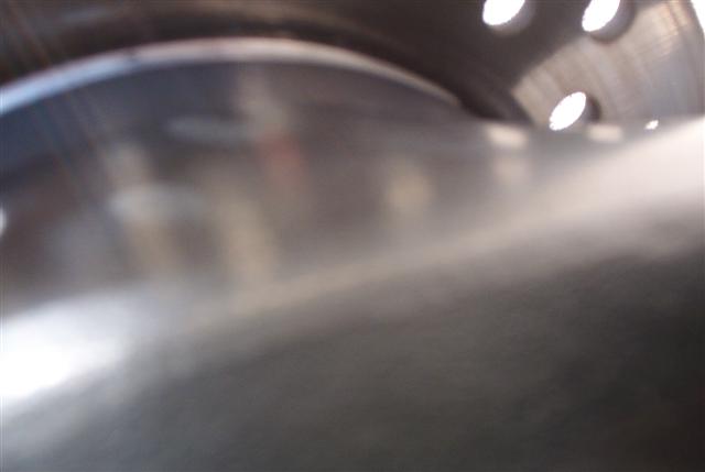

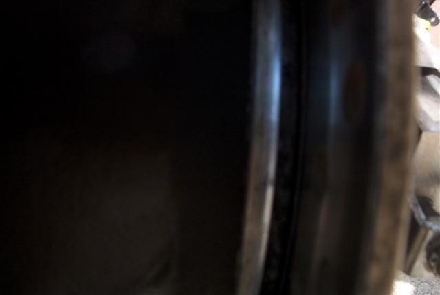

So I changed out my rear wheel/tire today. I noticed someone had totally buggered the axle adjustment bolts. Completely rounded off. If you dont have metric tools stay the hell away from the bike until you get some. The axle nut too , was alittle rounded, and really really tight. The topper was when I had it all back together and was wiping down the chain and rear wheel after lubing, I saw a shiny stripe on the wheel right against the brake disc. What the heck is that, I thought. It was the inner most brake pad. SOme MORON didnt get the front of the brake pad seated into the front of the caliper so it was rubbing/cutting into the wheel. There is about an 1/8" -3/16" grove cut into the wheel. Please check the details when you are working on bikes. Sheesh. g
