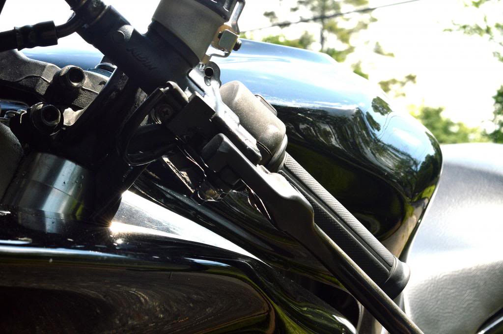

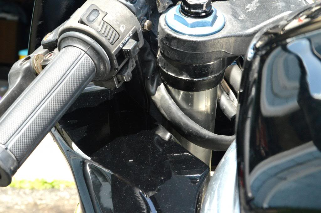

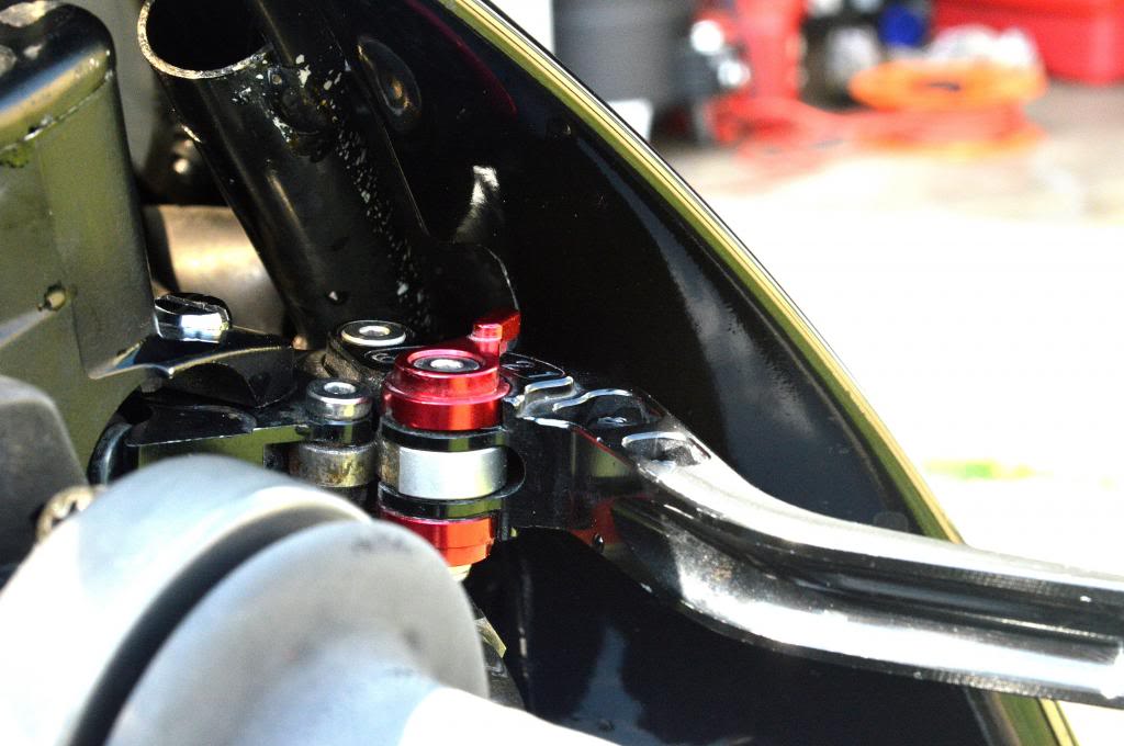

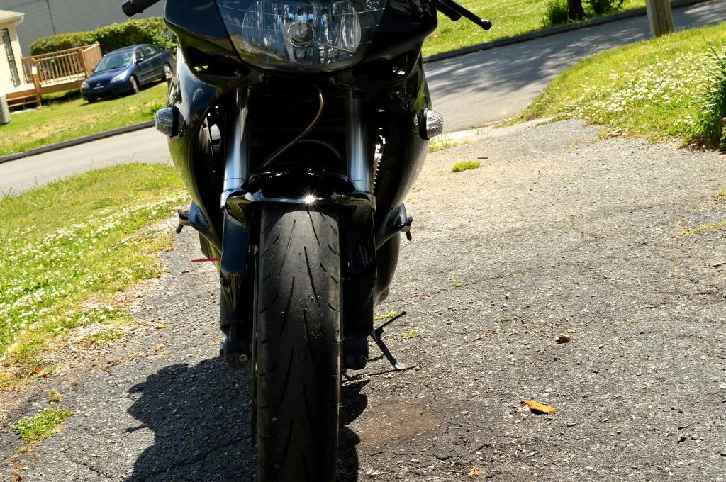

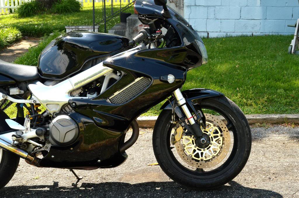

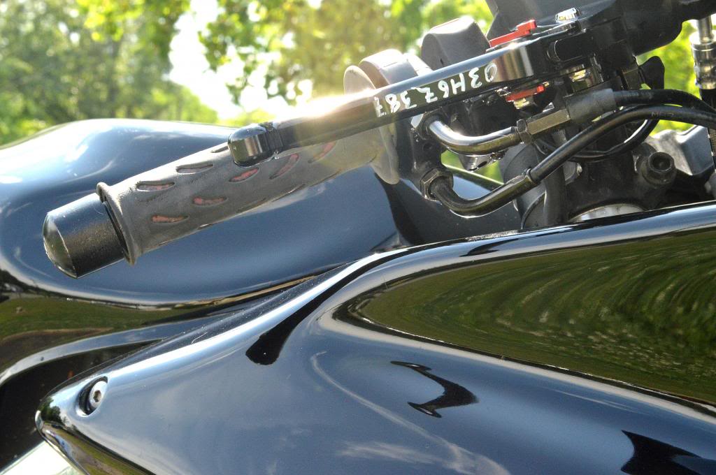

and bike is back home for cleanup. I took some close up photos so you could see what kind of clearance you have with the CBR929 clip-ons installed. They fit with no clearance issues except for the brake lever would hit the inner fairing at full left hand lock. It doesn't really bother me and the only time it would hit is in a parking lot turning around, but we went ahead and notched the inner fairing so there would be no issues. You have to be patient and get your lever position, brake line clearance and throttle cables properly adjusted.
The clip-ons do fit under the gull winged triples if you feel like taking the time to make them fit if anyone wants to update the KB. The extra hour it took to get everything aligned was well worth the $300 I saved by going other routes.
Thanks to those of you that took time to answer my questions.
Front end, wheel and brakes are all from a 2000 929, front fender is a track fender for a 1000R. Front M/C is from a 2003 600RR.
Side View
Full left lock from above
Full left lock from below
Front
Full right lock from below
Notch for brake lever clearance at full left lock
