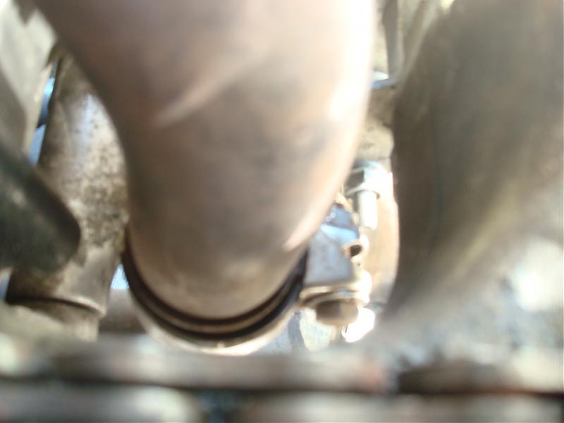

Old Nov 20, 2008 | 12:17 PM
chevy's Avatar
Posts: 109
From: Georgia
chevy is on a distinguished road

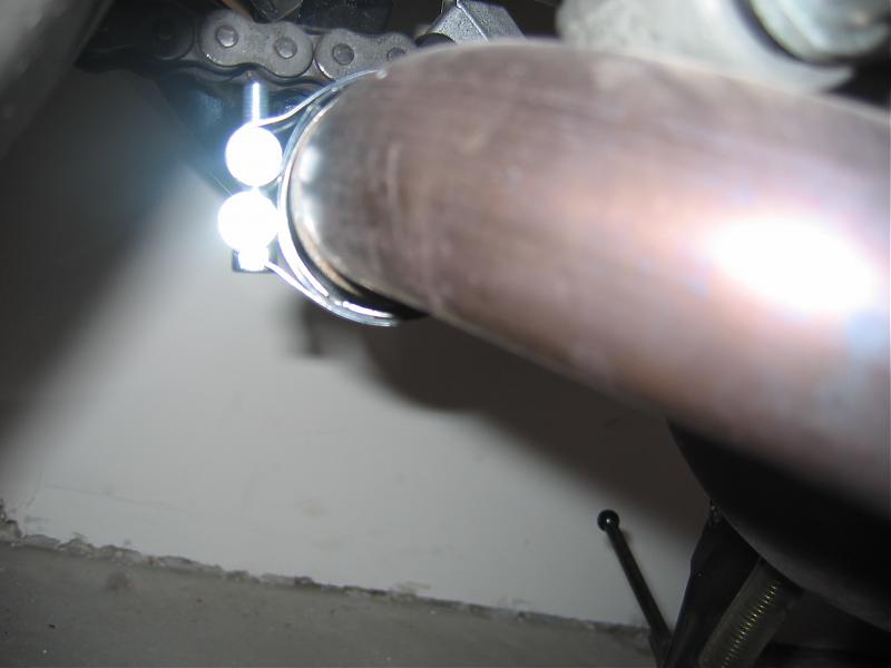

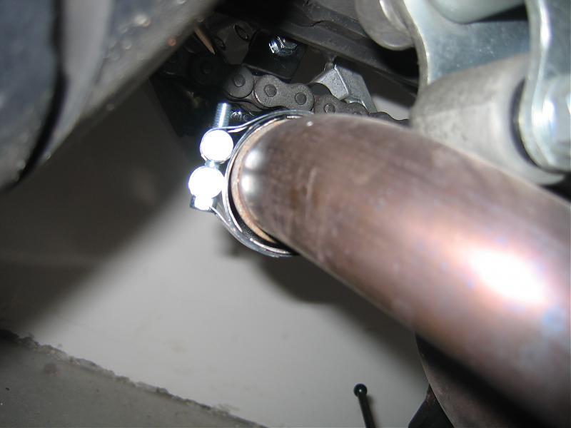

Pics of my problem
this may help., i tried to tighten but i found out it seems to be stripped because it will not tighten, so i tried to unscrew it will, but will not clamp tight, this is where i feel the unwanted air.
however, like a few post up......is there a sleeve or a flat gasket that is needed in there.
2nd
Is it worth going to the shop for, i can take clamp off, then i guess pull apart exhaust replace sleeve and clamp.
Break it down for me Guy's
Old Nov 21, 2008 | 12:21 PM

Old Nov 21, 2008 | 12:34 PM
Wicky's Avatar
Posts: 1,707
From: Essex, UK
Try replacing the clamp with a Stainless Steel SS Mikalor Supra W4 (Pro) clamp or sumfink similar.
Only a $10 part (not inc. skinned knuckles!)
Probably no sleeve/seal, if as you say you have an aftermarket system, as the sleeve is in the OE collector at that particular junction. (see the illustration I posted earlier)

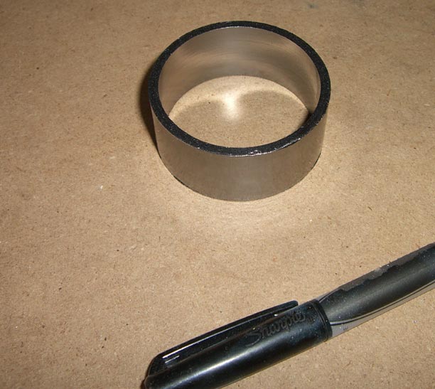

Here is a stock gasket I have sitting around. 1 7/8" OD, 3/32" wall thickness, 13/16" high.

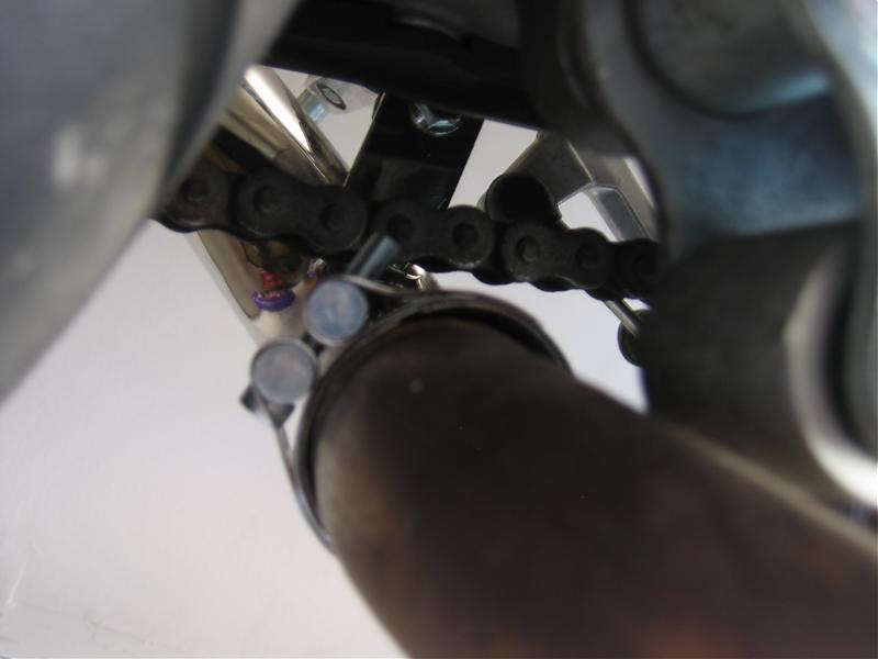

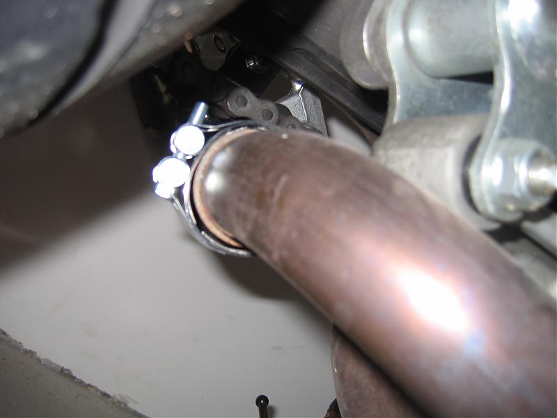

Old Nov 21, 2008 | 03:45 PM
Black Hawk's Avatar
Joined: Aug 2008
Posts: 23
From: Michigan
Black Hawk is on a distinguished road
Try the stock gasket and then get a better clamp that is a little smaller. This will work I had the same problem with my Two Bros Exhausts slip ons.

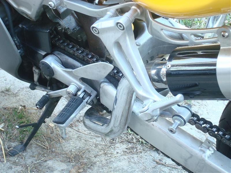

Attached Thumbnails Exhaust Leak-img_3894.jpg   Exhaust Leak-img_3895.jpg   Exhaust Leak-img_3896.jpg   Exhaust Leak-img_3897.jpg

That sounds like what I had. My #6 gasket on the header was totally gone when I disassembled the bike. They apparently have a habit of falling apart and blowing out.

IIRC 51-55mm, as I can now see from Chevy's pic he has the standard OE clamp, and so with a different connector pipe (probably without a seal) it can't close up the bore enough to make an effective seal.
The Mikalor clamps are good as you don't need to disassemble the pipes to fit

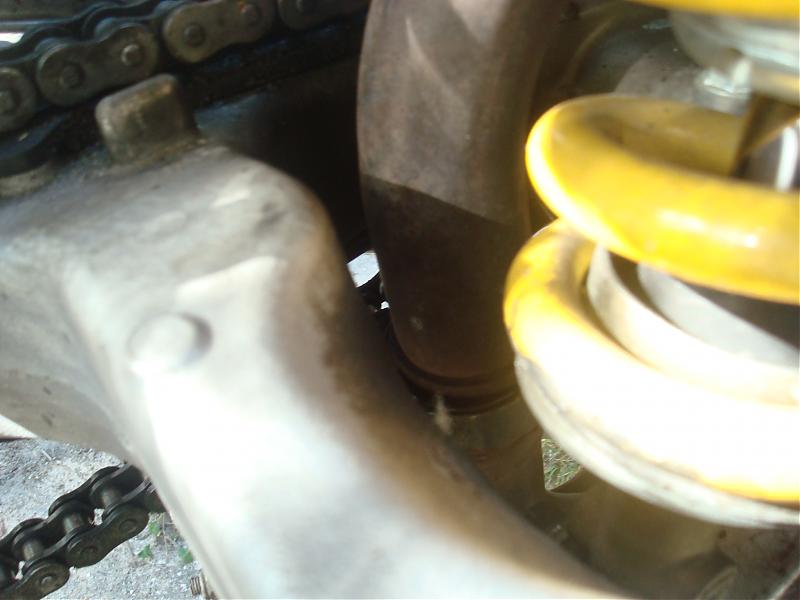

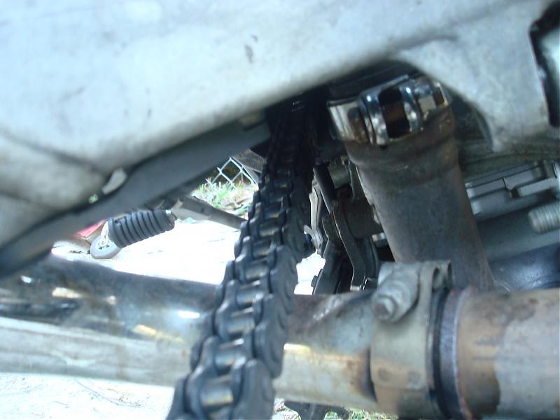

Better View
here's a few more pics:
Wiley....thanks for the insight!
I just called the local dealer and he has never heard of miklar clamps, he stated that they had a cobra brand.10.95 and would have to order, he said for seal it would be 10.95.
is it better to go with the aftermarket.....it seems to be top choice for any replacement as i see on the forum
anyway i just looked at where the clamp and seal are, i noticed that halfway around there is a tight seal and the other half you can cleary see that there is a gap...........it appears to have either lost some metal or pipe is not in correctly...............if i was to take clamp off would i be able to take piping a loose or would i have to dissconnect bolts from where it bolts to motor?
