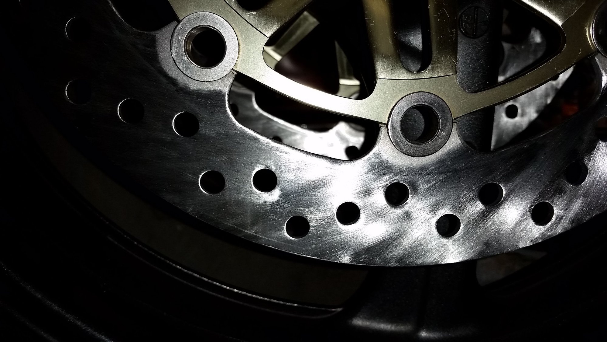

These used ones up in Beertown look pretty good. I think the brake pad rust stains will work out. I prefer to bead blast rotors first, then hit them lightly with a ball hone.
Then, after 110,000 miles, I went to the EBC Contours which then were relatively inexpensive.
Rear rotors are pretty inexpensive.
I either run EBC HH+ pads, or Vesrah RJL
https://www.nationaltoolwarehouse.co...kZAwZ_t0cFQ91d
Then a thorough rinse with 91% isopropyl alcohol and a red Scotchbrite pad...

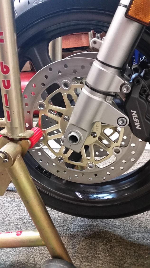

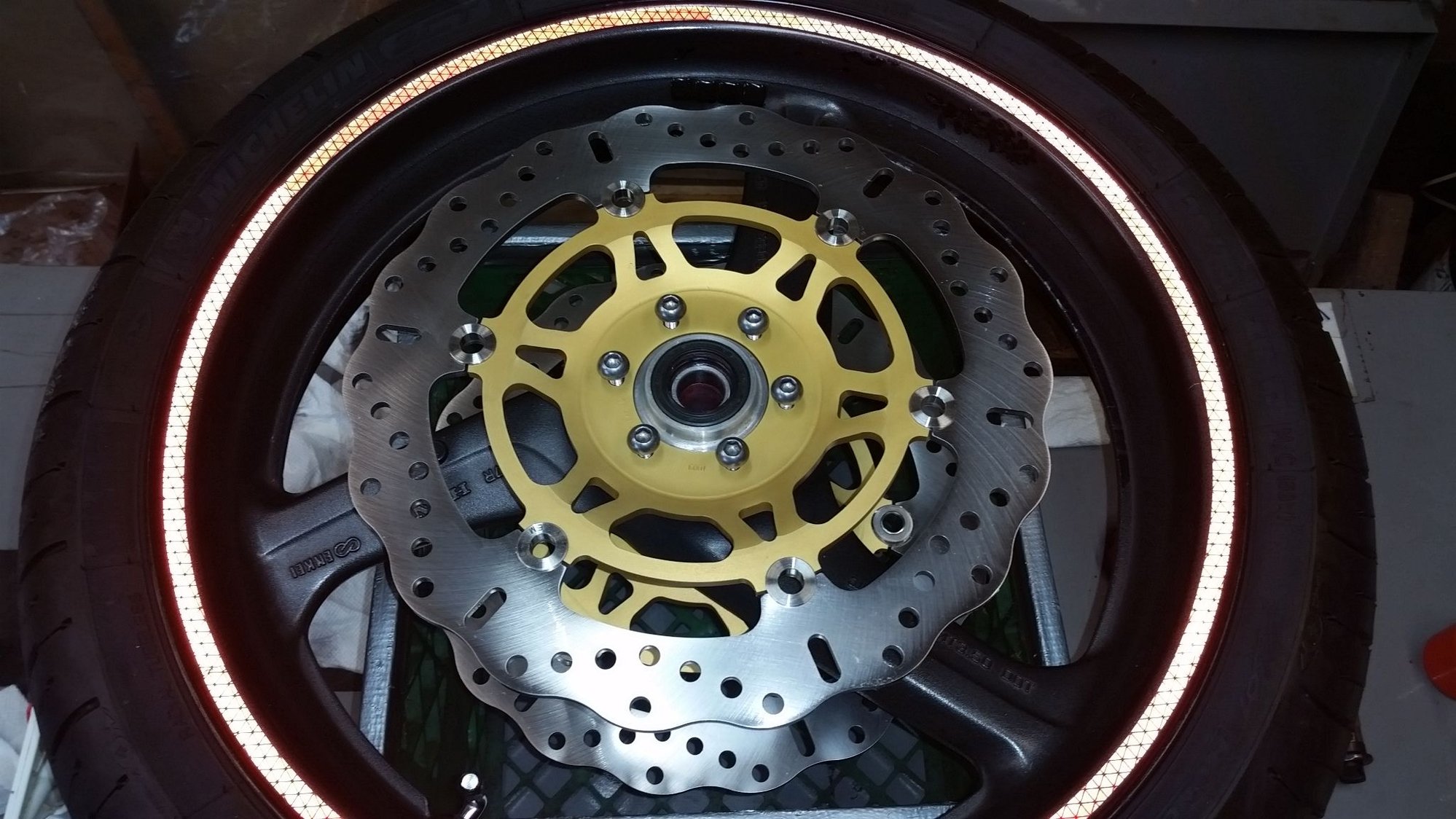

Hey Bret you think they are used? I have used the ebc on the track back in the day and didnt really like them. I found the galfer waves to be stronger but yeah I guess more pricey.
It looks like the galfers are about$515 like I said. Good to see someone else is using a ball hone.
I recently got new RJL pads which are double the cost of the HH ones. They are way stronger but to bed them in I scotch wheeled the rotors down to bare metal then did the ball hone for cross hatch patern.

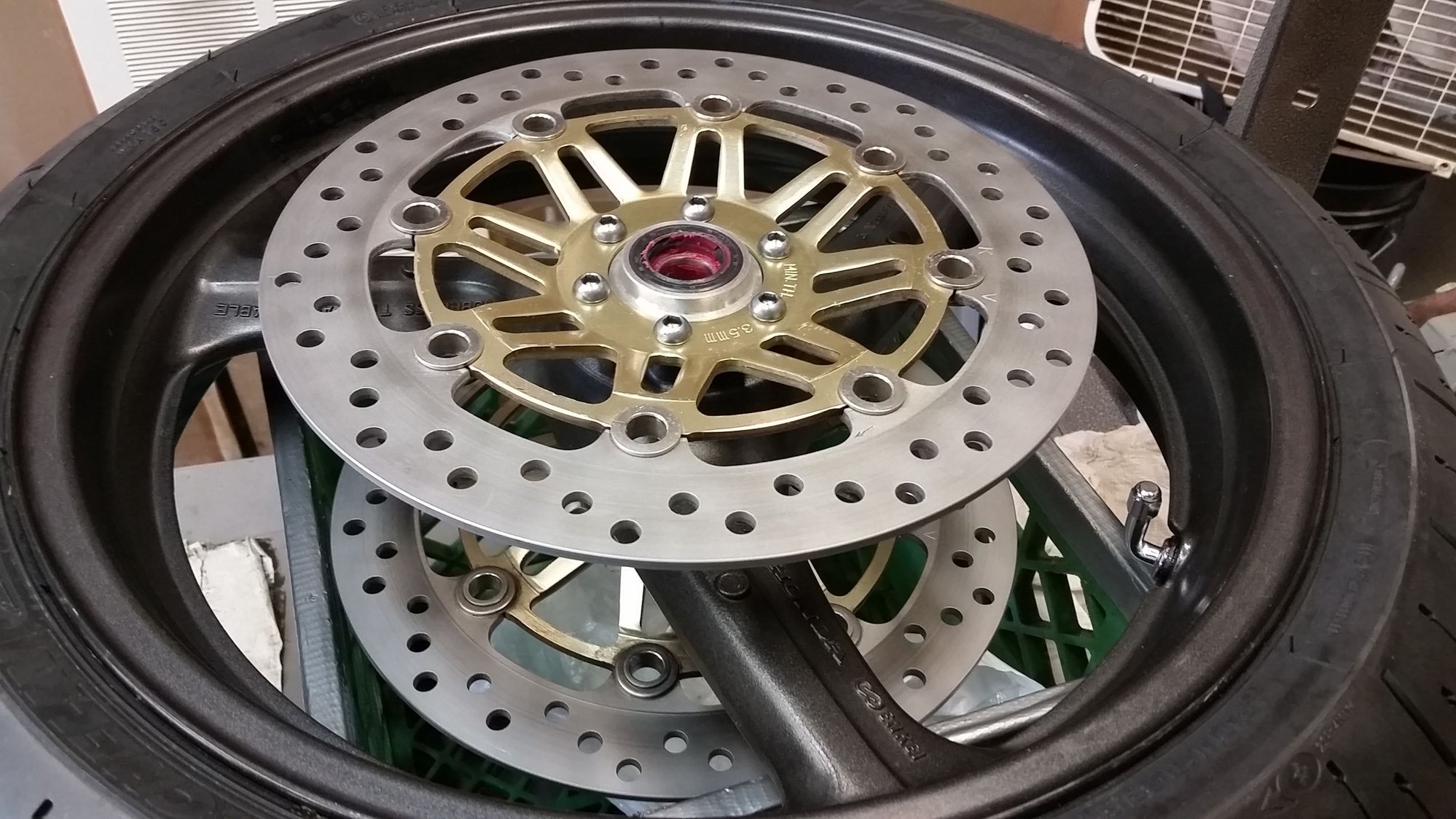

I actually have 2 spare sets of VTR rotors since both my bikes have CBR front ends.
